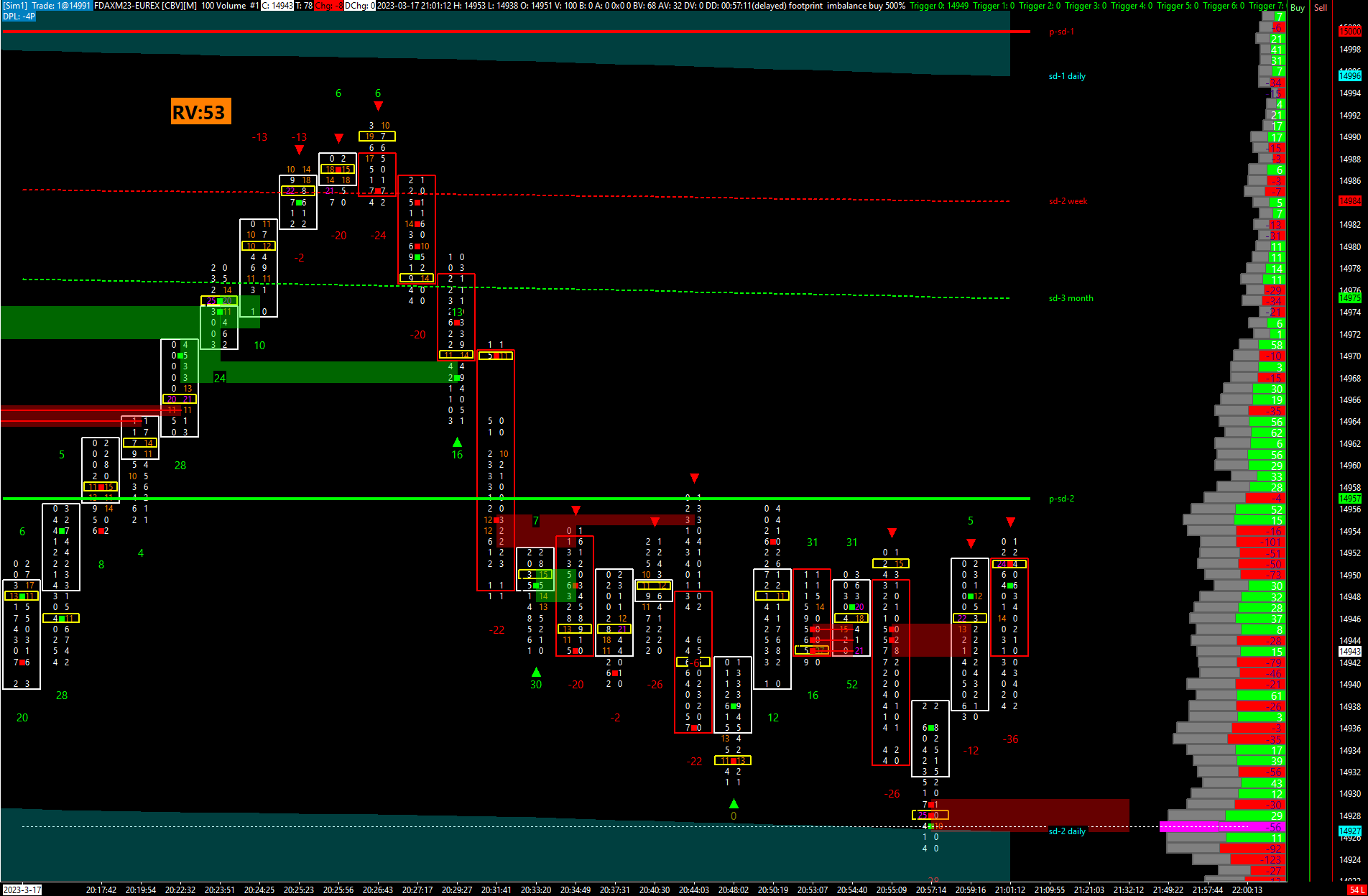

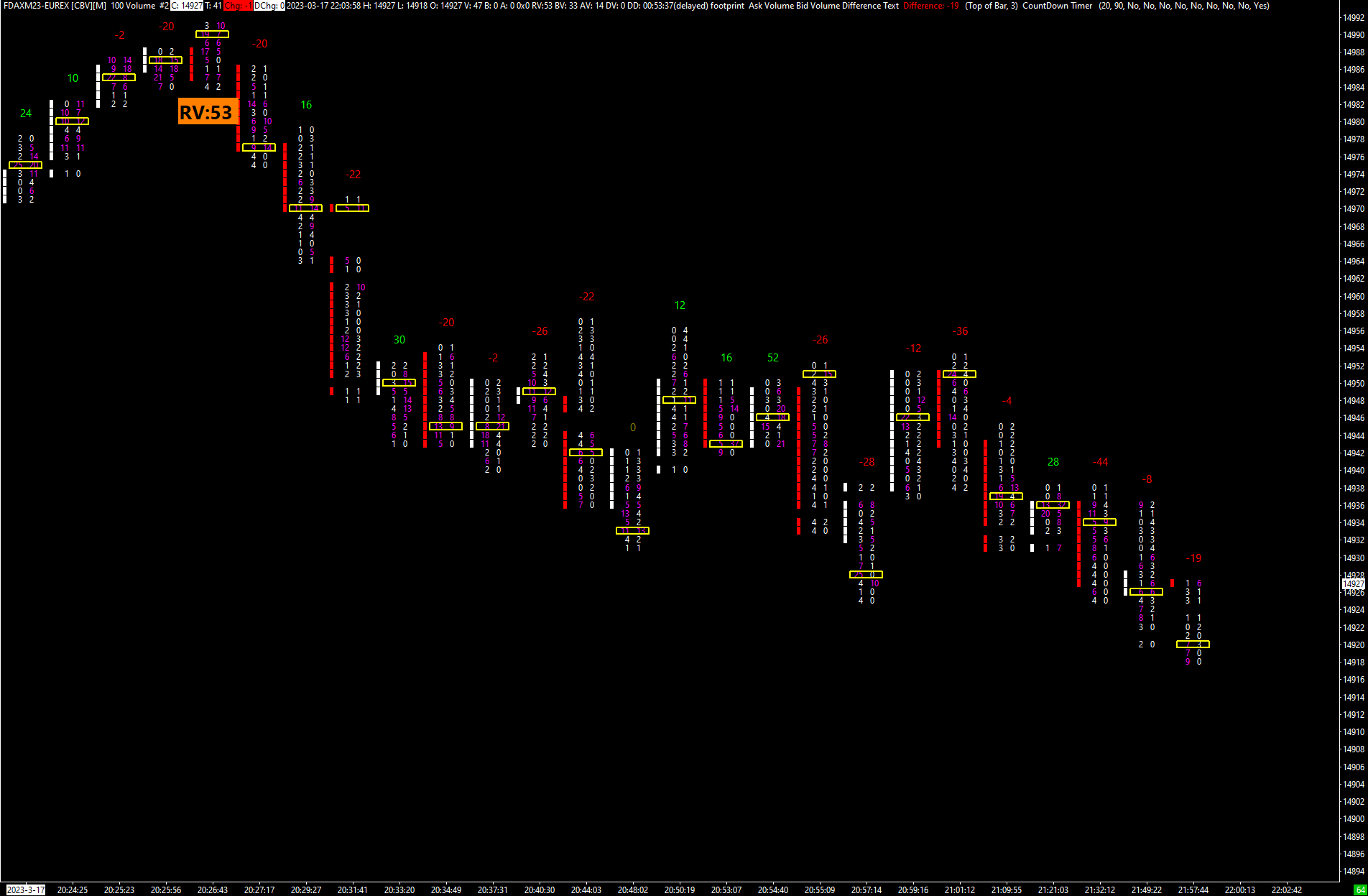

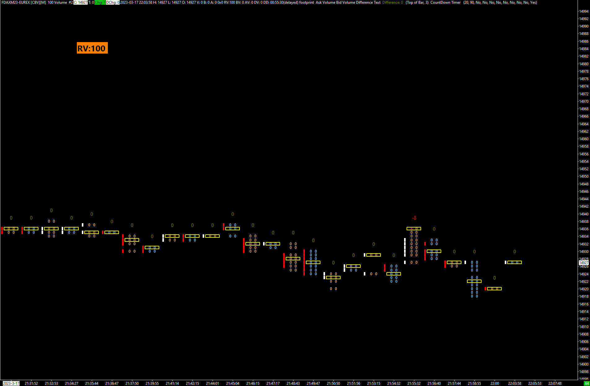

ok, voila mon graphique#2 quand je n'utilise pas le filtre exclude <=4 https://www.sierrachart.com/image.php?Image=1679127285822.png j'ai fait un lien avec un study price overlay pour avoir les mêmes infos sur mon graphique#1 https://www.sierrachart.com/image.php?Image=167912705139.png dans ce cas ça marche très bien. maintenant voila ce que donne mon graphique#2 quand j'active le filtre exclude <=4 https://www.sierrachart.com/image.php?Image=1679127397263.png et voila ce que ça donne sur mon graphique#1 https://www.sierrachart.com/image.php?Image=167912749857.png Ce filtre me sert à voir uniquement les ordres supérieur à 5 contrats passés en 1 seule fois, ils apparaissent en haut des barres. Quand je mets mes 2 graphiques en tick reversal, en 1mn ça marche très bien. Quand je mets en bougies 100 vol, ça ne marche plus, alors que ça fonctionnait très bien il y a quelques temps |

https://www.sierrachart.com/image.php?Image=1679127285822.png I made a link with a study price overlay to have the same information on my graph #1 https://www.sierrachart.com/image.php?Image=167912705139.png in this case it works very well. now here is what my graph#2 gives when I activate the filter exclude <=4 https://www.sierrachart.com/image.php?Image=1679127397263.png and here is what it looks like on my graph#1 https://www.sierrachart.com/image.php?Image=167912749857.png This filter is used to see only orders greater than 5 contracts placed in one go, they appear at the top of the bars. When I put my 2 graphs in tick reversal, in 1 minute it works very well. When I put in candles 100 vol, it does not work anymore, whereas it worked very well some time ago We are very confused as to what exactly you are doing - as you can not use the Study/Price Overlay to overlay the Numbers Bars study. So we are not sure what the relation is between Chart #2 and Chart #1. But, the one thing we can say is that when you filter out trades that are less than or equal to 4 (<=4) then we are not surprised that you are seeing zeros for all the entries. Keep in mind that the Numbers Bars shows the total volume traded at a particular price point. Therefore when you see a value of 5, it does not mean there was a single trade with a quantity of 5, it means that all the trades at the price and time added up to a total of 5. Most likely is that there were 5 trades of 1 each. If you are wanting to see specific large trades, then we recommend using the Large Volume Trade Indicator instead of filtering the Numbers Bars. Refer to the following: Large Volume Trade Indicator For the most reliable, advanced, and zero cost futures order routing, use the Teton service: Sierra Chart Teton Futures Order Routing |

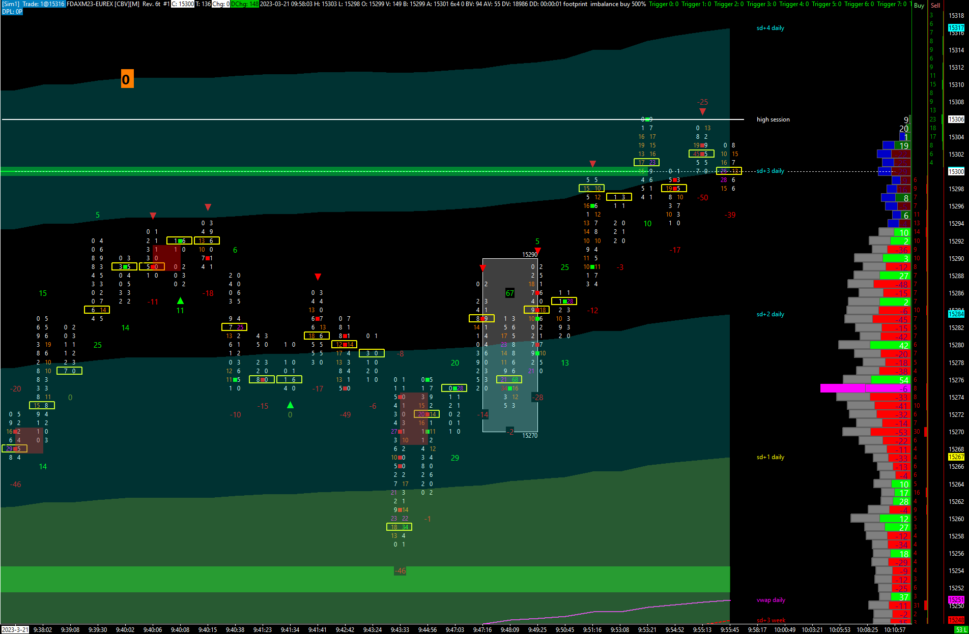

oui je sais que sur le graphique#2 il y a des 0 partout, d'ailleurs je ne le regarde pas. Ce graphique me sert à uniquement à faire apparaitre le nombre de contrats que mets un seul opérateur quand c'est supérieur ou égal à 5 https://www.sierrachart.com/image.php?Image=1679325950306.png le -10 et le -13 entourés signifient qu'un opérateur à posé 10 contrats à la vente en 1 fois, et pareil pour le -13. Ensuite je reporte ce numéro sur mon graphique#1 avec l'étude "study price overlay", et normalement cela doit apparaitre sur mon graph# comme sur mon graph#2 ça marche très bien quand je suis en tick reversal, mais en barres de volumes ça ne marche plus, les chiffres apparaissent n'importe ou |

j'ai dupliqué le graphique#1, et activé "exclude<=4" sur le graphique#2 regardez le graphique#2 en tick reversal https://www.sierrachart.com/image.php?Image=1679388937990.png dans la barre j'ai un gros opérateur qui a mis 67 lots en 1 fois, l'information apparait en haut de la barre, et dans la barre j'ai le détail 57 lots dans le poc et 15 lots juste en dessous regardez dans le graphique#1 aussi en tick reversal https://www.sierrachart.com/image.php?Image=1679389085699.png les 67 lots se sont bien reportés dans la même barre, j'ai donc la même info il n'y a que quand je mets les barres en volumes que ça ne marche pas |
