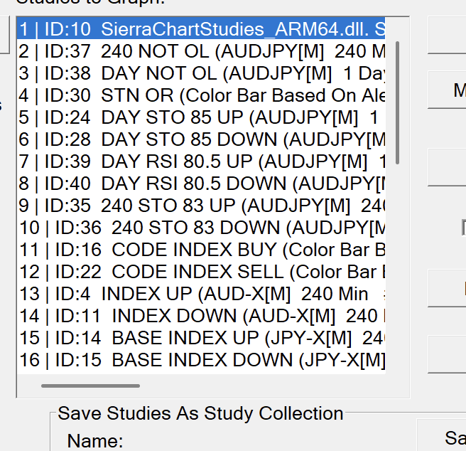

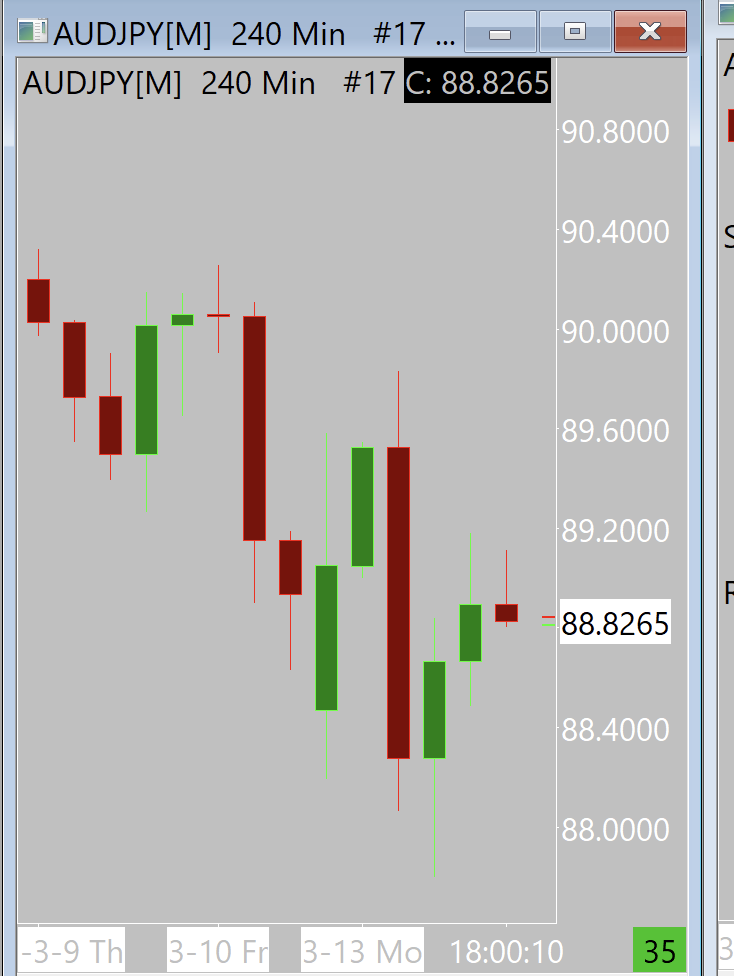

So I downloaded a new download but none of the studies are present? All the code and studies are present on the back end but you dont see any lines on any of the charts ??
imageScreen Shot 2023-03-13 at 2.55.50 PM.png / V - Attached On 2023-03-13 20:57:45 UTC - Size: 91.41 KB - 226 views
imageScreen Shot 2023-03-13 at 2.55.40 PM.png / V - Attached On 2023-03-13 20:58:09 UTC - Size: 96.73 KB - 226 views

Actually got it to work! I have two downloads. One that says arm...for the m1 chip that one does not work but the one that says 64 bit does! Thanks!!
