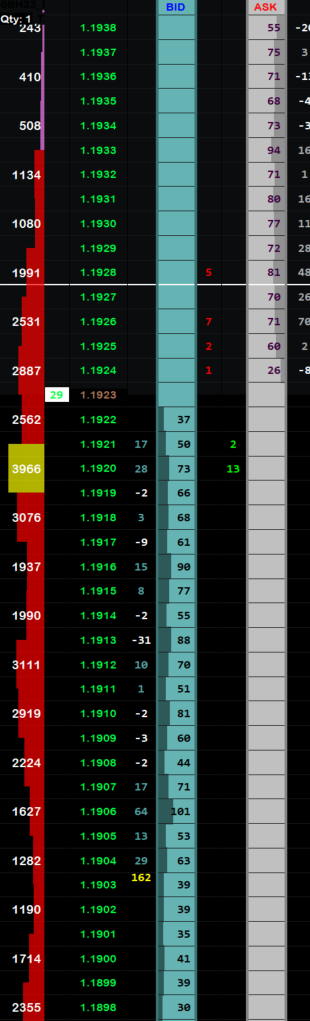

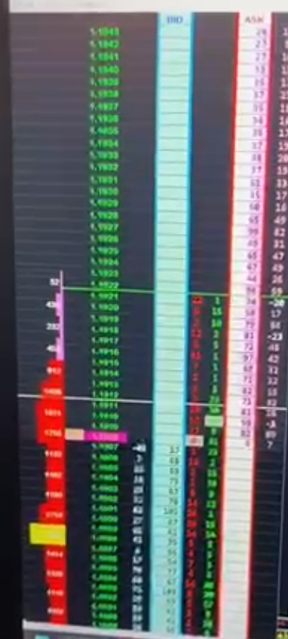

It's 6BH(gbpusd) on CME futures . The interval is set to 500 milliseconds . A trader i know is using the same chart but has regular updates and the market order sells and buys show on the charts and dont disappear
[2023-03-09 19:09:59]
Bilal15 - Posts: 8
attaching the pics so you could see the difference
imageScreenshot 2023-03-09 190731.png / V - Attached On 2023-03-09 19:09:08 UTC - Size: 482.37 KB - 223 views
imageScreenshot 2023-03-09 190742.png / V - Attached On 2023-03-09 19:09:16 UTC - Size: 94.46 KB - 242 views

[2023-03-10 20:01:14]
We see the same separation of Bid and Ask with the 6BH23 contract. But the current front contract is the M contract, which is probably why the H contract is having these kind of separations. Change to the M contract and see if you continue to have the same issue.
You might also want to change the Chart Update Interval to 300, so you see more updates.
