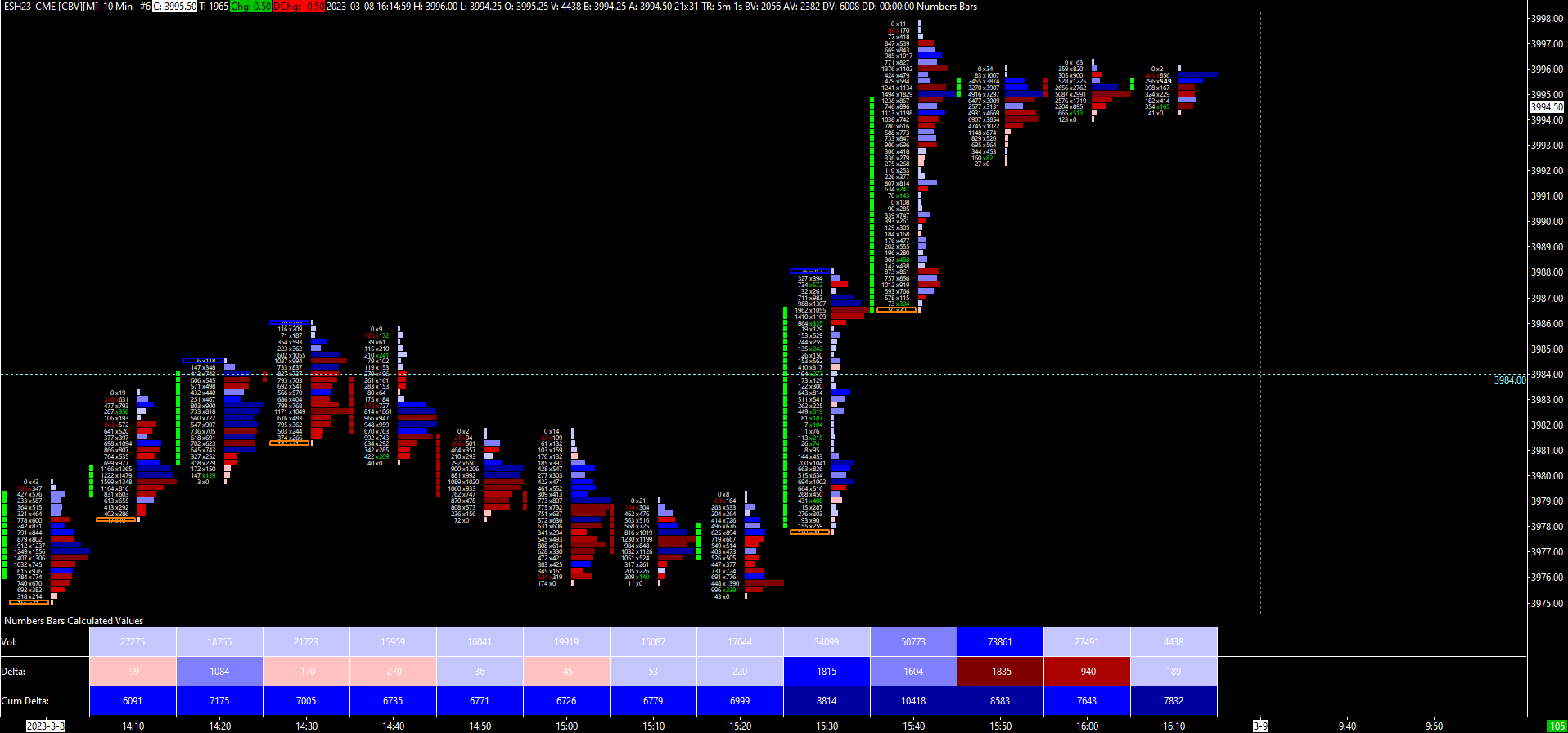

Hi John, thank you for your reply. here are the screenshot of the blank chart after setting tick size to 1.0
https://www.sierrachart.com/image.php?Image=1678319627379.png
https://www.sierrachart.com/image.php?Image=167831942148.png
