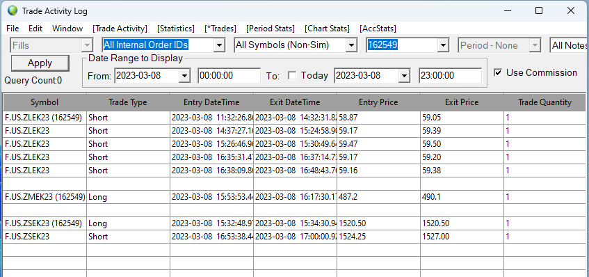

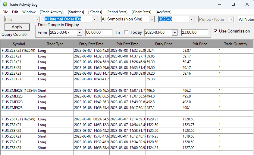

I don't know if my screenshot attached will arrive to you, but if you have the possibility to compare my trade activity log of the day 03-07 (that match perfectly the trades I took) with that one of the day 03-08 (totally wrong) you can see in this second day that all my trades have been reverted (short/long)... that is beacause the result is a final loss of 255$ and not a gain instead. Please check.

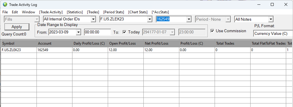

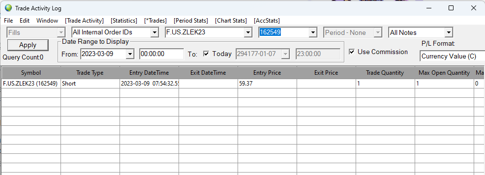

Thi is not the problem. I've already checked this settings and everything is fine. Please look my screenshot. I have just closed a trade right now. I entered yesterday at 59.38 on ZLEK and closed now at 59.37 with a loss of 6$. Well, as you can see from the first image the trade is not closed at all but it's running and further more with a profit/loss in opposite to my trade entry. It's totally crazy. And this keep going until I open another trade that it will be not an entry of another trade but the exit of this one that is running that I've already closed instead! Please check my second screenshot: it shows an entry price at 59.37, but this should be the exit of the previous one! Pleas check and tell me what it's wrong. I'm going crazy. Thank you.

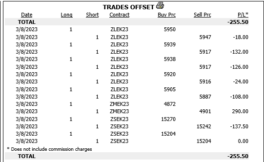

I'm sorry but check also this Trades Offset image. It shows a total loss of 255.50$. ZMEK and ZSEK positions are correct, but about ZLEK is totally uncorrect! Never took that positions on that symbol. My entries/exits are totally mixed up, like reverted, leading that kind of losses I've never taken, as it was showing on the trade window of the platform. Please check.
