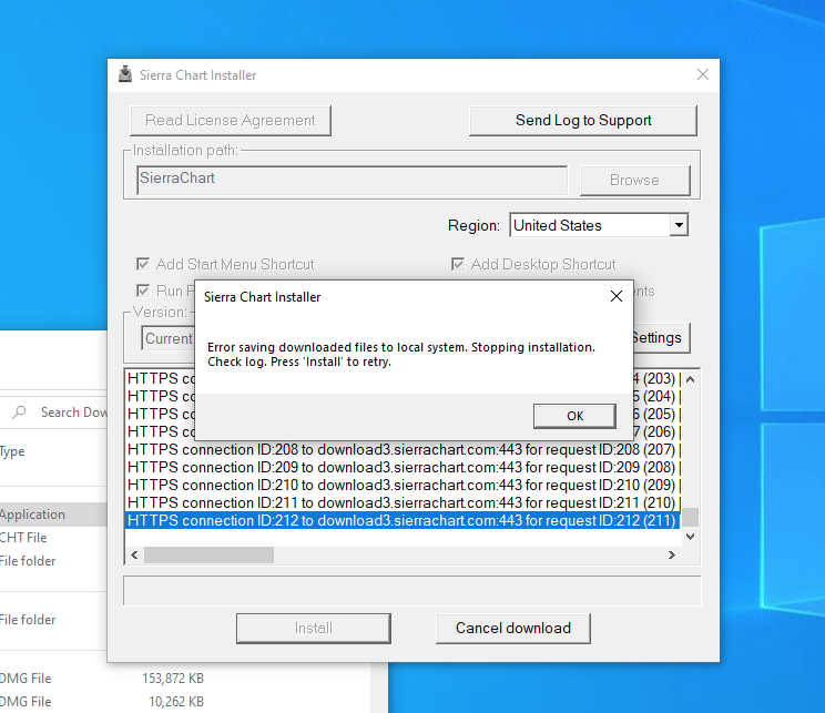

Hi
Please help when installing the chart it kept failing
I have sent log to support
Thank you
imageScreen Shot 2023-03-01 at 9.10.14 am.png / V - Attached On 2023-02-28 22:15:12 UTC - Size: 145.63 KB - 323 views
[2023-02-28 23:31:20]
Your installation log shows the following:
Failed to create folder: SierraChart\DownloadedInstallationFiles\ACS_Source\. Windows error code 3: The system cannot find the path specified.
Are you trying to install Sierra Chart on a MAC, or Linux? If so, keep in mind that Sierra Chart is only setup to work with Windows. Others have had success at installing Sierra Chart on emulators for MAC and Linux, for which there are a few posts in this Support Board.
Otherwise, you should be able to get the Zip installer to work for you. Refer to the information here:
Software Download: Sierra Chart Zip Installer

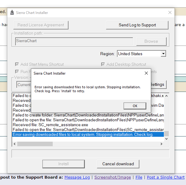

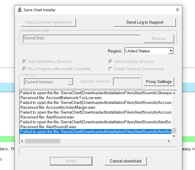

[2023-03-01 01:48:48]
User849326 - Posts: 6
It shows error saving files
imageScreen Shot 2023-03-01 at 12.46.43 pm.png / V - Attached On 2023-03-01 01:47:29 UTC - Size: 57.36 KB - 241 views
imageScreen Shot 2023-03-01 at 12.47.53 pm.png / V - Attached On 2023-03-01 01:48:06 UTC - Size: 68.25 KB - 289 views
[2023-03-01 16:18:43]
Apparently there is a difference, although we are not familiar with Parallels, so we can not say why. The only information we have is the Windows Error Message provided above.
The Zip installer should work for you however, as it does not depend on the program to create any folders - you have to do that yourself and then just unzip (or copy) the files to that location. Again, the instructions are at the following link:
There are also other users that use Parallels that check this board. We have set this as a User Discussion as you may get someone who is more familiar with the software that can help you.
