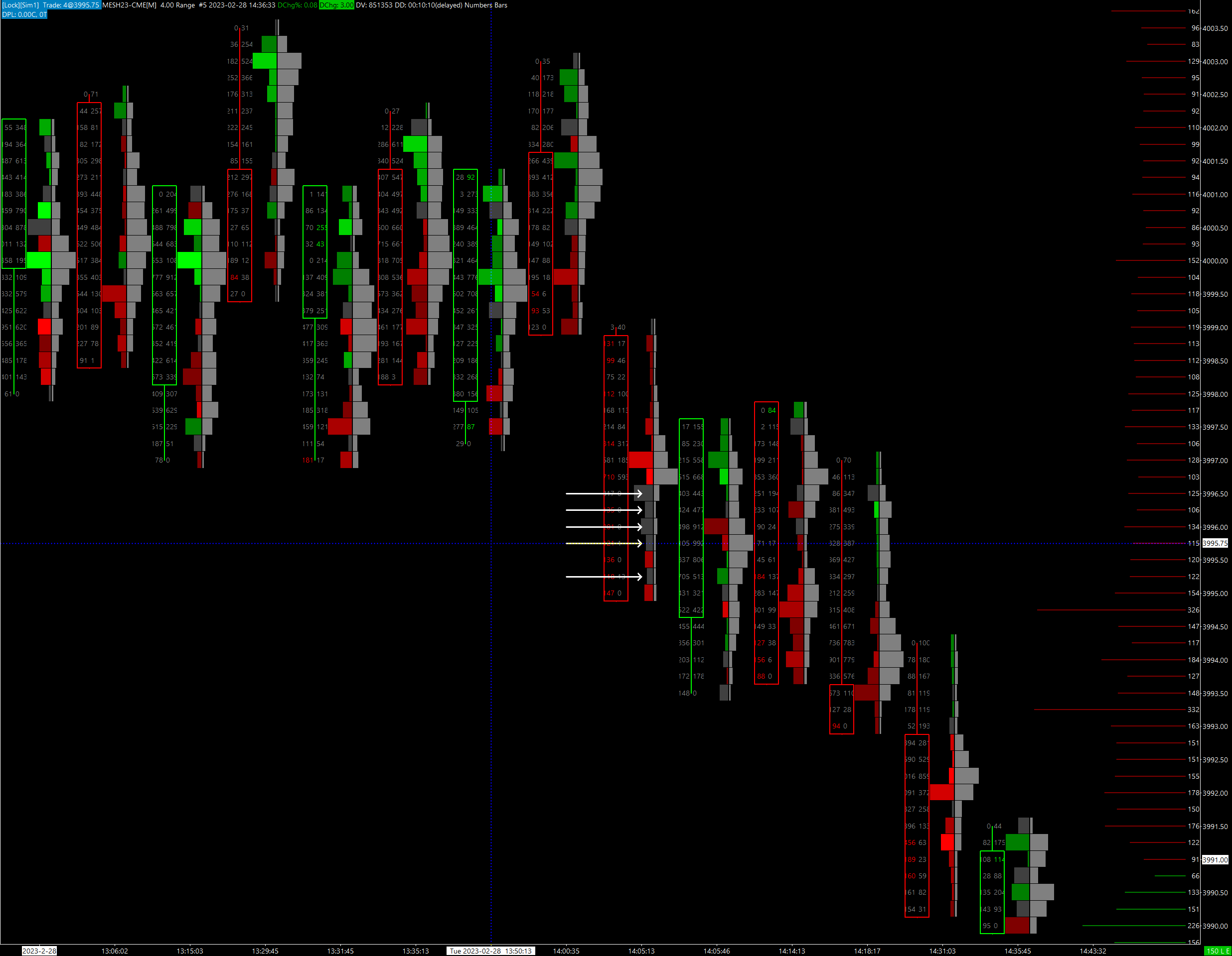

Hello
In the Numbers Bars study, I am using a column 2 Background Type as a Right Aligned Ask Bid Difference Profile with the Background Coloring Method as Based On Diagonal Dominant AskVol Bidvol Percentage. It appears the Profile is using the
Default Background Color for some of the Profile coloring.
Any suggestions you can provide to correct this is appreciated.
Thank you for your support.
Andy
https://www.sierrachart.com/image.php?Image=1677613605419.png
Private File
[2023-02-28 22:52:51]
From the documentation for that specific coloring option:
If neither the Ask or Bid side is exclusively diagonally dominant (as determined above), and the Ask and Bid sides are not both diagonally dominant (as determined above), but rather both the Bid Side and the Ask Side are non-dominant at a given price point (The Ask volume at the given price is less than the Bid volume at the previous price point, and the Bid Volume at the given price is less than or equal to the Ask Volume at the next price point) and the Numbers Bars Background Type is not set to Background on Dominant Side or Background on Dominant Side Outline, then the background is drawn using the Default Background Color.
You will find this in this section:
Numbers Bars: Background Coloring Based on Diagonal Dominant Side AskVol BidVol Percentage
