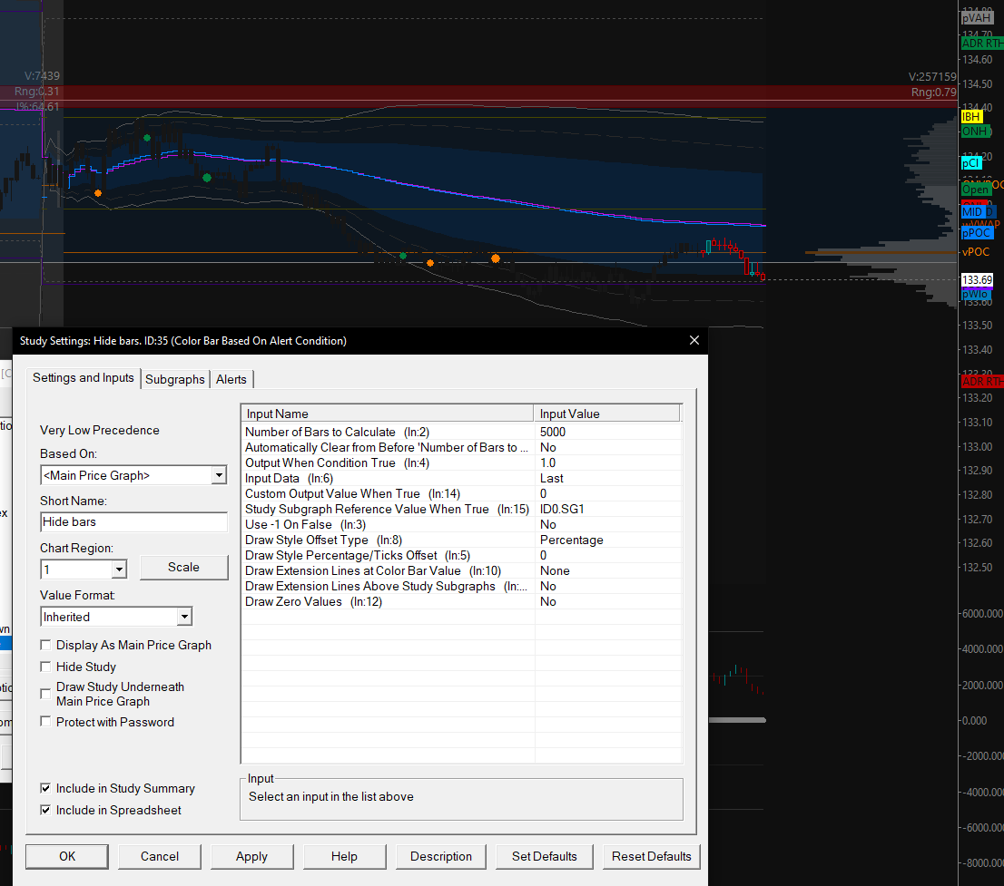

See picture attached,
I am using the hide bars indicator (because I then use heikin Ashi bars above it) and the last few bars are not hided.
What can the issue be?

Just enable the option on the Heikin-Ashi study for Display as Main Price Graph. This will then remove the display of the original bars and only show the Heikin-Ashi bars. Refer to the following:
Chart Studies: Settings and Inputs Tab >> Display As Main Price Graph
