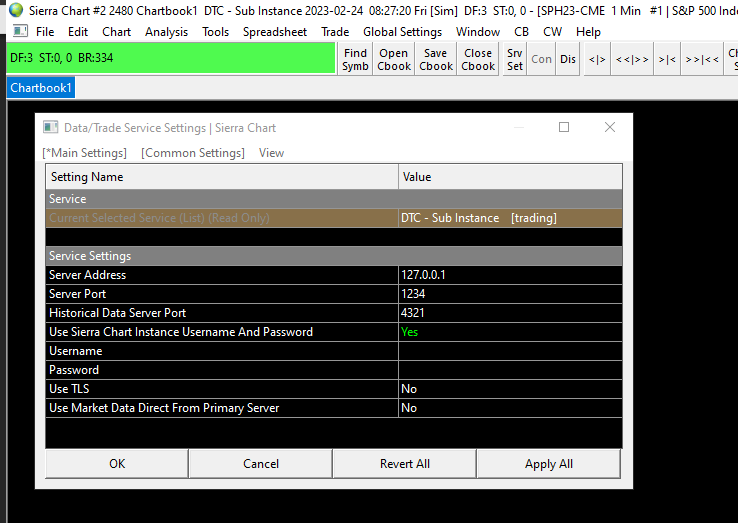

[2023-02-24 15:24:02]
eeTrader - Posts: 12
Thaks SC for your response.
The test market symbol is: SPH23-CME. I am not stuck on this one and can use another if helpful. Suggestions?
Regarding
In this installation of Sierra Chart is Global Settings >> Data/Trade Service Settings >> Current Selected Service set to DTC Service
Current setting is DTC - Sub Instance [trading]. See attached screen shot. Can't change to the value stated b/c it is read-only here. How do i change the value to DTC Service?

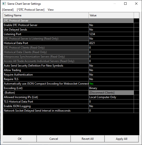

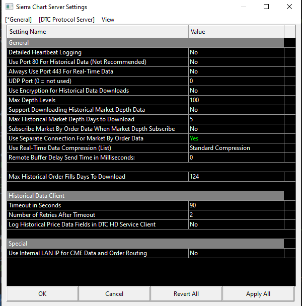

[2023-02-24 15:40:15]
Here are screenshots of:
Sierra Chart Server Settings-General
Sierra Chart Server Settings-DTC Protocol Server
if helpful.

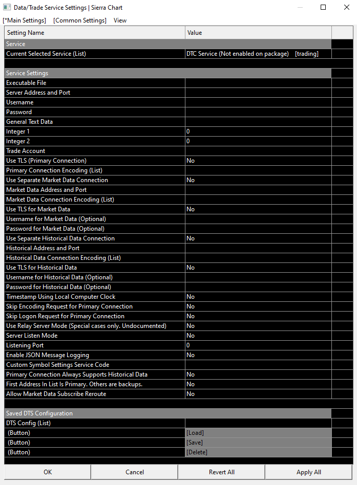

[2023-02-24 17:53:27]
Under File->Data/Trade Service Settings I was able to find the location to where it looks like one needs to set the service to: DTC Service.
Note in attached screenshot that this service is disabled.
Is it possible to enable in the trial version of the application? If so, how is this done?
Thanks.

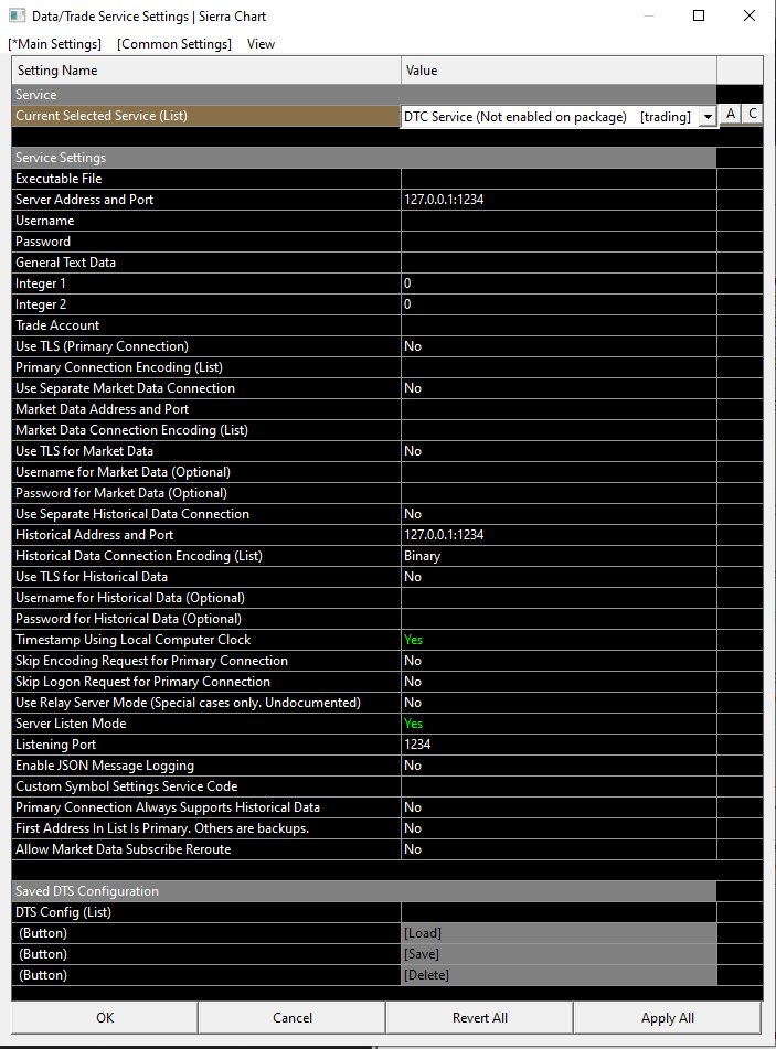

[2023-02-24 22:17:15]
Note: corrected current understanding around Global Setting->Sierra Chart Server Settings and changed back to defaults as this appears to only be relevant if the SC application is acting as a DTC Protocol server.
It appears that in order to move forward I need to be able to set the File->Data/Trade Service Settings to DTC Server and that I need to register with https://www.dtcprotocol.org. I've started the process as best I can determine and waiting to hear back.
When I do and get permission to set the DTC Server Setting then I should be good to go using the settings shown in the attached screenshot.
Is my current understanding aligned with reality or do I need to take additional steps to move forward?
Thanks!
imageSC_DAta_Trade Service Settings-Main2.PNG / V - Attached On 2023-02-24 22:15:29 UTC - Size: 45.5 KB - 431 views
