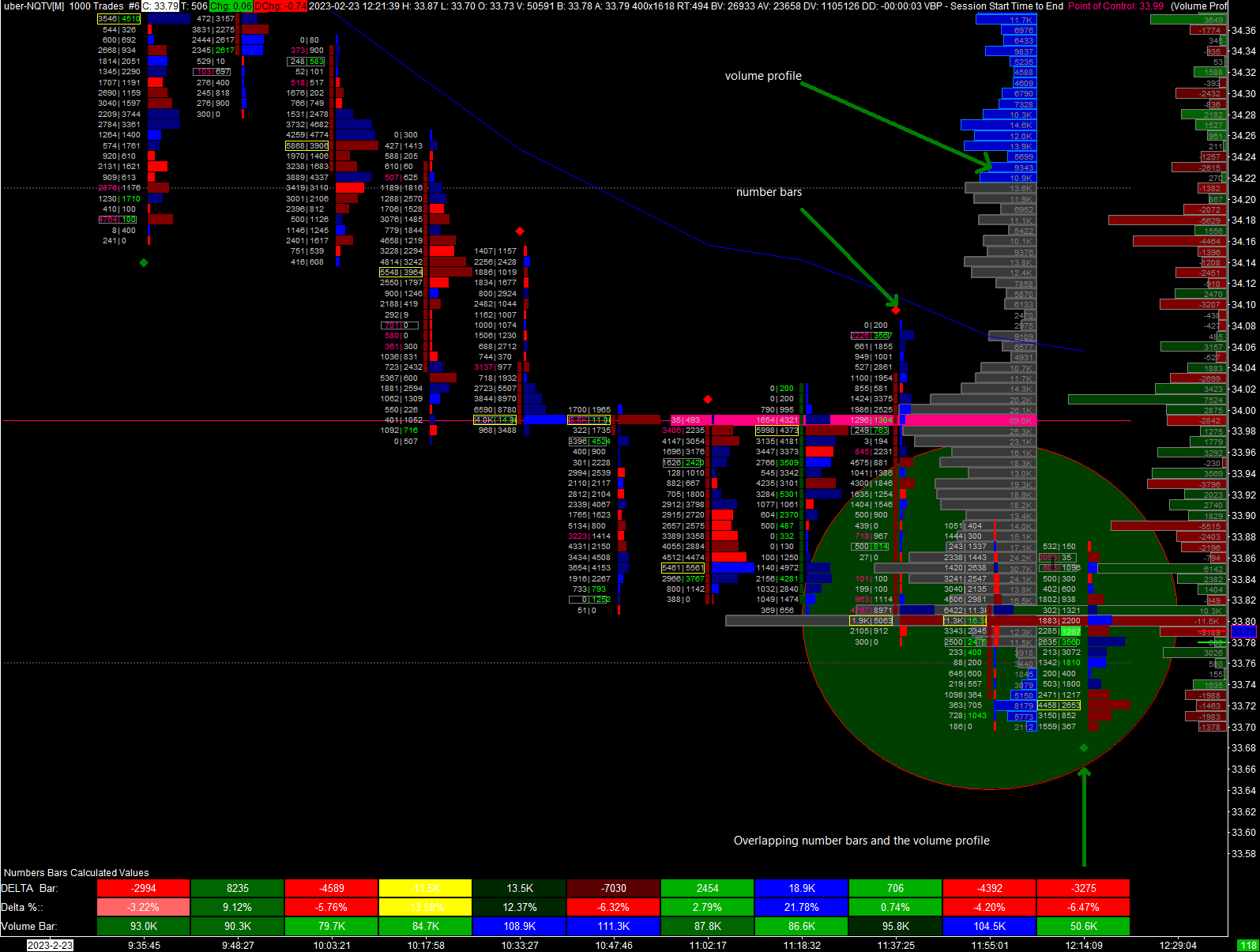

Hello SC Support;
I been trying to figure out this for the past few days but to no vail. Anyway my question is that I have two volume profile on the right side of the chart but number bars and the profile are overlapping. Is there a way to adjust the spacing? I attached a photo. Thank you....
https://www.sierrachart.com/image.php?Image=1677113507641.png

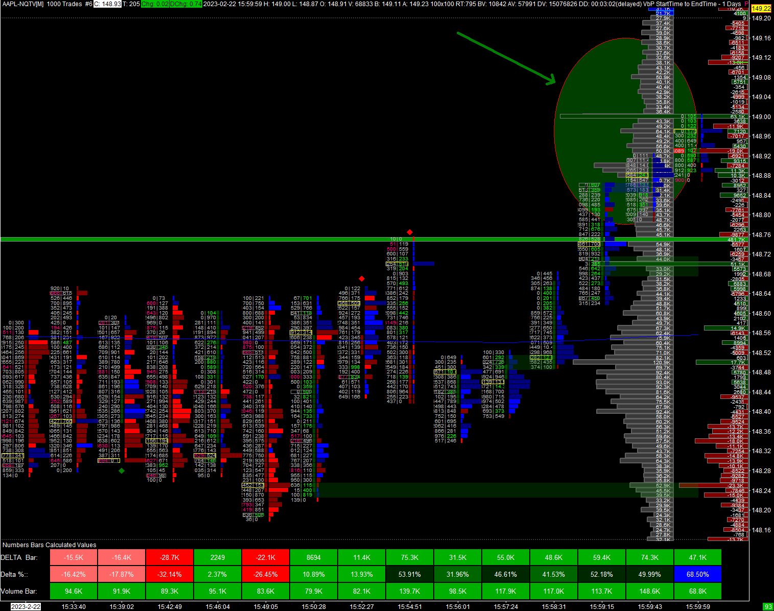

wildpanther1945 - Posts: 48
Hi SC Support;
I tried to do the Lock Space but still my profile and number bars after the adjustment.
https://www.sierrachart.com/image.php?Image=16771729040.png
[2023-02-23 17:33:08]
First, make sure that your Lock Fill Space is not active. Then adjust your chart so that the most recent bar is at the location where you want it to be locked. Then select Chart >> Lock Fill Space. This will then keep your most recent bar at the location that you have set.

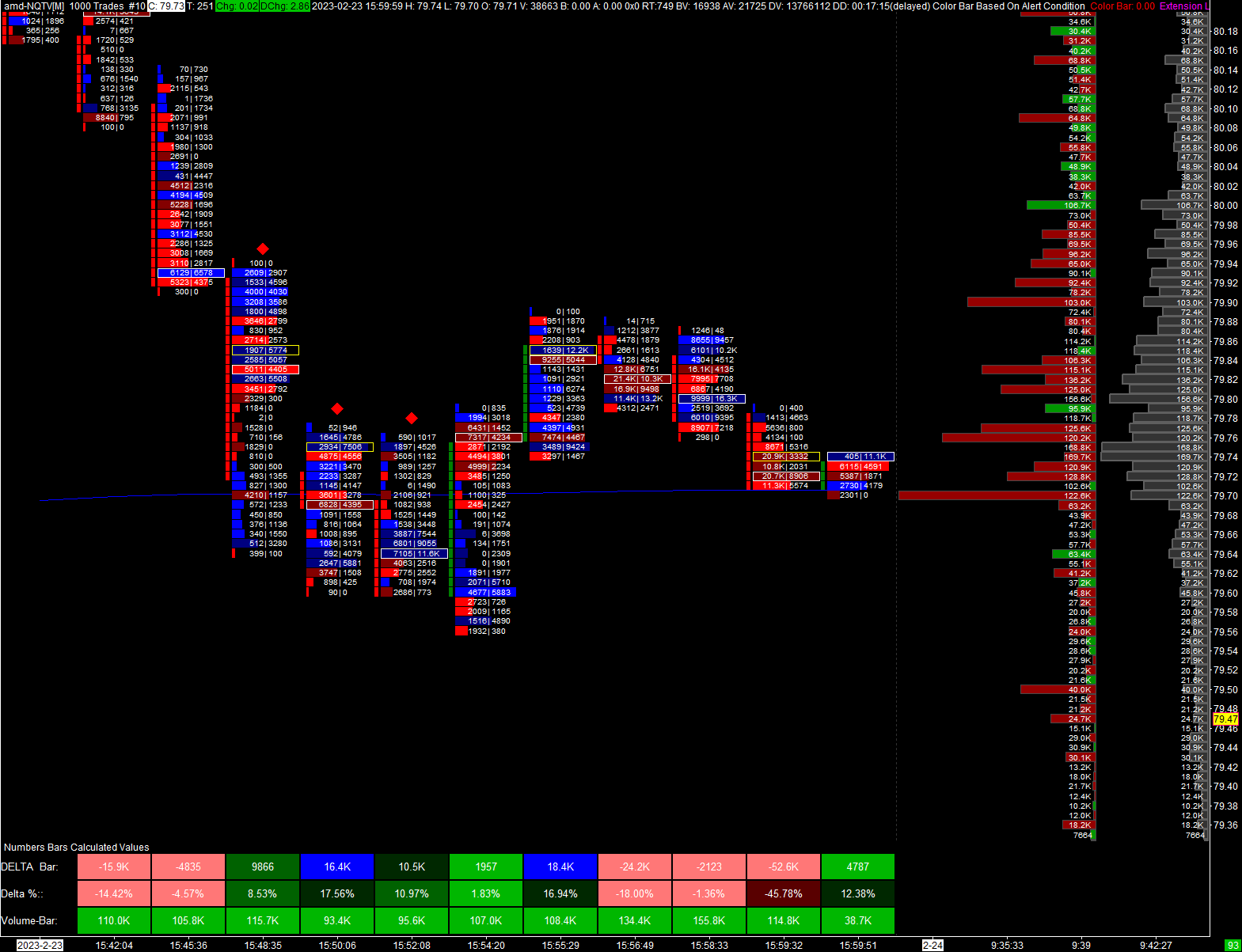

Hello SC Support;
I got it working finally. So I followed the " Lock Fill Space" and then I have to set "YES" in the profile " Allow side-by-side on Right Side". Photo Enclosed. Thank Your for your patience...
https://www.sierrachart.com/image.php?Image=1677206704102.png
