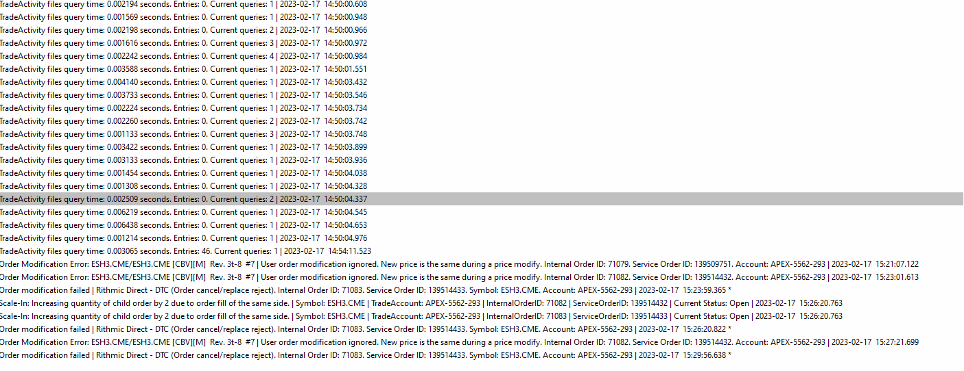

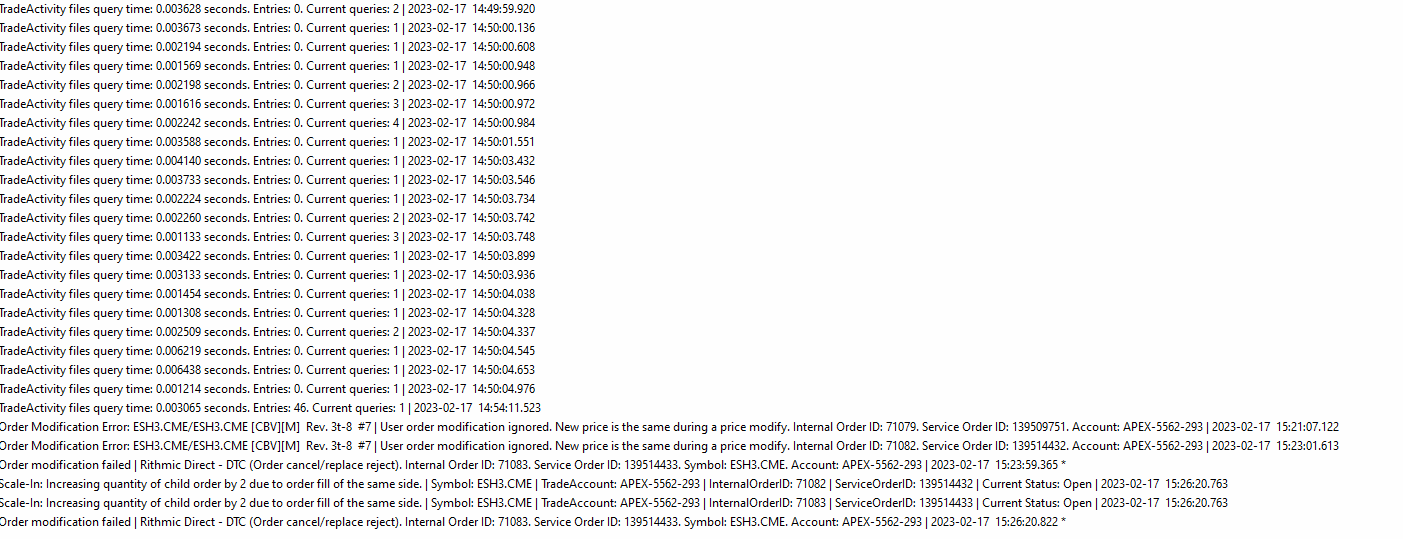

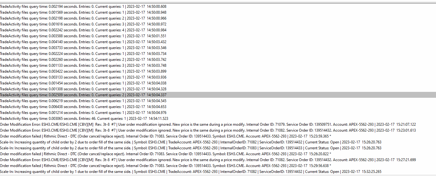

Here are a few screenshots of Fridays entries.
imageimage.png / V - Attached On 2023-02-18 08:56:29 UTC - Size: 78.74 KB - 303 views
imageimage (1).png / V - Attached On 2023-02-18 08:56:35 UTC - Size: 83.02 KB - 290 views
imageimage (2).png / V - Attached On 2023-02-18 08:59:12 UTC - Size: 87.21 KB - 307 views
[2023-02-18 21:19:48]
Sierra_Chart Engineering - Posts: 24914
All we can tell is that Rithmic is rejecting an order modification and we do not know why. Contact Rithmic for help with this.
