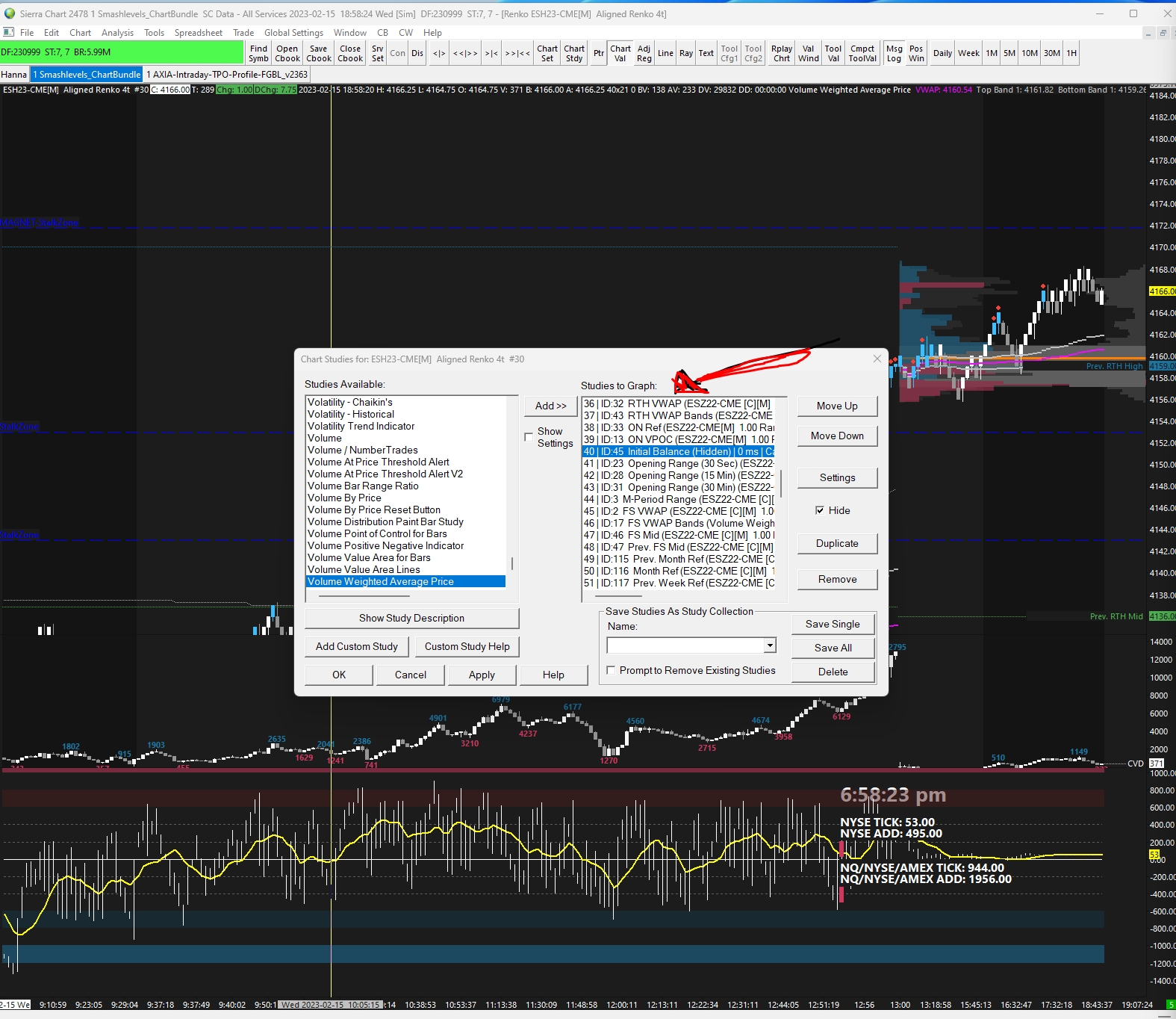

colin0021 - Posts: 34
I just chased a new pre-built chart from someone. When I start using it, I realize the studies that come with the chart do not work. When I check, I realize the instrument that these studies are based on are ESZ22 but that is the one future contract. Currently we use ESH23. I can't change the instrument on the study. Please see the attached screenshot. Please help.
imageScreenshot_2.jpg / V - Attached On 2023-02-16 02:59:03 UTC - Size: 907.14 KB - 283 views
[2023-02-16 15:17:13]
Are these Study/Price Overlay studies that reference another chart in the Chartbook? Does that chart exist? If the symbol is not what you want, then you would need to change the symbol in that chart that these are referencing.
Or, is this just part of the "Short Name" that has been entered for these studies?
[2023-02-16 17:04:30]
Here is information about Short Name:
Chart Studies: Settings and Inputs Tab >> Short Name
