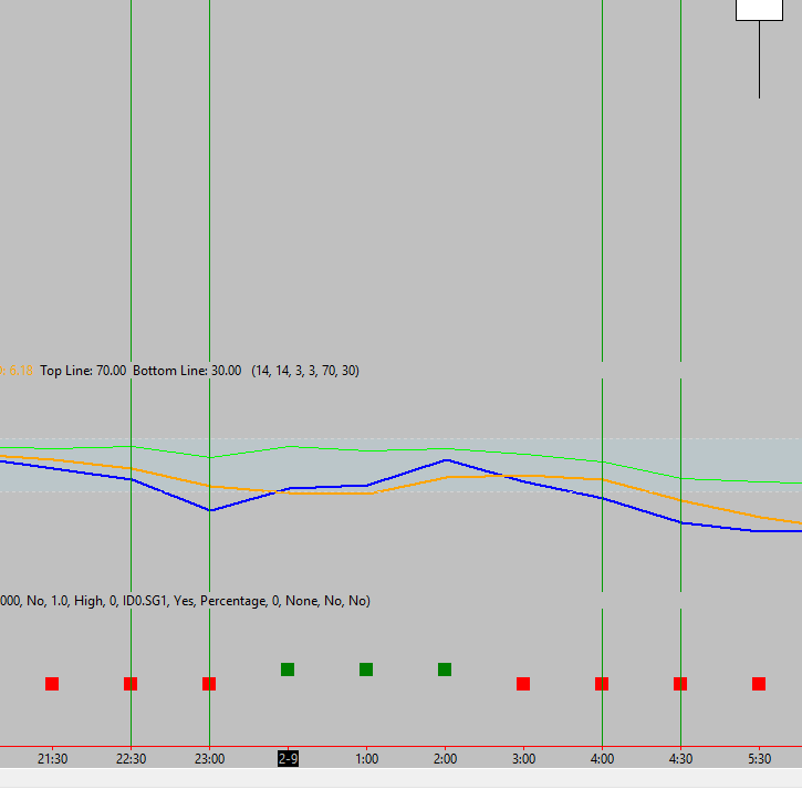

[2023-02-09 16:53:21]
User29194 - Posts: 5
At 4:30 am, my time UTC-8, my hourly charts reverts to my hourly bars to being the hour to on the 30. So from 4:30 to 22:30 the charts show a 4:30 to 5:30 bar... and so on. I have 2 different charting sources and on the 15 and 30 they are identical so I know it's not a provider issue. I posted a with 4:00am and 4:30am lined from my hourly charts.
Is this a setting issue?
imagesc support 3.PNG / V - Attached On 2023-02-09 16:52:48 UTC - Size: 16.12 KB - 265 views
[2023-02-09 17:25:43]
It is based on your Session Times. You must have an Evening Session that is set to start on the half-hour (16:30). At that point the bars will be based on that starting time. Refer to the following:
Chart Session Times: Bar Starting Times
