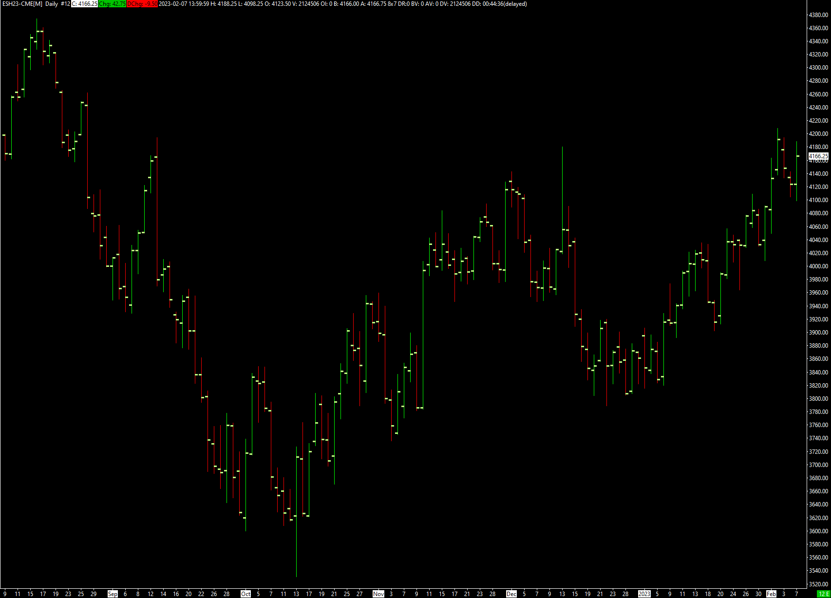

Thank you for your advice. So I decided to take your advice and go with Denali for data feed, not rithmic anymore. This works, however. I also want to be able to place trade inside SC connecting to my interactive broker. Please tell me how to connect SC to both Denali for data (which I already did) and interactive broker for trading. Thanks

First, you have not fully activated the Denali Exchange Data Feed yet, as you do not have any exchanges activated. Please activate the exchange(s) for which you want the real-time data from our Denali Exchange Data Feed. You can access the various exchange options at the following link:
https://www.sierrachart.com/UserControlPanel.php?page=ServicesActivation#DenaliNASDAQ
Once you have the Denali Exchange Data Feed setup, then you will be getting the Denali data, regardless of the trading service you are setup to use. Refer to the following:
Real-Time Exchange Data Feeds Available From Sierra Chart: Integration with Trading Services
