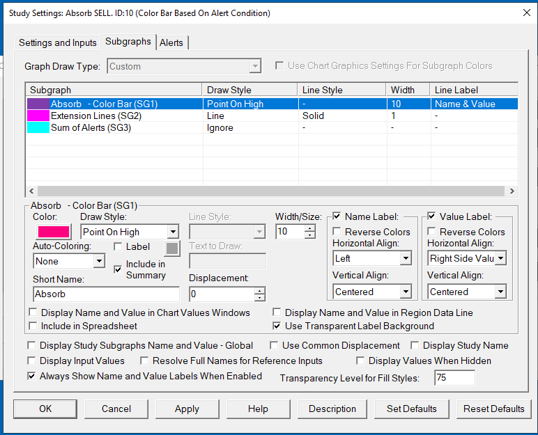

I now want to focus on having setups alerted me on the chart, such as signals.
I'd like to have different ways of displaying the signals so I can identify them but so far I can only find color bar based on alert condition and then select point on low or point on high to display.
I was hoping to have the ability to sometimes use circles and other times triangles or arrows or other identifying patterns plus I want to have the signal name as well.
Here is one example I just coded up showing absorption last bar down was a big one and this bar's width is <60% with higher delta clear ice or limit buying at the lows. I'd like to LABEL the circle and/or like I said above give it a name as well and in some cases might only want to put text on high or text on low.
I can't figure out how to do any of this.
imageCapture.PNG / V - Attached On 2023-02-04 16:45:09 UTC - Size: 131.5 KB - 452 views
[2023-02-04 16:53:08]
TopGunTrader - Posts: 313
I kept messing with settings and can now display an alert so just need/hope to have other patterns other than circles and also would like alert to be BELOW or above the signal bar just in case there are patterns on multiple bars in a row. I noticed always show name and values when enabled and use transparent label background lets me show my short name but its to the LEFT of the signal hoping to put it above/below as well.

I'm ok with the alert method I'm using now just wanted to know if its possible to have OTHER symbols than circle at high/low can I do triangle at high/low or arrows, stars etc?

Under subgraphs change the draw style to any of the options available

I'm aware I can do that but want something that goes on top/bottom of bar and is different than point on high/low. I couldn't find triangle on high or star at high. Is there a way to have those at levels?
Here's one of my alerts
=AND(C[-1]>O[-1], ID8.SG41[-1]>=3,ID8.SG41<=.6*ID8.SG41[-1],ID8.SG1>ID8.SG1[-1])
It returns a 1 so if I want a star at the low of bar is there a way to take the 1 result and get the low of bar minus say 2 ticks and use a star or other identifier?

User431178 - Posts: 910
It is explained here with step by step instructions -
Color Bar Based on Alert Condition: Drawing Arrows/Text or Other Styles at the High or Low of Bars

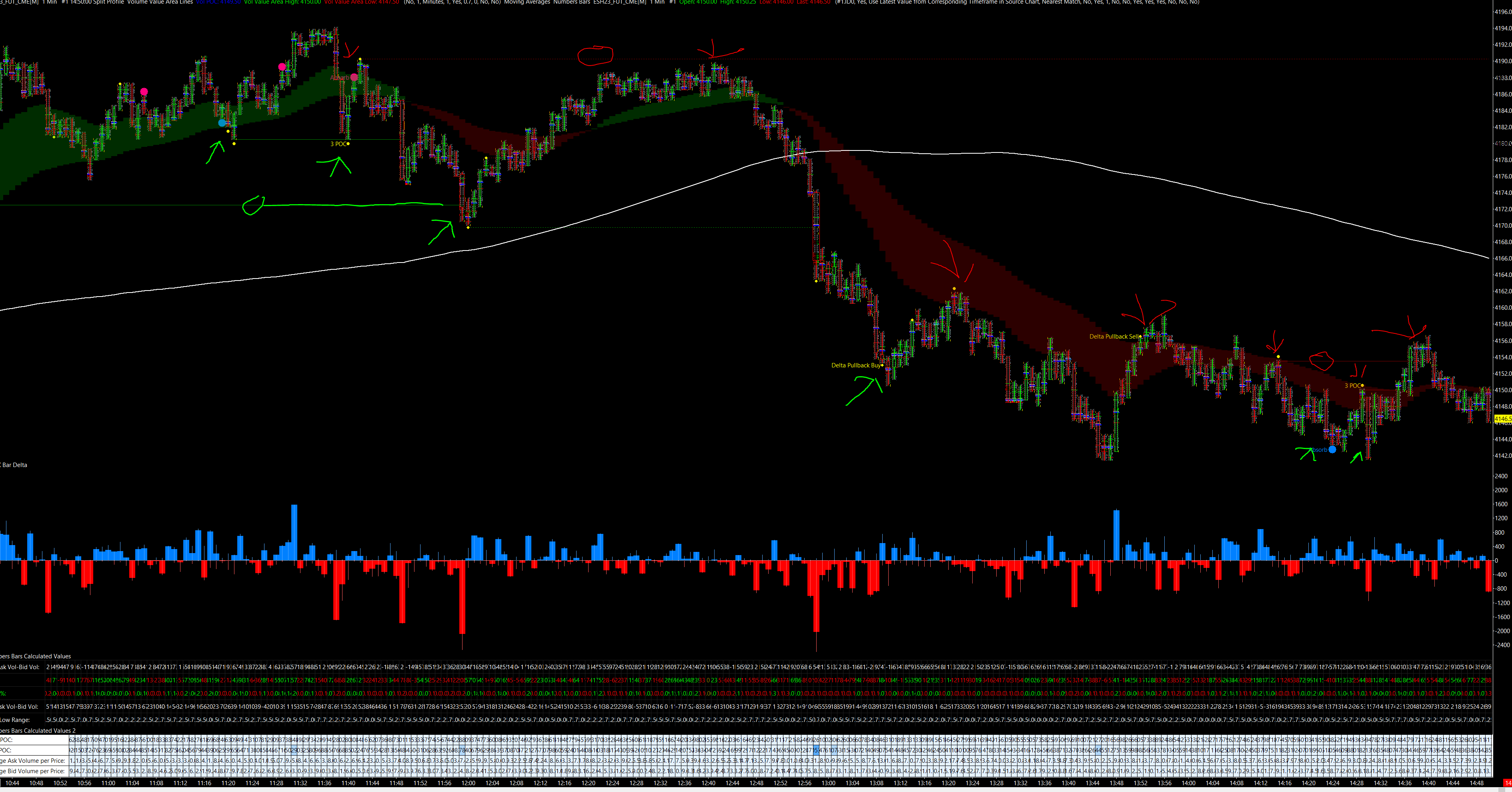

Wow have NEVER been happier with Sierra Chart and your service. Transforming my trading, realized with this mark up method I can extend lines and so often one pattern in the future at same level COMBINES with another for added odds. I haven't drawn the extensions on most that I've coded up yet
