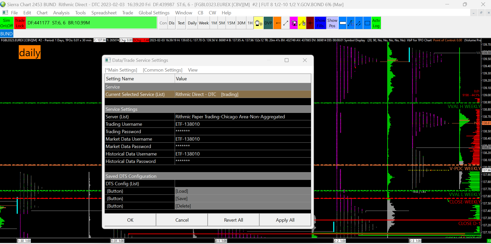

I have a problem about the max connection for same device from SC Data, despite the fact that I am not using SC Data (I am actually using Rithmic, as you can see in the picture here below).
So how can it be that it says that I have 3 connections for same device ? I should have none (since I use Rithmic).

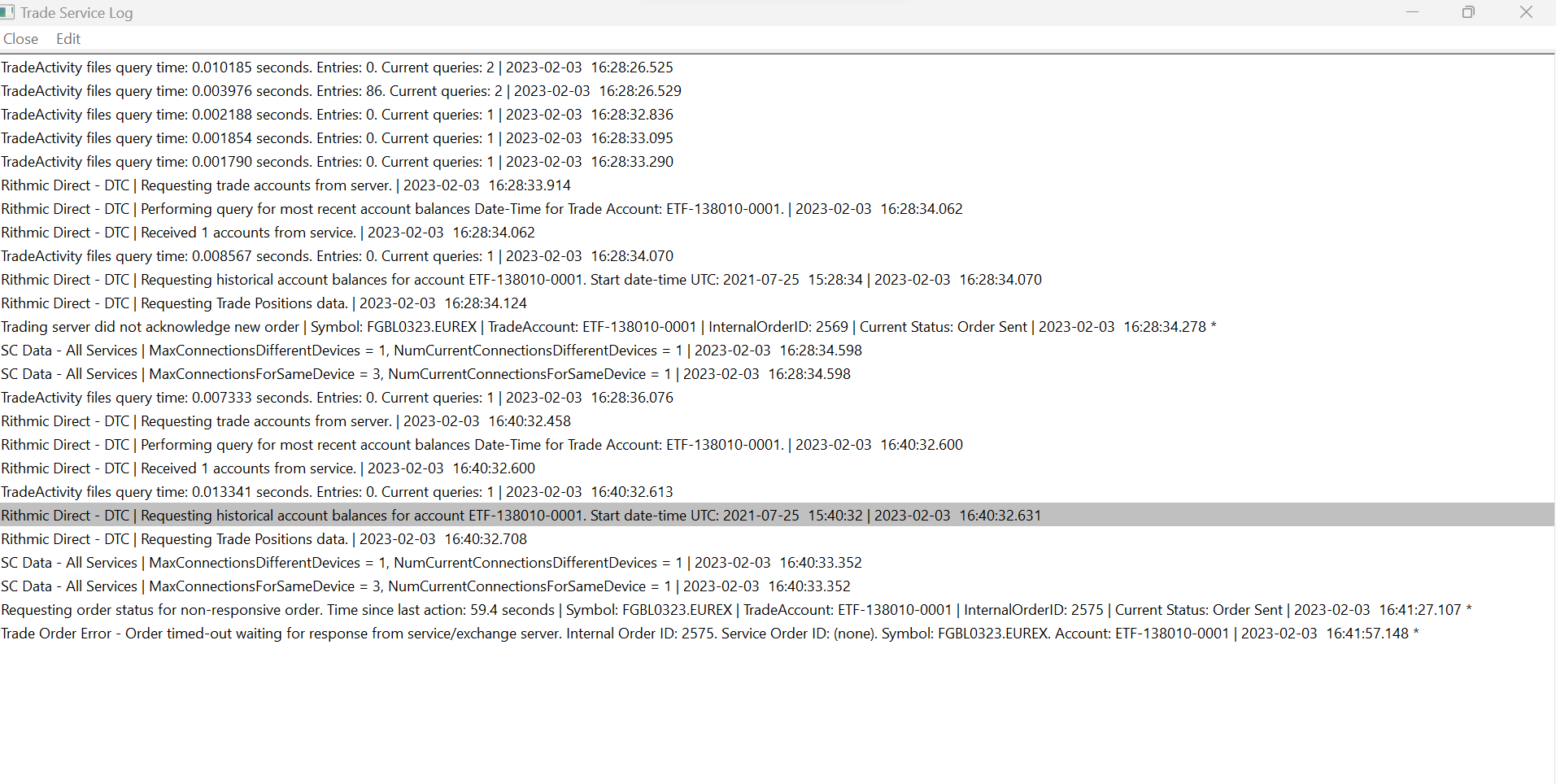

The message from the log is the following :
imageCapture d'écran_20230203_164216.png / V - Attached On 2023-02-03 15:47:45 UTC - Size: 117.09 KB - 233 views
imageCapture d'écran_20230203_163932.png / V - Attached On 2023-02-03 15:48:00 UTC - Size: 150.44 KB - 206 views
[2023-02-03 18:13:45]
You are setup to get the EUREX data from us, which is required as we do not allow for data for EUREX from any other source.
Therefore, you do have too many connections to the Denali Exchange Data Feed. Refer to the following:
Denali Exchange Data Feed: Denali Exchange Data Feed on Two Computers Simultaneously
