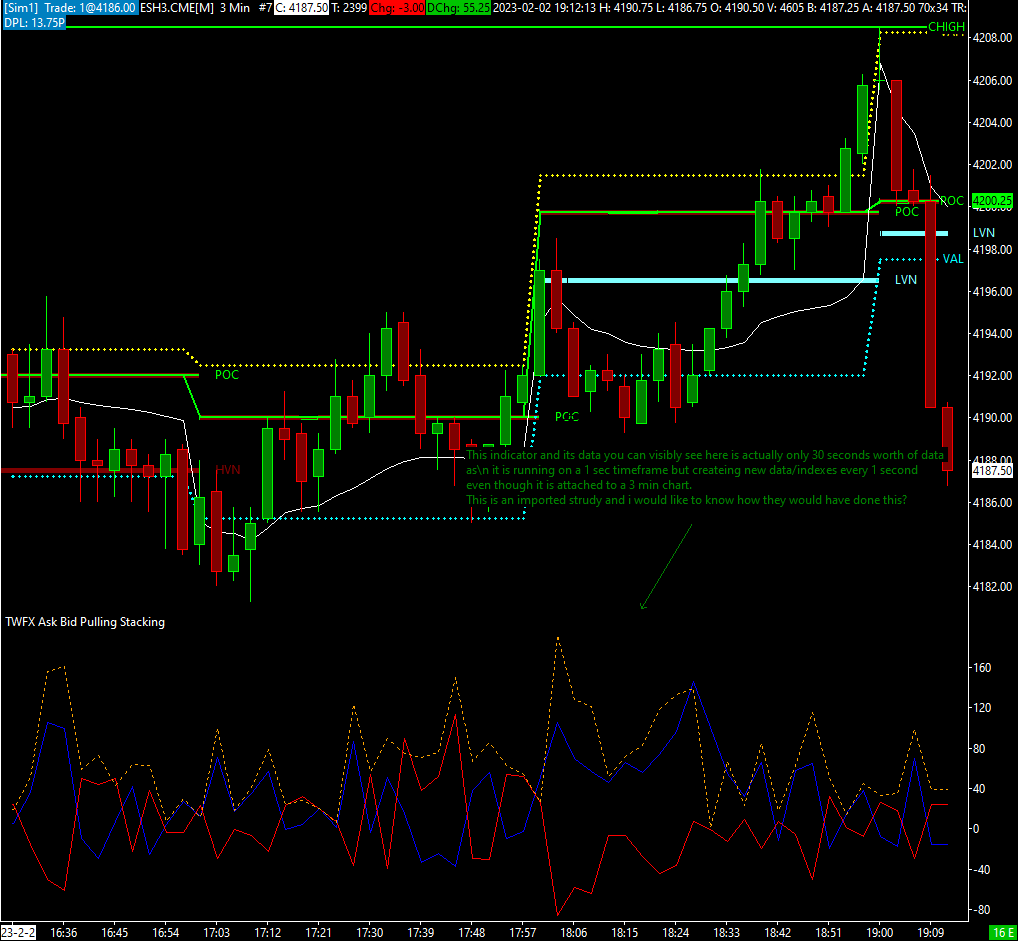

tarik medjber - Posts: 13
https://www.sierrachart.com/image.php?Image=1675365134280.png
Hopefully this screenshot worked.
here is an example of a study that is doing what i want to do with my own study.
[2023-02-02 22:59:40]
We think we understand what you are asking for, the Time and Sales... studies show this kind of functionality, where all the data is changing separate from the main price graph.
In the end, what this entails is rewriting all of the Subgraph data for each update.
[2023-02-03 06:30:14]
Ahh wow okay, so in this case for every 1 second, the study loops back round and moves each subgraph indexes value to the previous index to make room for the latest one. That seems like a lot of work. Manual looping is definitely needed then. Thanks John.
