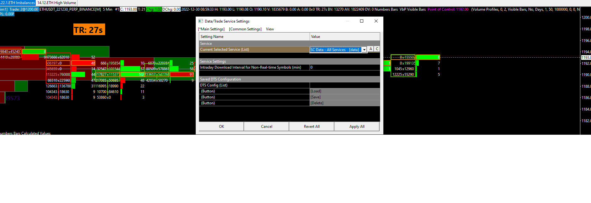

I am asking for technical support. The current chart cannot be loaded. Everything stopped on 12/30/2022. Regards, Daniel
imagedata2.png / V - Attached On 2023-01-24 00:00:21 UTC - Size: 106.06 KB - 189 views
imageData.png / V - Attached On 2023-01-24 00:00:27 UTC - Size: 46.68 KB - 182 views
[2023-01-24 15:40:11]
The symbol you are using is ETHUSDT_221230_PERP_BINANCE. Therefore we assume that this symbol only has data through December 30, 2022.

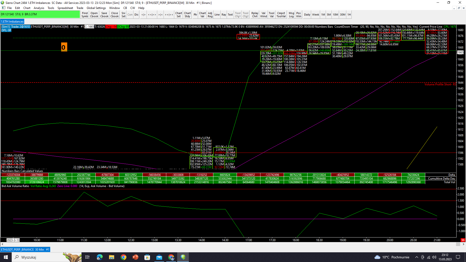

[2023-03-13 16:09:56]
Daniel Kamiński - Posts: 25
I don't have actual data. Something stoped my data. Can You look at this ?
imageData Problem.png / V - Attached On 2023-03-13 16:09:22 UTC - Size: 170.99 KB - 187 views
[2023-03-13 16:14:22]
shows now -2h
imageData Problem...png / V - Attached On 2023-03-13 16:14:15 UTC - Size: 168.67 KB - 233 views
[2023-03-13 20:44:46]
We are not seeing an issue with the Binance data at the moment.
Please get us a copy of your Message Log by following these instructions:
[2023-03-13 22:07:16]
ok, I sent it
[2023-03-13 22:13:51]
the graph currently looks like the attached picture. There is a big gap
imageData.png / V - Attached On 2023-03-13 22:13:47 UTC - Size: 143.38 KB - 162 views
[2023-03-13 22:30:38]
Your log does not show any issues with the data. To fix missing data, refer to the following:
Data Errors or Spikes in Charts, Flat or Flat Line Graph, Compressed Graph, Errors with Date/Time Values: 2.1.2 Deleting and Re-downloading Data. (Easier and Recommended Method)
