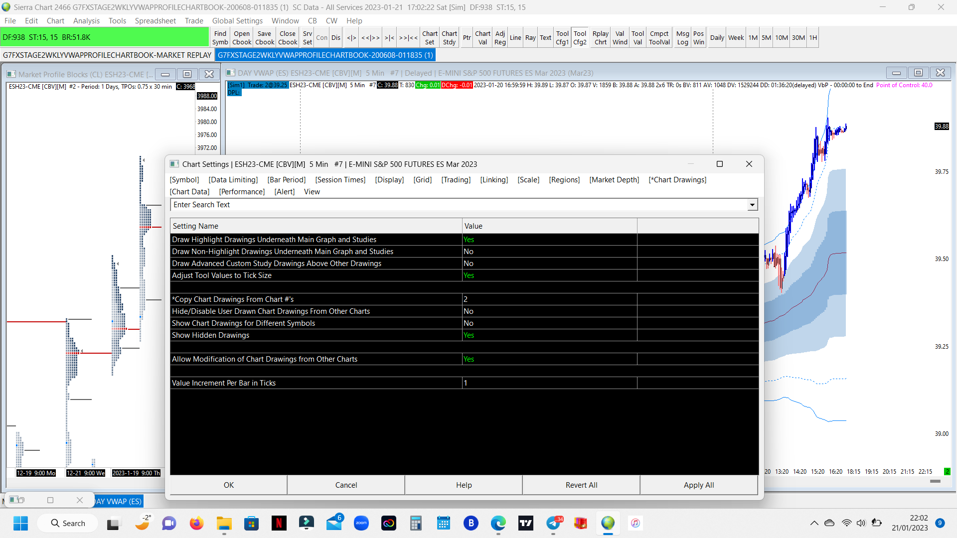

I have followed all instruction's to copy drawings but cant seem to get it to work. I have attached a screenshot of my settings
imageScreenshot (4).png / V - Attached On 2023-01-21 22:08:07 UTC - Size: 224.02 KB - 449 views

You have your setup to copy drawings from Chart #2 to Chart #7. Any drawing on Chart #2 should be showing up in Chart #7 unless you specifically set the drawing to not copy.
But, keep in mind that if these are different symbols, then you would need to set the option for Show Chart Drawings for Different Symbols to Yes and even then, the prices are often different enough that you may not see the drawing within the view of the destination chart.
If you are still having an issue, then we would need to see the two charts side-by-side so we can see the drawing in the one chart and not see the drawing in the other.
