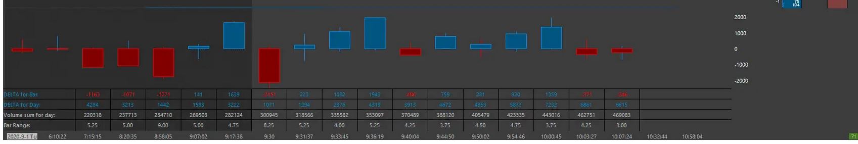

I have a footprint chart with numbers bars calculated values. I wanted to have a subgraph as posted in the picture. I have tried adding study subgraph reference but am only able to produce bars as a display output instead of true candlesticks. Could you please let me know how I could go about replicating the picture?

If you want to display candlesticks then you would need to have 4 items - an Open, High, Low, and Close. If you know how you want to determine these, then we recommend using the Spreadsheet Formula (Bar) study, which allows you to define all 4 items to create a candlestick bar. Refer to the information for the Spreadsheet Formula here:
Spreadsheet Formula

Just would like to confirm the formula values would be:
open - 0
High - id4.sg4 (+delta sum)
Low - id4.sg5*-1 (-delta sum)
Close - id4.sg1 (delta)

If that works for you, then that is fine.
Just one thought - instead of having the Open at 0, you could use the Close of the previous bar. So the Open formula would be ID4.SG1[-1].
