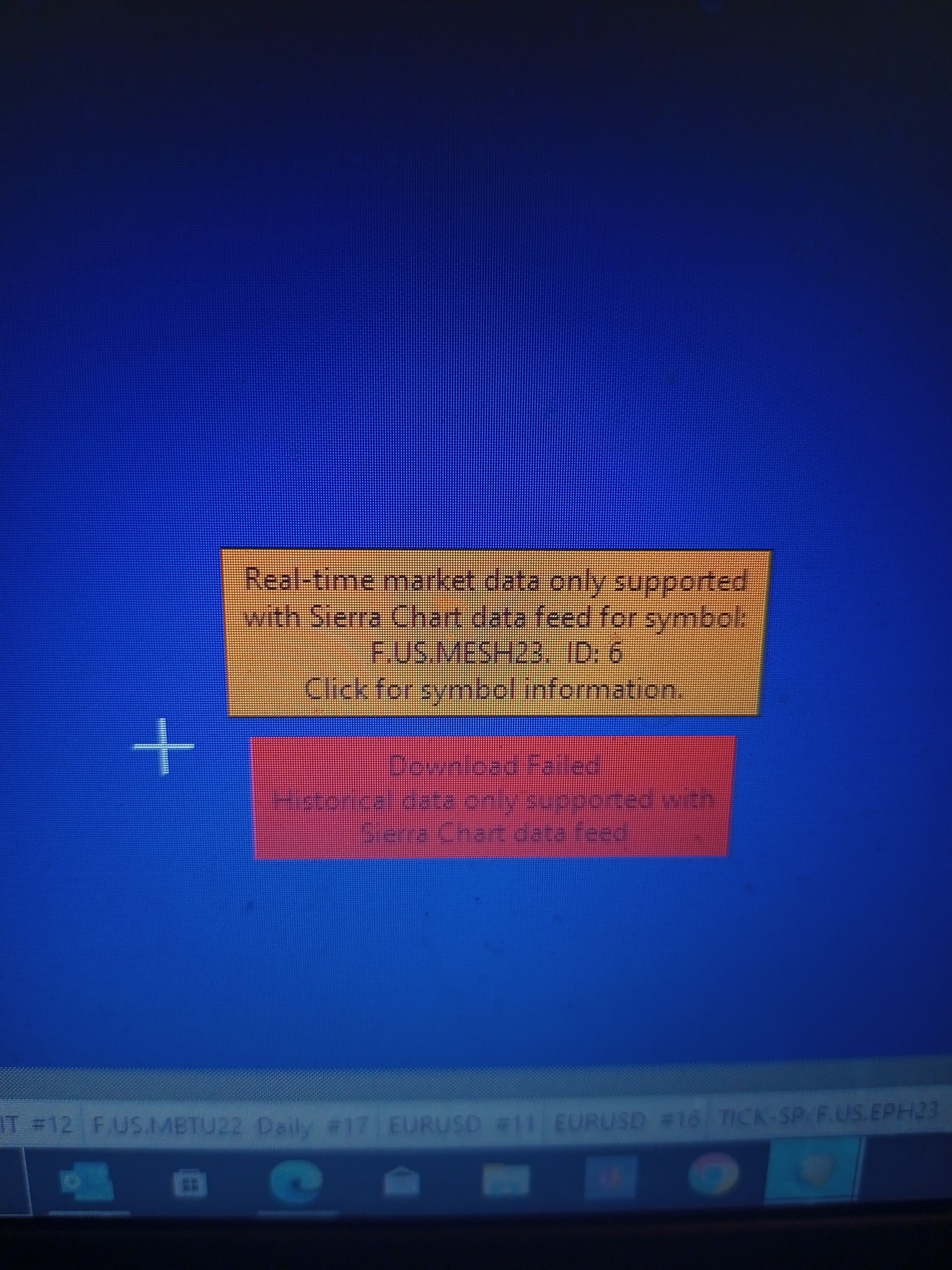

Al conectarme a la red CQG y abrir el grafico del micro SP 500
me sale este mensaje.
No entiendo que tengo que hacer. Me pueden decir que hacer para
poder descargar los graficos.
Adjunto una foto de la pantallla con el mensaje que me sale.
Gracias
image326345313_2194656534074953_5526059350116739632_n.jpg / V - Attached On 2023-01-19 01:34:13 UTC - Size: 741.62 KB - 214 views

Sierra Chart does not support data from CQG for the CME Group and EUREX. You are getting that message because you do not have the Denali Exchange Data Feed setup for the CME Group data. Follow the instructions at the following link to get the data setup for the CME Group:
If you are using Sierra Chart for your charting and trading, then you can let your broker know that you do not want to pay for the data from CQG, as you do not need it.
