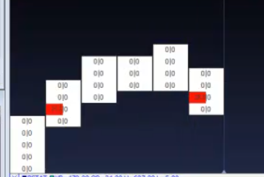

Hi support,
How do I create a solid background with the numbers bars study and only highlight the filtered chart volume? See attached picture for what I'm trying to do.
I've managed to filter the chart for volume > 25 contracts but don't know how to colour the background of the whole bar with a single colour and only highlight the filtered bid/ask volume.
Thanks,
TeBrick
imagefiltered bid ask with solid background (more than 25 volume).png / V - Attached On 2023-01-12 12:47:46 UTC - Size: 99.99 KB - 287 views
[2023-01-12 16:18:42]
There is no way to color the background of the Numbers Bars without having a small line that separates each level. So the closest you could get would be to set the following:
- Column 1 Background Type: Full Background
- Column 1 Background Coloring Method: Based on Volume Percentage
- Column 1 Percent Compare Thresholds: 0, 0, 0 (this forces the coloring to use just the Range 3 Up/Down coloring)
- If you want the same color for the bars then set the Range 3 Up/Down coloring to be the same.
We also want to point out that you can turn off the coloring of the Numbers Bars completely by setting the Input for Background Coloring Method to None.
With the above, you can also color the Open to Close by using the Open/Close Marker Style of Candlestick Body Filled. Refer to the following:
Numbers Bars: Candlestick Body Filled

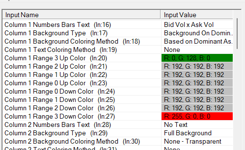

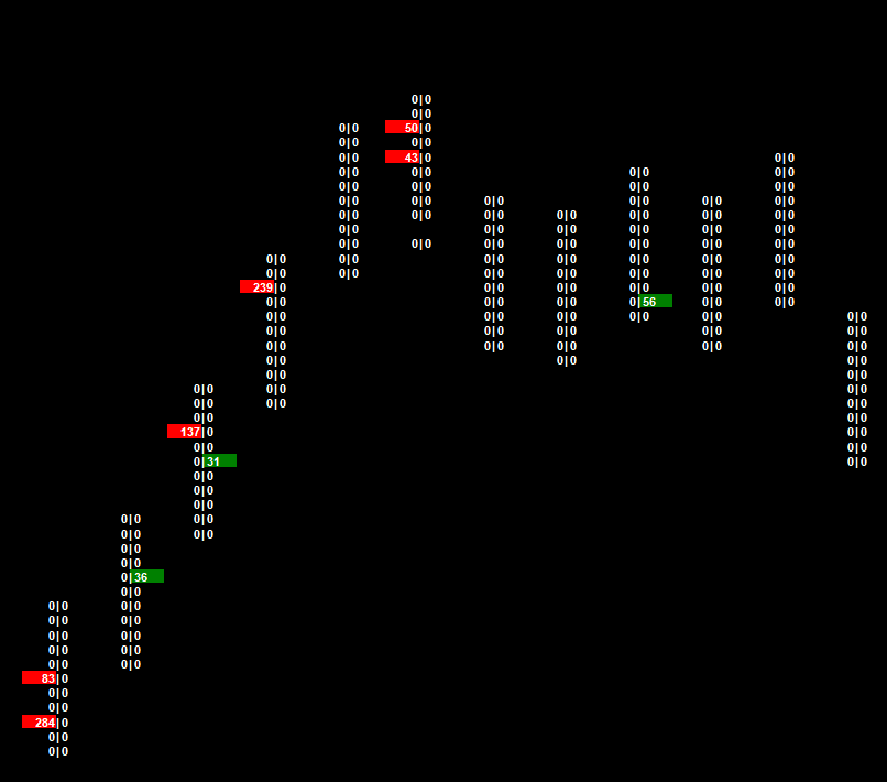

[2023-01-12 21:26:33]
TeBrick - Posts: 2
Thanks, John. I managed to get half of what I wanted, except for the background (see attached example and settings).
It would be great if SC could support what I'm trying to do in a future release.
imageNumbers bars settings.png / V - Attached On 2023-01-12 21:26:02 UTC - Size: 25.62 KB - 192 views
imageFilter numbers bar.png / V - Attached On 2023-01-12 21:26:07 UTC - Size: 11.81 KB - 196 views
