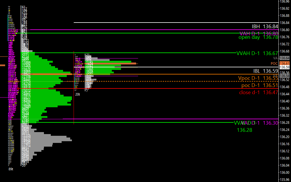

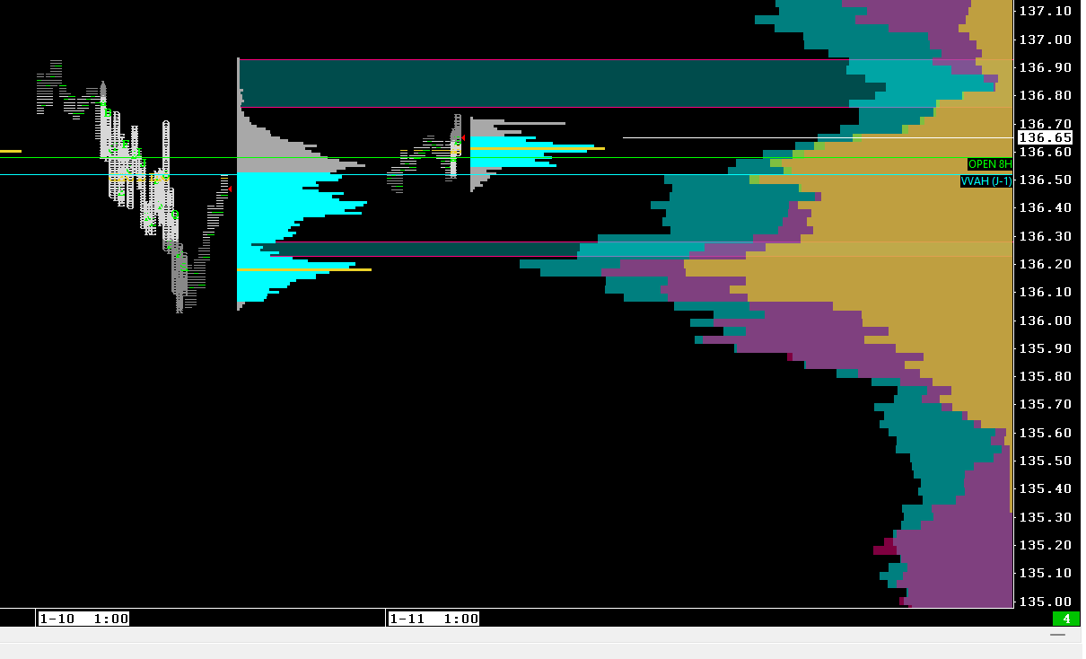

We detected a problem about a considerable difference between two VVA that we find among a group of different users.
The users have :
- the same datafeed (Denali);
- the same VbP and VVA settings;
- the same TPO settings;
- the same chart settings.
Nevertheless, as you can see in the screenshots below, for the day 2023-01-10, one group has the VVAH value at 136.67, and the other group has the VVAH value at 136.52.
The market is FGBLH23.
How could it be possible ?
Thank you very much for your help.
imageVVAH_Group_1.png / V - Attached On 2023-01-11 07:57:26 UTC - Size: 71.79 KB - 190 views
imageVVAH_Group_2.png / V - Attached On 2023-01-11 07:57:30 UTC - Size: 20.28 KB - 275 views
[2023-01-11 16:25:45]
We see some small differences in the Volume by Price profiles, so there is something different between the two setups. In particular, we wonder if the Ticks per Volume Bar is set the same in both cases. Since these are tied to the TPO, you can not change this value in the VbP settings - you need to change it in the TPO and then it will reflect in the VbP. Refer to the following:
Volume By Price Study: Ticks Per Volume Bar
But it could also be related to the Chart Settings, such as the Session Times, New Bar at Session Start, etc. Refer to the following:
Volume By Price Study: Volume Profile Differences
[2023-01-18 03:20:47]
Refer to the information here:
Time Price Opportunity (TPO) Profile Charts: Incorrect Value Area or Point of Control Values
And refer to:
Working With Charts: Resolving Differences of Chart Bars Between Charts
