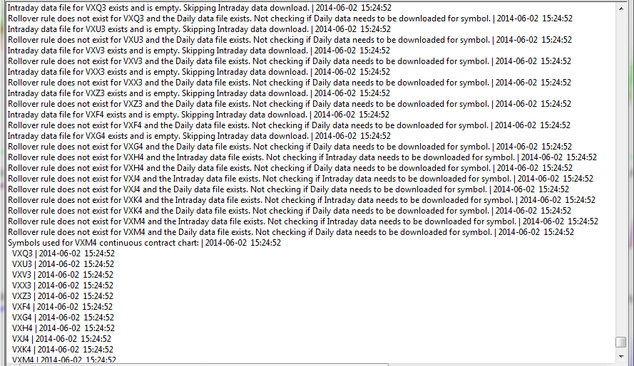

I'm not able to get intraday data (blank chart) for the VIX index (symbol $VIX) while its historical data is just fine
as for the VIX future (symbol VXM4) the intraday data is ok but only for the current contract - I can't load its previous contracts (I did select the continuous futures contract option) (for example 300 days 240 min chart with volume/date based rollover)
I followed the steps on http://www.sierrachart.com/index.php?l=doc/helpdetails7.html but couldn't see any suggestion for the error's I get
please check the attached error log screenshots below
I'm Using latest version with OEC/Sierra, Maximum Historical Intraday Days to Download is set to 300 for both tick and non-tick data
Any ideas please?

imagevix index.PNG / V - Attached On 2014-06-02 20:27:59 UTC - Size: 3 KB - 656 views
imagevx contract.PNG / V - Attached On 2014-06-02 20:28:06 UTC - Size: 76.86 KB - 592 views

You cannot get data for $VIX unless you are using the Sierra Chart Exchange Data Feed:
http://www.sierrachart.com/index.php?l=doc/SierraChartRealTimeFuturesStockDataFeed.php
And have activated the CBOE Indices exchange.
There is not going to be much historical data for the VX futures. Only about two months.
