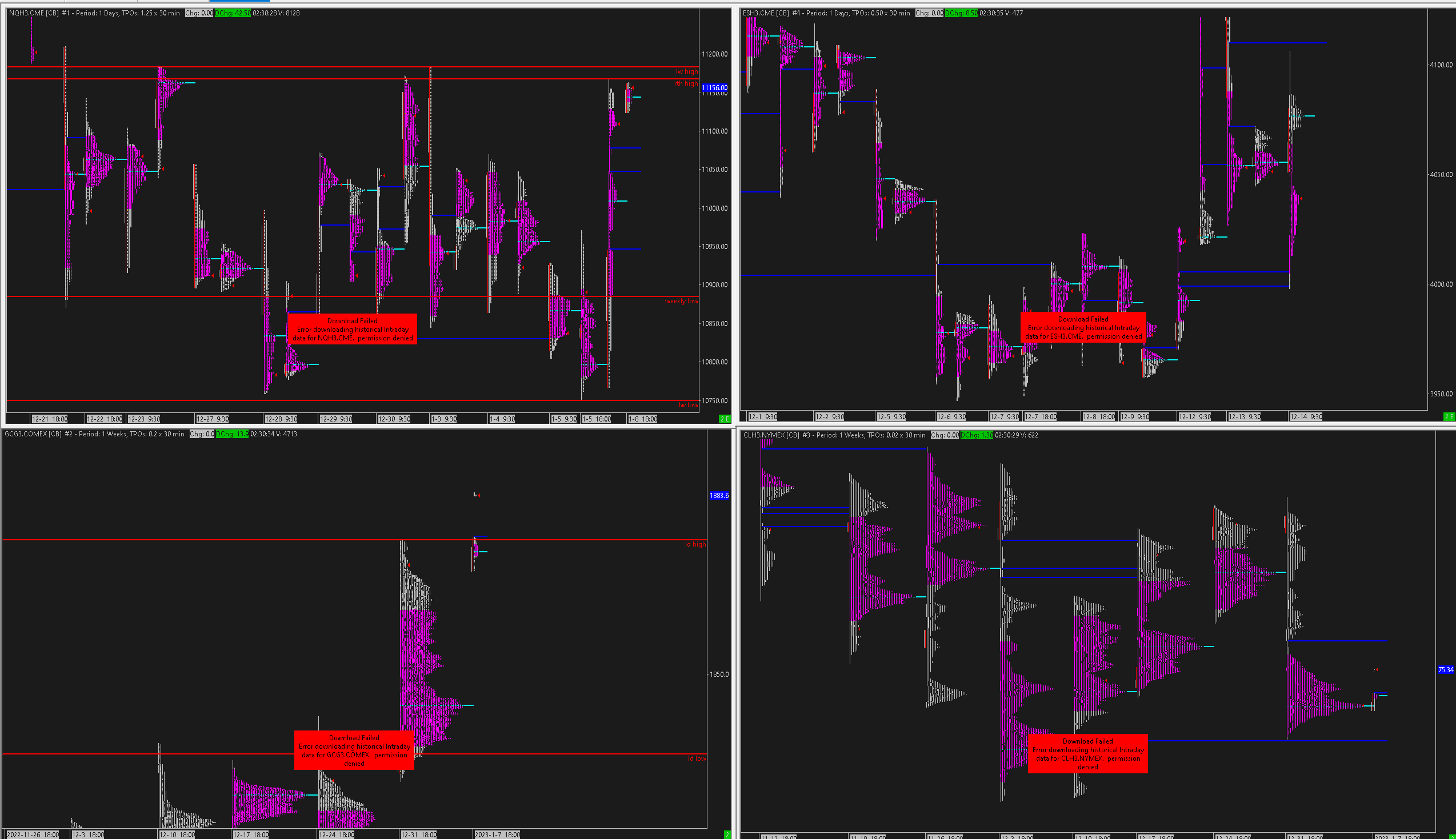

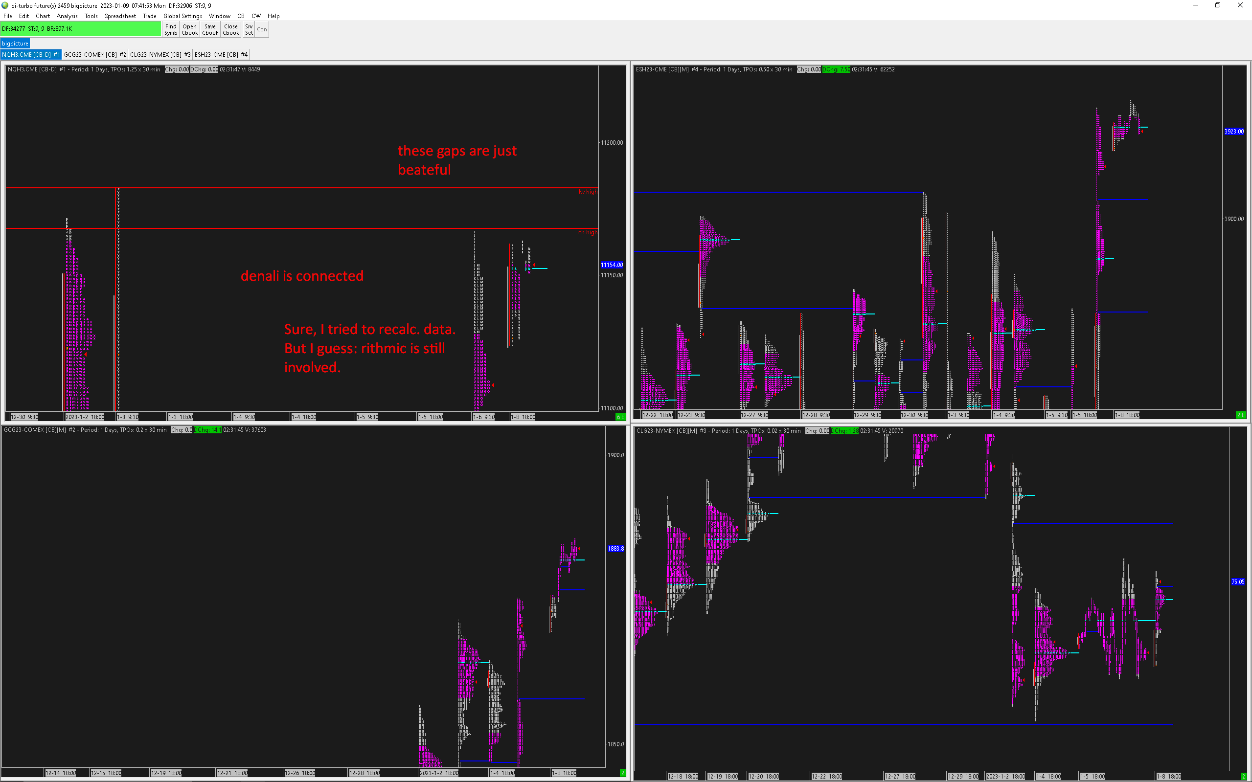

After three years, 4 sleepless nights I took the trouble to create two different chartbooks in the hope of becoming master of a recuring problem. One for denali. The other for live/funded. Current situation and why am mad? Because rithmic did the bad job. again. (please see attached file)

I don't want to seem rude, but I'm at my wits end. And even its even if this problem is only supposed to affect rithmic, i don't get any data under denali either. i may not be the brightest candle on the cake, but i have tried everything i can think of That's all I wanted to get rid of. i have tried everything. i am at a loss. i need a solution to finally be able to focus on business again instead of tools. of course: one or the other would say: "get a live account and connect it once a month. Sierra chart is not for you." But these are findings and solutions that are not satisfactory. I am a solution-oriented person who doesn't give up until he gets what he wants.

[2023-01-09 17:06:37]
First of all, you are not setup to get real-time data from us (Sierra Chart).
Second, our servers are showing that your Global Settings >> Data/Trade Service Settings >> Main Settings >> Current Selected Service is set to SC Data - All Services. If this is correct, then you are not going to be getting any real-time data for the CME Group, as you are not connected to Rithmic, and as we stated above, you are not setup to get data from us.
Third, we see a mix of symbols in your charts, which relates to whether you are connected to Rithmic or SC Data - All Services. If you switch between services then you need to update the symbols in your chartbook. Typically when leaving the Data/Trade Service Settings window, it prompts you if you want to change the symbols if you have changed services. You should select Yes. If you forget to do this, then you can force the symbol update by selecting Edit >> Translate Symbols to Current Service.
Now, given the above, the main question is what service do you want to be connected to. It sounds like you should be connected to your Rithmic account. If this is the case, then be sure to connect to your Rithmic account and that you have the correct symbols after doing so. If you need the instructions to connect to Rithmic then you can find these here:
