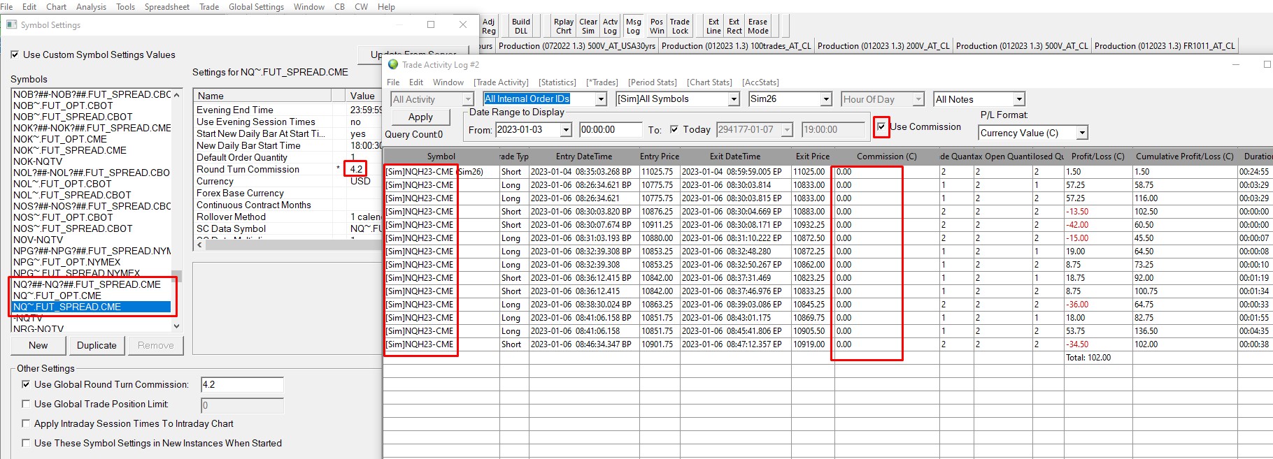

pls check the attached screenshot
1. the symbol i am trying to set the commission for and the activity log is still on 0 value (i set the 3 on the left)
2. can it be that when translating the symbol from CQGWebAPI to SC all data - it moved from NQ mini to NQ micro? or else why would my profits will be so small ?
pls advice
thanks

The symbols are different for the different services being used. As such, you need to enter the commission for the particular symbol that you using at that time.
In other words, when you are using the symbol NQH23-CME, then you would have had to make the changes to the symbol for that particular symbol (which will be available when the Current Selected Service is set to SC Data - All Services).
Also, in the image you provided, the selected symbol is for a Spread, not the NQ futures itself.
