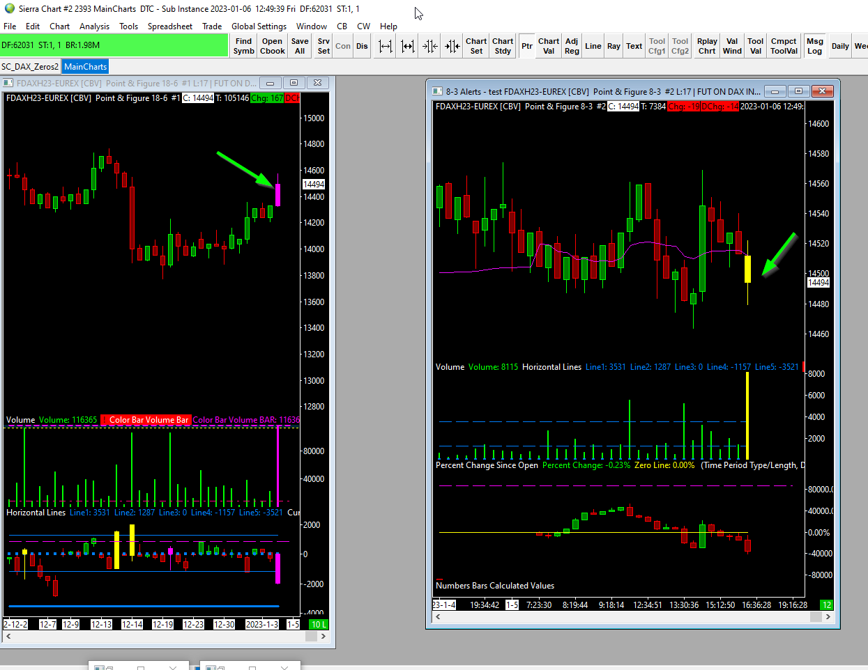

[2023-01-06 13:12:17]
User266447 - Posts: 280
I have differences between charts. In two different instances, I have the same charts (the same set-ups in these two charts - time sessions and so on). But these charts are looking differently. I am referring here to 18-6 point and figure and 8-3 point and figure. I have attached two printscreens (with green arrows which spot the difference). I also attached chartbooks with these charts so you have full access to the details. Finding there reason why I have these differences is very important to me. I missed two trades today because of the differences. Please take this seriously. I truly expect your full support on this.
In the next messsage I attache two chartbooks - here are printscreens attached only as there is limit in attachments.
imageAlertCharts.png / V - Attached On 2023-01-06 13:10:36 UTC - Size: 104.49 KB - 268 views
imageMainCharts.png / V - Attached On 2023-01-06 13:10:44 UTC - Size: 86.27 KB - 249 views

[2023-01-06 17:28:27]
We do not understand what the issue is. You are comparing an 18-6 Point and Figure to an 8-3 Point and Figure. These are going to give you two different charts, which is what you have.
We see that you point out the bars that appear to have an alert on them. Is this the question? Is there some question about the alert?
I am comparing 18-6 from one chart book to 18-6 chart from another chartbook. Similar with 8-3 chart from one chartbook to 8-3 chart from another chart book. In one chartbook I have two chart (18-6 and 8-3) and in the second chartbook I have also two charts (18-6 and 8-3). And if you take a look at 18-6 from one chartbook and look at the second 18-6 from another chartbook the charts are different even if the seting is the same. The same with 8-3 from these two chartbooks. Different charts even if setting in both 8-3 charts is the same.
Why is that?

[2023-01-06 23:04:11]
When we open the chartbooks we do not see any differences between the charts. Attached is an image of what we see for the two 18-6 P&F charts, as you can see they are exactly the same.
Therefore, we do not know why you are seeing a difference between the charts on your system. We recommend deleting the data and redownloading in both instances and see if that resolves the issue. Have chart active and select Edit >> Delete All Data and Download to do this for each instance.
Date Time Of Last Edit: 2023-01-06 23:16:18
imageFDAXH23-EUREX_18-6PandF.png / V - Attached On 2023-01-06 23:16:15 UTC - Size: 309.41 KB - 275 views
