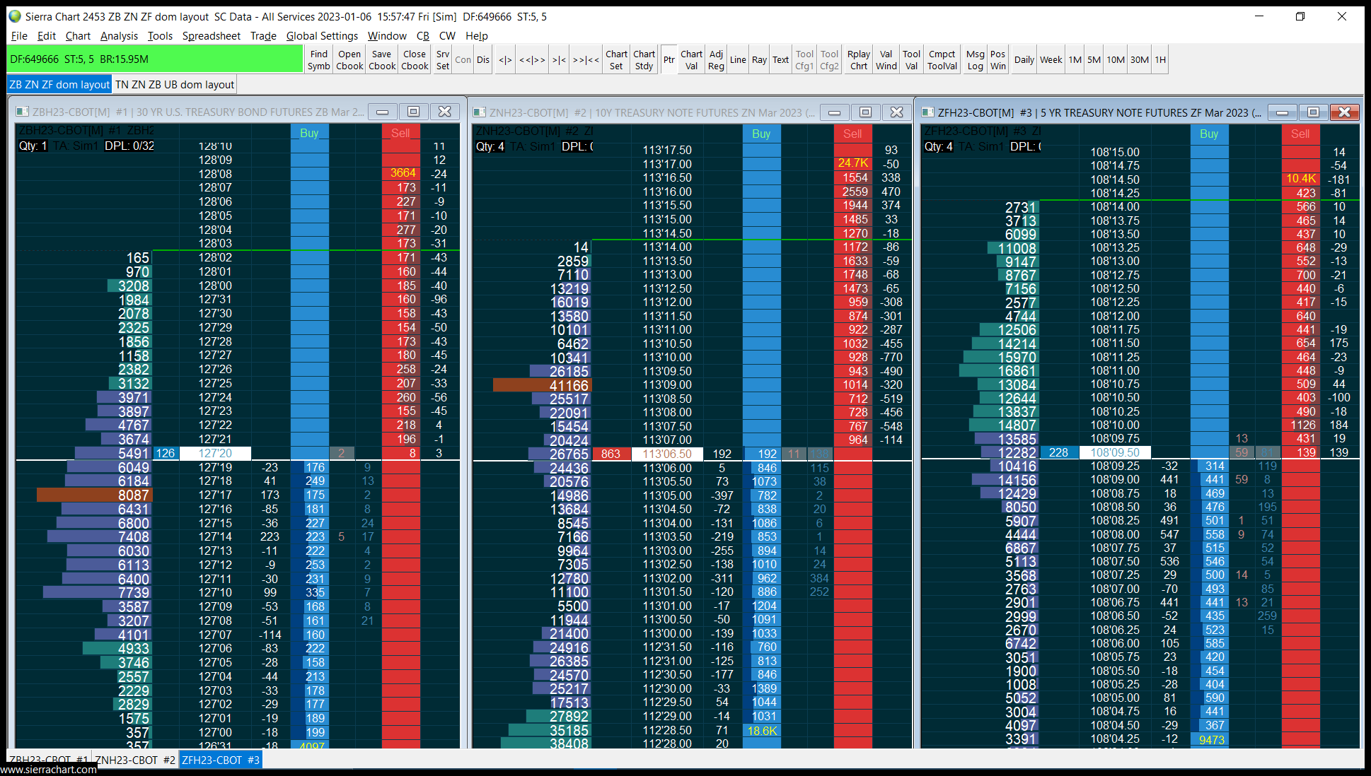

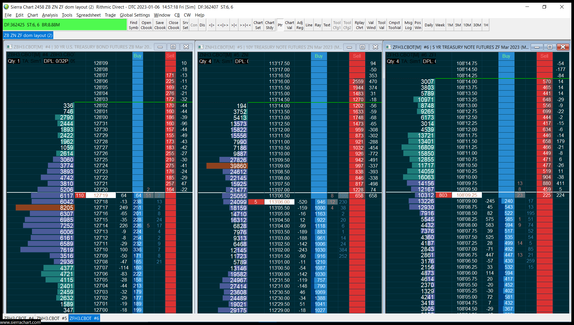

I have two instances of Sierra Chart installed, earlier today I noticed that the data displayed on the volume profile of my DOMs were slightly different between the two instances. Both instances are using Denali exchange data as the [M] is always displayed, the only difference is that on the second instance I have added a Rithmic account provided by Apex funding in the "data/trade service settings". I tried changing the symbol settings but it had no effect. Is there any way to solve this? I can share screenshots if it can help

I have attached the chartbooks. They are the same, I just renamed the second one which I use with my Rithmic account for you to differentiate them more easily. The screenshots were taken a few seconds apart from each other, but I can assure you that the market data is exactly the same, and you can see that by looking at the recent trades column in the middle of my doms. The only difference is in the volume profile which has different values at all price levels.
https://www.sierrachart.com/image.php?Image=1673017067535.png
https://www.sierrachart.com/image.php?Image=1673017040682.png

[2023-01-06 15:22:06]
Refer to the information here:
Volume By Price Study: Volume Profile Differences
It is going to be best to display a Volume by Price study on a normal chart with bars. So that you can see the bars it is associated with. Start with this for the purpose of troubleshooting. Otherwise, it is very hard if not impossible to understand what is happening.
We will not troubleshoot a Volume by Price study on a Trading DOM.
And refer to:
Working With Charts: Resolving Differences of Chart Bars Between Charts
