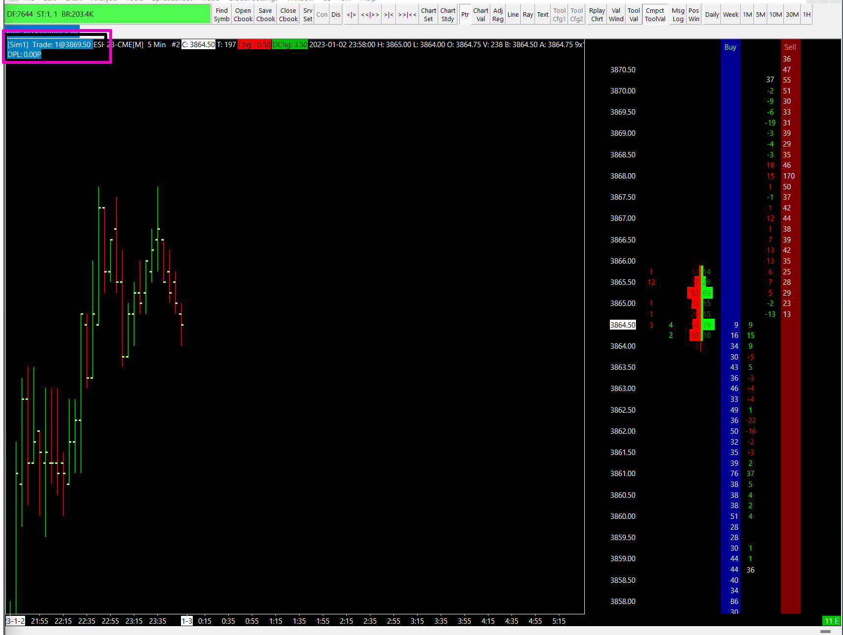

I have a service package of 11 and CME market depth data exchange package but on chart, it still shows SIM and I assume it is simulated account. Can I please know how to come out of it ?

[2023-01-03 14:29:18]
Can you tell us who your broker is. So we can give you the appropriate instructions.

[2023-01-03 14:55:01]
plutus1901 - Posts: 29
My brokers is stage5.
However, I trade on "Tradovate broker" on their platform and I use sierra chart for DOM, footprint (Number bars). Question - even though I am in SIM, do I still get the real time data ?
Thankyou
[2023-01-03 15:07:09]
With what we see at the moment you should be getting real-time data.
If not:
Open a chart for the symbol you have an issue with. Tell us that symbol of the chart.

[2023-01-03 15:19:29]
The log is very clear that you are receiving real-time data for ESH23-CME .

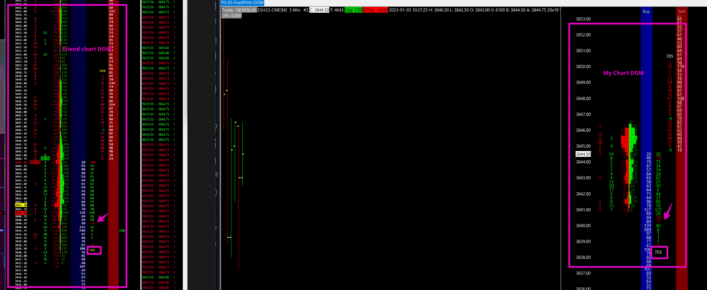

One more question -> me and my friend have same DOM. he does also gets the real time CME data but however, when I looked at his DOM, values are quite different like cumulative stack and stack column. Just wondering how come two users having difference in data.
imagechart DOM difference.png / V - Attached On 2023-01-03 15:39:46 UTC - Size: 572.23 KB - 337 views
[2023-01-03 15:52:07]
Pulling and stacking will be different because of different connection times to the data feed and the number of levels being tracked. Is your friend using the Denali Data Feed? If not that is another reason for a difference.

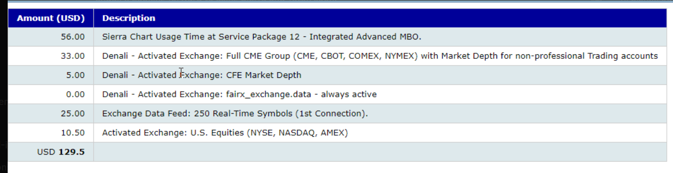

[2023-01-03 15:56:55]
He is using denali. I have attached his subscription package.

[2023-01-04 22:17:45]
You would both need to start the connection to the data at the same time in order to see the same Pulling/Stacking, as that is the point from which the Pulling/Stacking starts.
Basically what we are saying is that it is not possible to compare the Pulling/Stacking columns to someone else as the timing is nearly impossible to get right.
