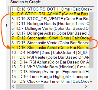

I am coding a study (ID 6).
I would like to access a subgraph contained in another study (ID 16), which in turn accesses another study (ID 12).
So the path should be 6 --> 16 --> 12, where "-->" means "accessing to subgraphs of".
I show you a screenshot of the path below.
The problem is that the condition ID16.SG1 = 1 (which means that the study 16 is indeed triggered by the study 12), is never activated, even when the study 12 triggers it). I need the condition mentioned above in order to use it in my study 6.
in other words, I would like to modularize my code by grouping some conditions in intermediate studies (here, study 16), but I can't.
So I end up writing a monstrous code in study 6, which is very annoying.
Thanks in advance for your help.

Chart Studies: Study Calculation Precedence And Related Issues
Take a look at the information linked above, not 100% that is the cause, as cannot see your alert formula.
ID6 should be below the other studies that it's based on, as ID6 and ID16 have the same precedence level.

Yes you want to check the calculation order of the studies and make sure they are as intended.
In the list of Studies to Graph in Analysis >> Studies you will see "CalcOrder: (where 1 is the first calculated study)". This will tell you what the calculation order is.

User286186 - Posts: 22
Thank you !
