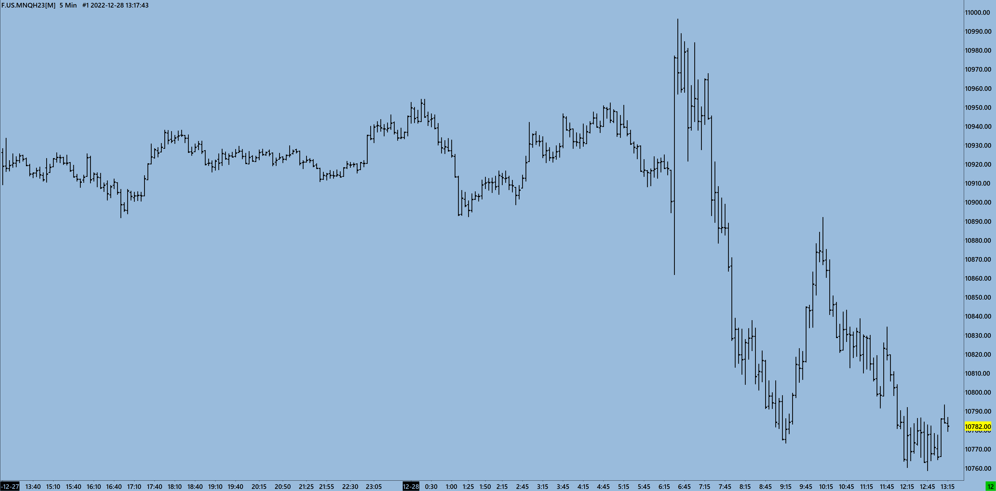

Mike_S - Posts: 42
Bar Close and Bar Open colors are not not changing whether I am in Global graphic settings or chart graphic settings. I submitted a pic of when I am linked to Global graphics, I can change the width of the close but the color does not change. I did not use Sierra Charts screen shot as I wanted to add both settings for your viewing.

The particular coloring you need to choose depends on the Bar Type that you have selected. If you are viewing an OHLC type of bar, then you would select the "Bar" coloring options, otherwise if you are viewing a Candlestick type of bar, then you would change the "Candlestick" options.
We are not sure how you have those bars displayed, as the standard displays do not look like what you are showing, so we do not know which coloring option you should use.

Mike_S - Posts: 42
When you open up a fresh copy of Sierra chart, there is a chart with OHLC bar, or maybe a HLC bar, with the close of the bar highlighted in a bright golden color. In this case, the "Bar Close" and "Bar Open" settings do nothing for the open and close colors of the OHLC bar which are colored by the "Bar-High-Low up and down" colors

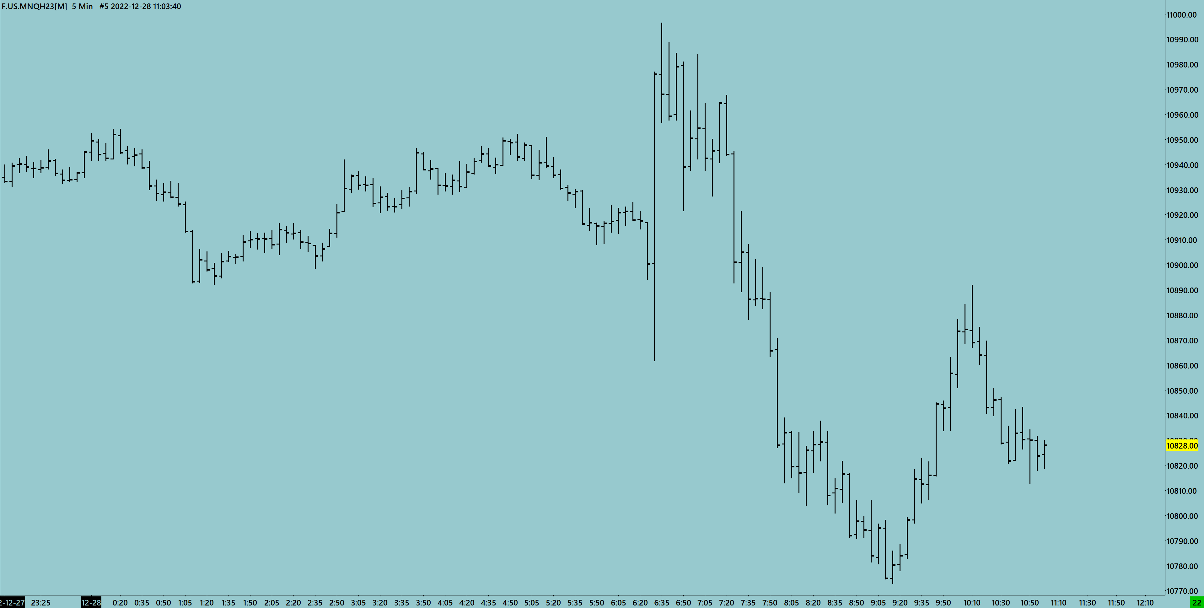

Mike_S - Posts: 42
https://www.sierrachart.com/image.php?Image=1672247148642.png

Mike_S - Posts: 42
https://www.sierrachart.com/image.php?Image=1672254222107.png

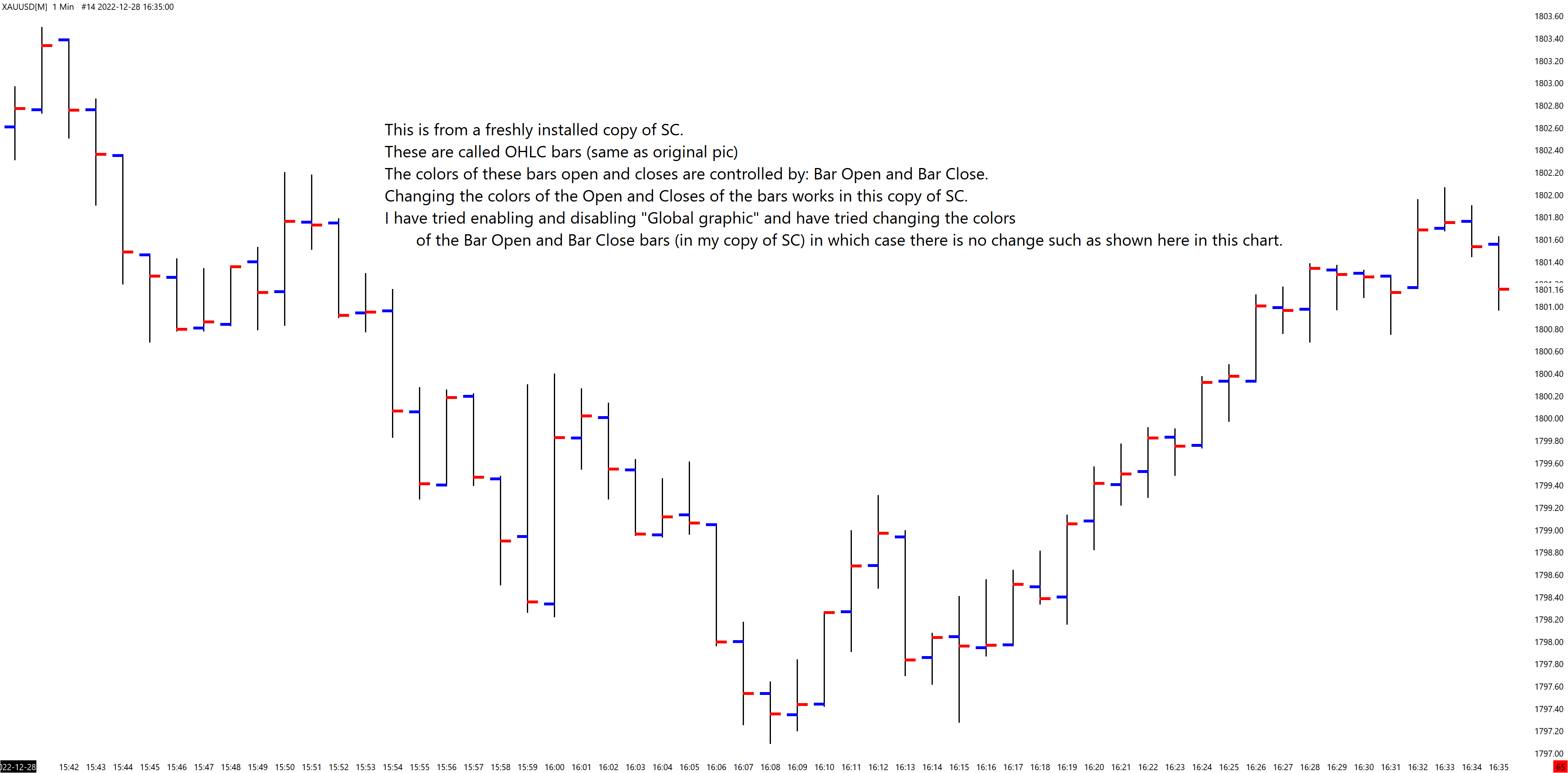

Mike_S - Posts: 42
Sorry, misunderstood the last request.
Just FYI, I have already imported a chartbook to the fresh install of SC and the problem was no longer there. The Open and Close of the OHLC bars were colored as they should have been in the other copy of SC. Maybe something is messed up in one of my files. I tried updating to the pre-release but that did not fix the problem either.
