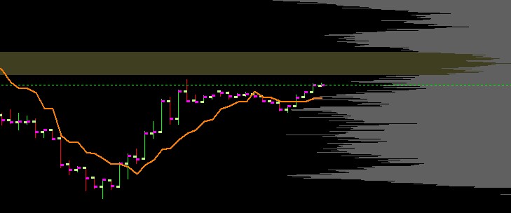

I have a chart in a chartbook I want to move to another chartbook. This chart is not linked to any charts and its not overlayed with any studies from other charts. It's a 3 year volume profile on the right, and 15m candles (I switch between OHLC and Candlestick Bars).

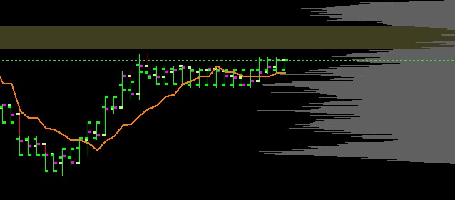

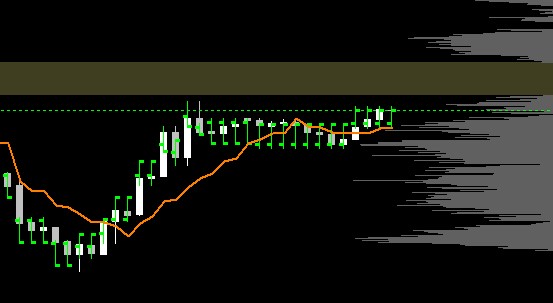

If I copy this chart to a new chartbook, it looks and works fine. If I copy this chart to an existing chartbook with other charts in it I get these strange green OHLC looking bars over my candles. Before I go recreate this whole I figured I'd ask and maybe there is a logical solution here.
Thank you all and happy holidaze.
imageworking.jpg / V - Attached On 2022-12-23 02:04:04 UTC - Size: 31.04 KB - 171 views
imagenot working ohlc.jpg / V - Attached On 2022-12-23 02:05:25 UTC - Size: 30.56 KB - 163 views
imagenot working candlestick.jpg / V - Attached On 2022-12-23 02:05:30 UTC - Size: 29.41 KB - 170 views
[2022-12-23 02:47:50]
There must be a study on the chart causing this. Go to Analysis >> Studies and then individually use the Hide option for each one until this goes away:
Chart Studies: Settings and Inputs Tab >> Hide Study
[2022-12-23 02:56:58]
knarf01 - Posts: 49
Thank you! I'm not sure why the 50D MA did that but I hid it, it fixed the candles. I deleted the study and added again and its working.
Resolved!
