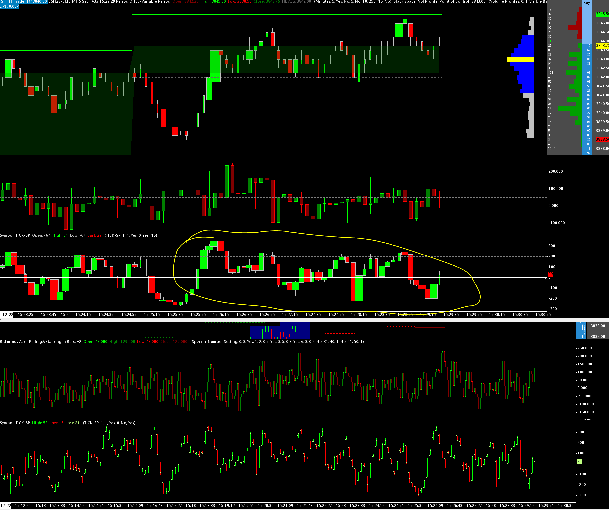

I discovered I love 5 sec bars with the "Candle Price Volume Bars" Option however when adding additional symbol your TICK-SP on the bottom it is also using equivolume bars and looks horrible. I attached a pic with same symbol on another non volume candle based chart and that's how I'd like it to be on my main 5 sec chart.
Can you fix this or add an option to NOT use equivolume on bottom bars. The indicator pane above has same width bar indicator and I'd like the TICK-SP to do the same. What's worse is its constantly enlarging and shrinking and visibly next to impossible to look at!

The Add Additional Symbol defaults to using the same bar type as the main price graph, but you can change this on the Subgraphs tab. At the top is a pulldown for Graph Draw Type. Select the style of bars you want to use for the Add Additional Symbol. Refer to the following:
Chart Studies: Subgraphs Tab >> Graph Draw Type

Perfect thank you so much and for such great and fast support.
