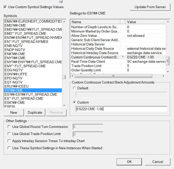

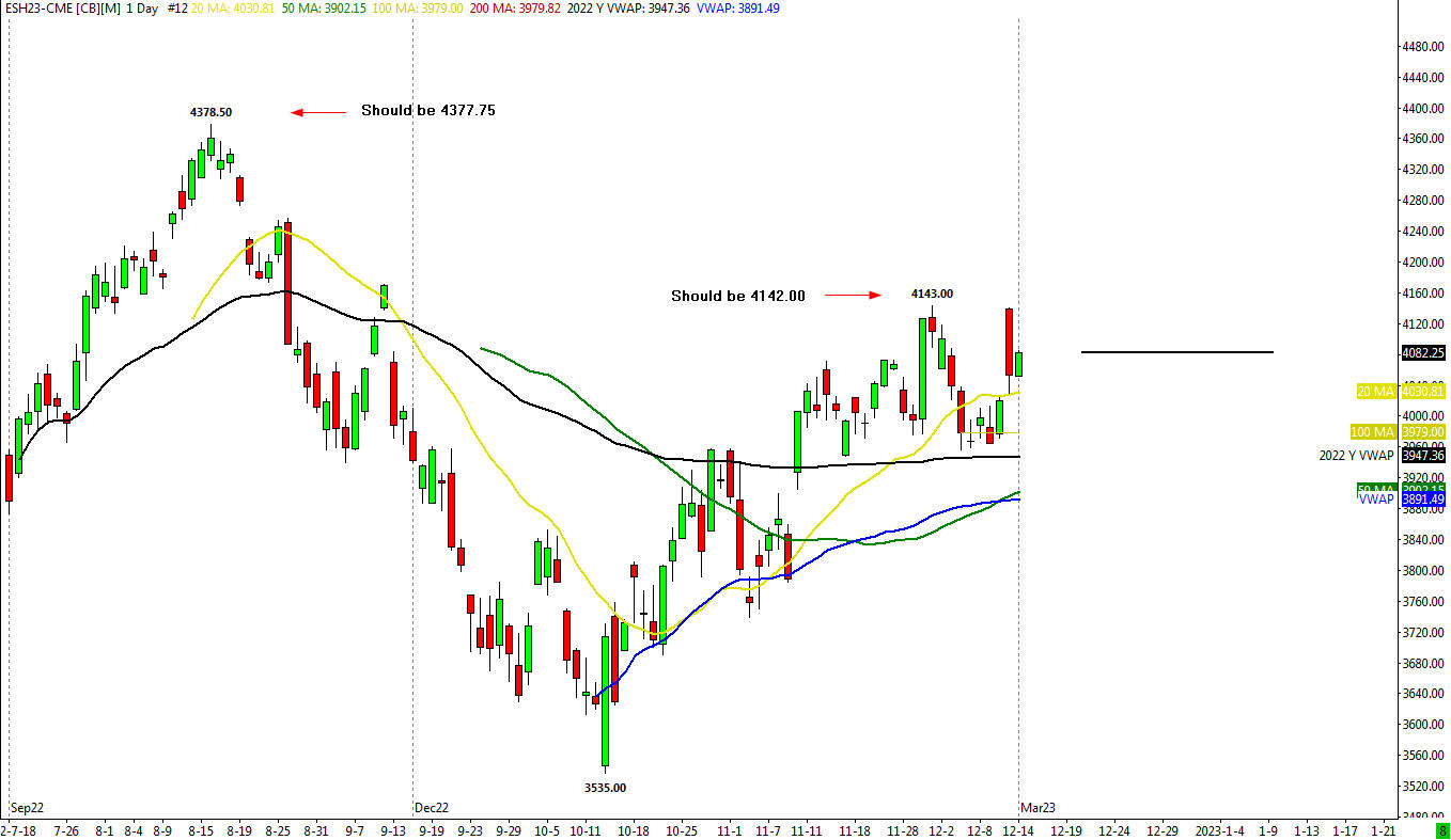

I was with TransAct and now with Denali. When there was rollover
I always had to adjust the charts. I use Continuous Date Back Adjusted.
I am trying to correct data now top no avail.
Would you please look and see if I am doing something wrong?
I am using the new symbol format that was changed when I went to Denali.
PS Truth be told I did not think I would have to make adjustments anymore
since I was with you for Data.
Does it make a difference when you roll? I did it Sunday.
image1mmmmm.jpg / V - Attached On 2022-12-14 16:42:05 UTC - Size: 126.34 KB - 184 views
image1mmmm.jpg / V - Attached On 2022-12-14 16:42:33 UTC - Size: 143.85 KB - 192 views

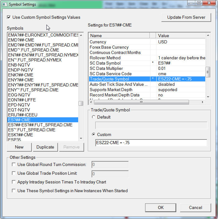

Here is a new snapshot.
I want to adjust ESZ22-CME down .75 or -.75.

[2022-12-16 13:41:17]
That is not the correct setting. Clear the Trade/Quote Symbol setting.
Here is the relevant documentation:
Continuous Futures Contract Charts: Controlling Rollover Amount for Back Adjustments
The setting is: " Custom Continuous Contract Back Adjustment Amounts "
