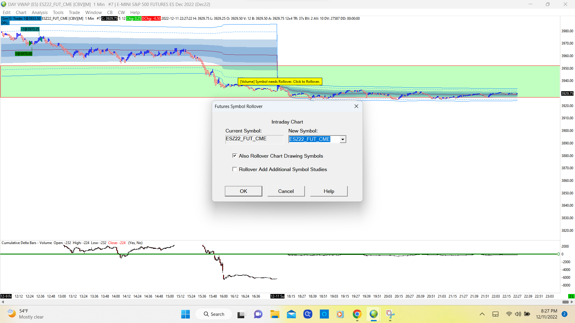

I have performed the symbol rollover but the chart keeps giving me the alert that I need to symbol rollover. I'm getting data on one of my charts but the alert is still in the middle. My other chart is not receiving data.
imageScreenshot_20221211_082726.png / V - Attached On 2022-12-12 18:25:50 UTC - Size: 191.2 KB - 190 views
[2022-12-12 19:03:26]
Note that the chart contract is the default for the right side selection. Therefore, you need to specifically select the pulldown and select the next contract in the list to change over to the next contract.

I was able to get rid of the alert but the chart by following instructions from this link Remove [volume] symbol needs rollover. click to rollover text box
but my second chart is still not receiving data even after reset.

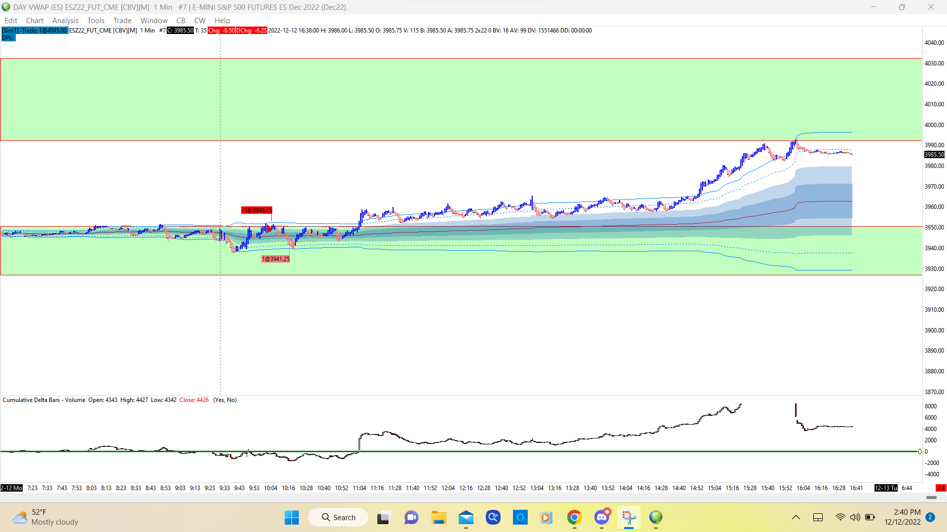

Its the same symbol on both
imageScreenshot_20221212_024008.png / V - Attached On 2022-12-12 21:42:16 UTC - Size: 181.6 KB - 184 views
imageScreenshot_20221212_024008.png / V - Attached On 2022-12-12 21:42:37 UTC - Size: 181.6 KB - 245 views
[2022-12-12 21:49:58]
The image you provided shows the data just fine. We need to see the chart that is not showing the data.

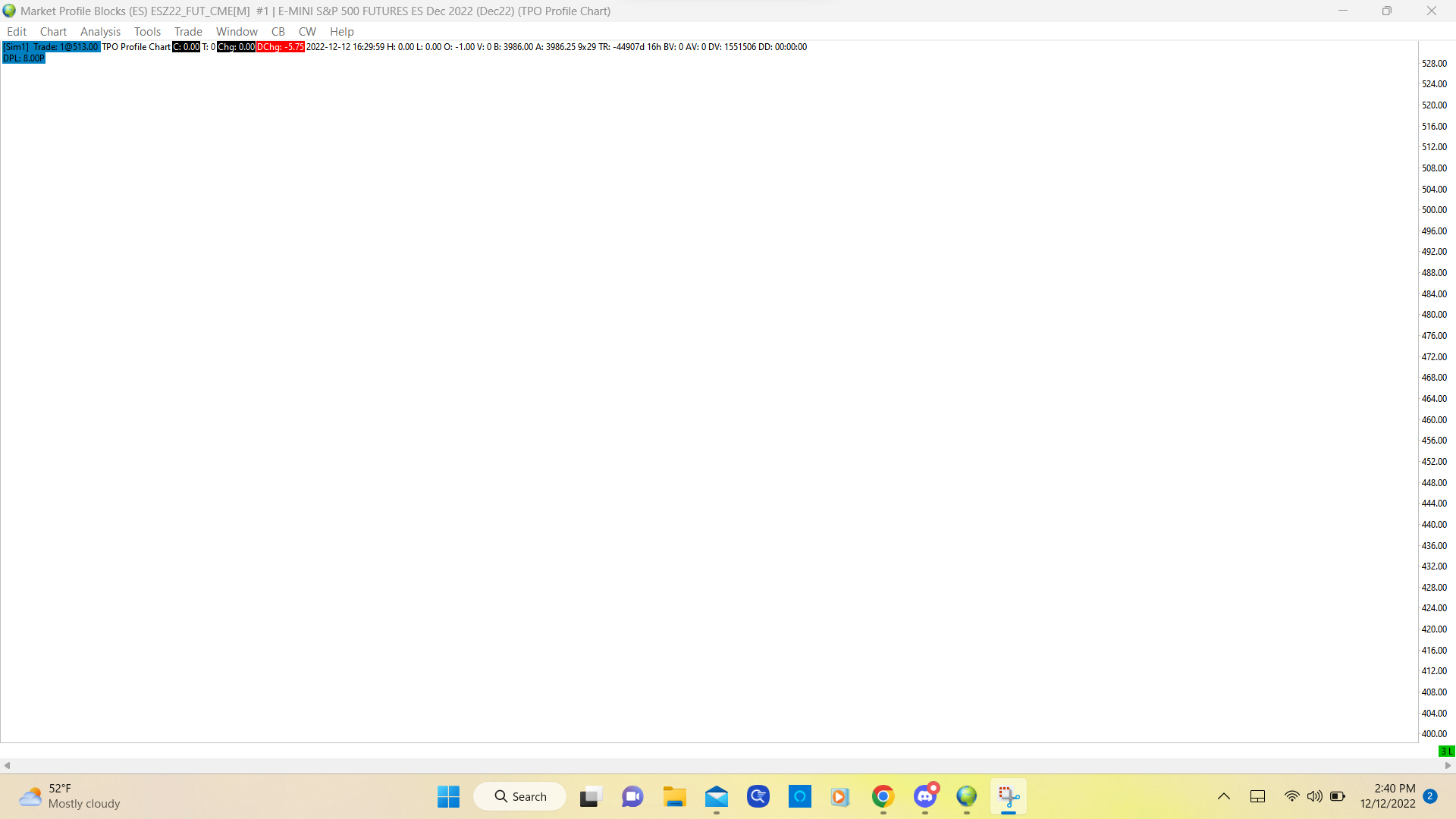

This is the one with no data. It has info on top but when I scroll to the price its not there.
imageScreenshot_20221212_024045.png / V - Attached On 2022-12-12 22:26:41 UTC - Size: 159.65 KB - 309 views
[2022-12-13 15:43:53]
You have it listed as a "TPO Profile Chart". If you have the TPO profile on, then that is the problem as you are on Package 10 which does not support the TPO study.

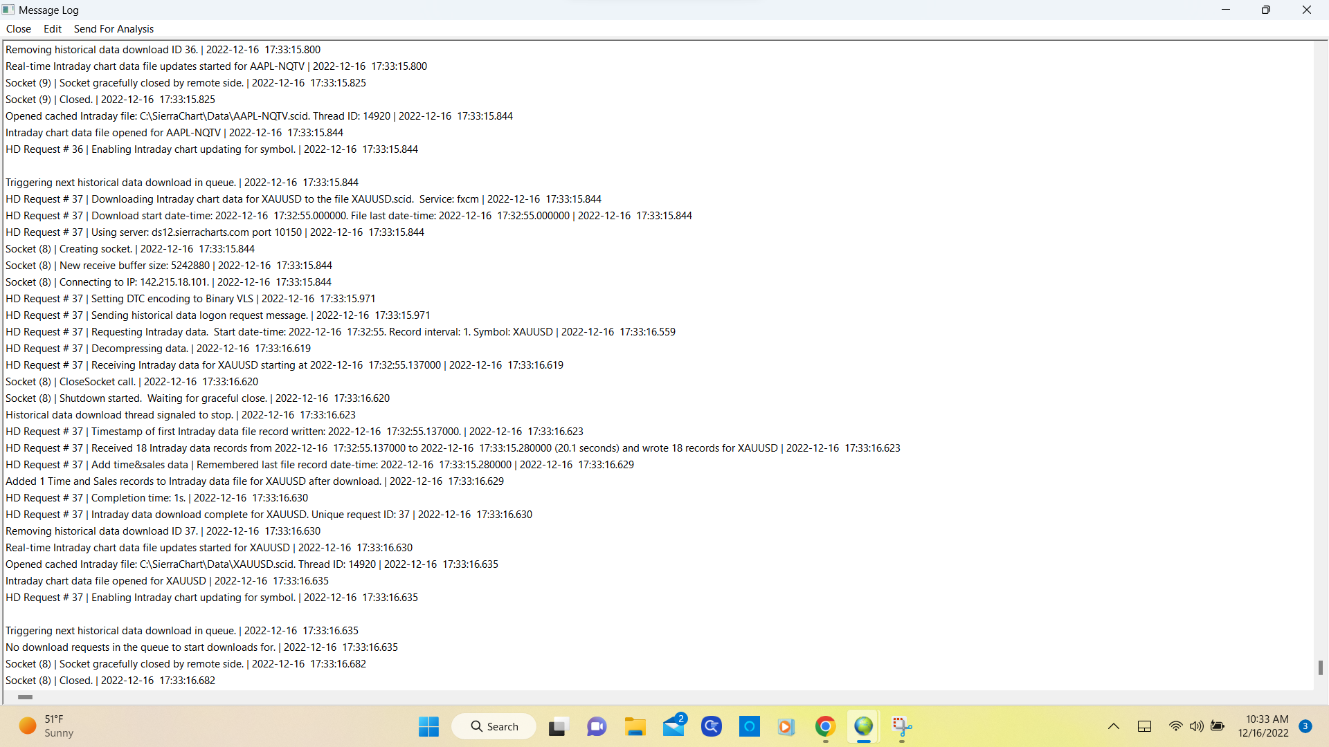

Please give us a screenshot of what you are seeing.
And also go through the following instructions to get us your Message Log:
Open a chart for the symbol you have an issue with. Tell us that symbol of the chart.

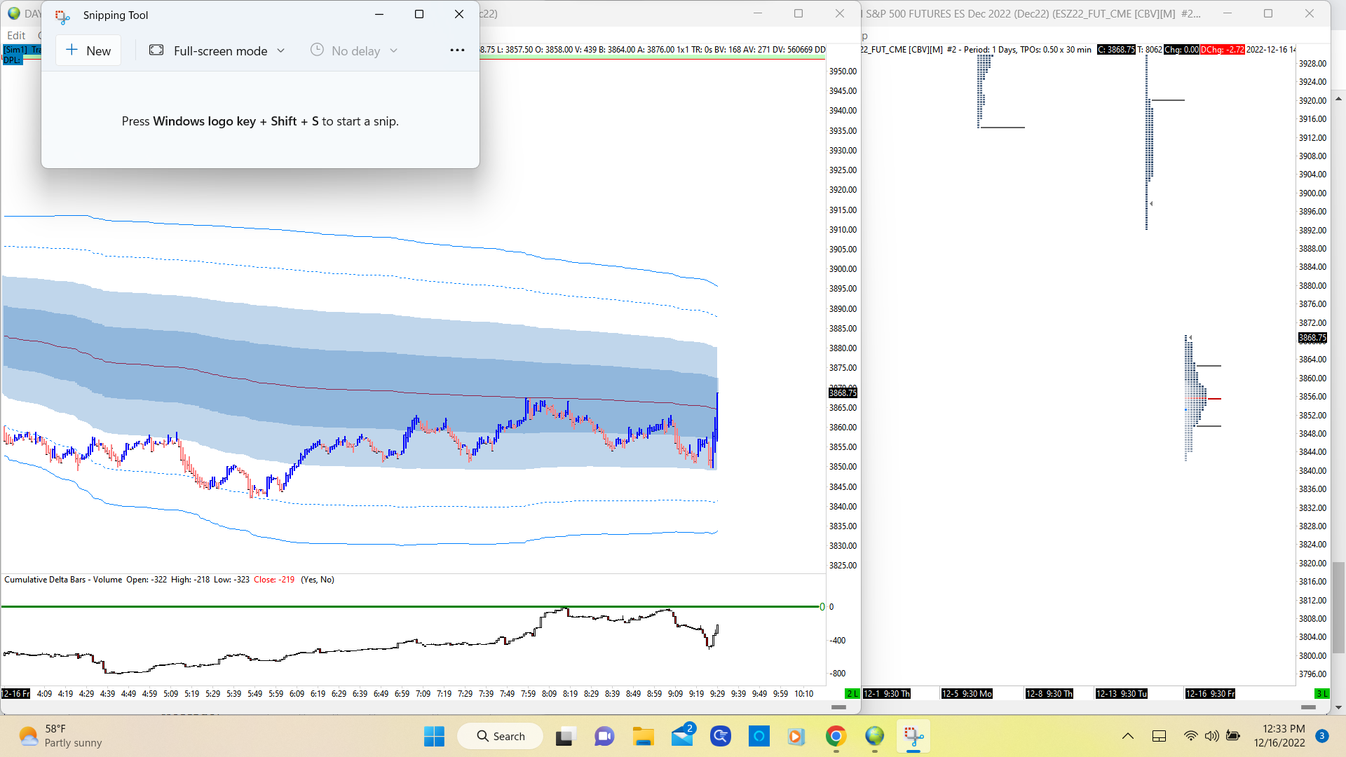

I disconnected and reconnected. The data stops right at the market open as you'll see in the screen shot. The trading symbol is ES (e mini S&P 500)

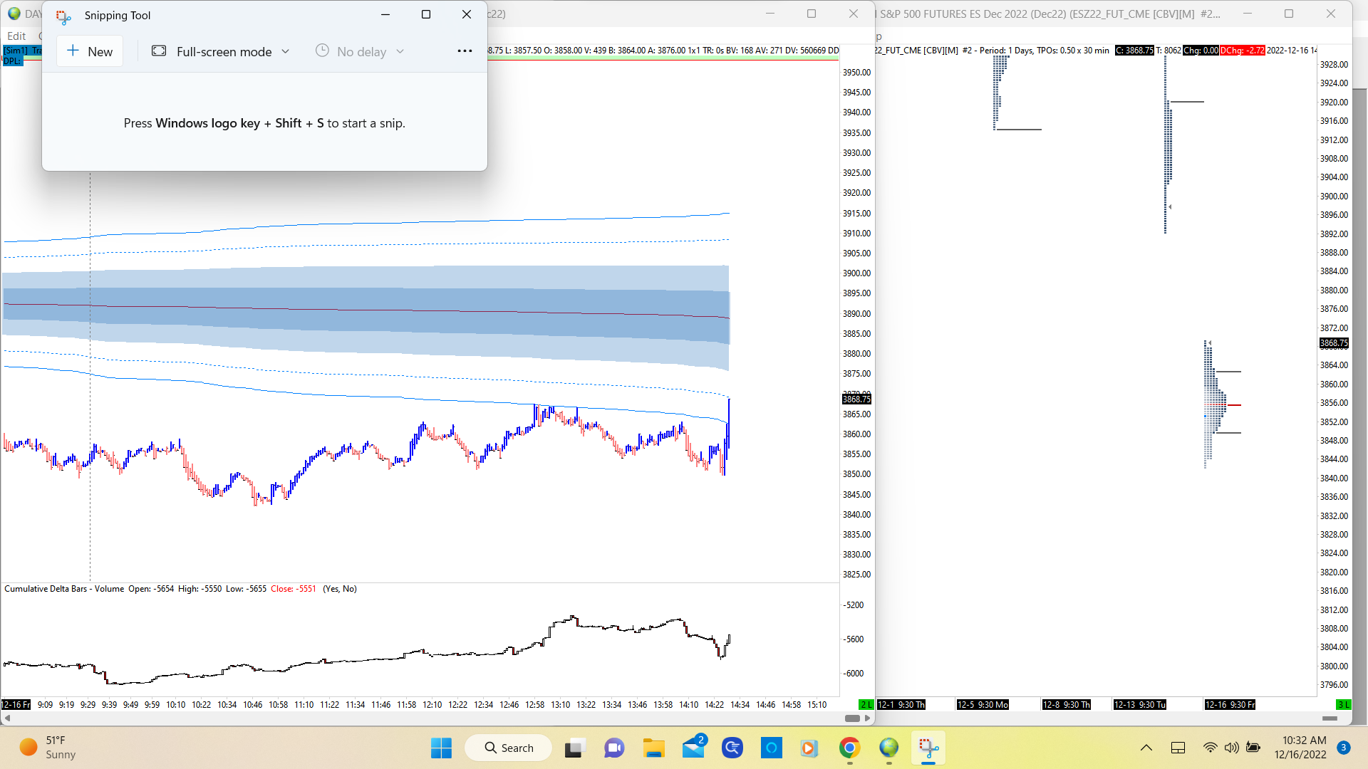

DAVID THOMASHEFSKY - Posts: 17
screen shot of my chart
imageScreenshot_20221216_103236.png / V - Attached On 2022-12-16 17:34:42 UTC - Size: 225.03 KB - 212 views
[2022-12-16 17:50:29]
The image of your charts looks fine. It is showing data from today at the time of about 14:30. We do not know what your Time Zone is set to, but this is much more than the Market Open.
The chart on the right is the TPO chart and it will always show the time as the start of the TPO Profile. That is normal and has not changed. But here again, you have data from the day since you have a TPO profile for today.
