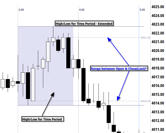

Dear Support,
I need to identify the range between the highest Open and lowest Close within a time period or lowest Open and highest Close.
High/Low is no problem with the "High/Low for Time Period" studies, but does not help me here.
Please see attached image for more details.
Is there any other function / study I missed that could accomplish that?
Or would that be a enhancement for the "High/Low for Time Period" studies.
Thanks for your help.
BR Jens M.
imageSnapshot OPEN CLOSE study question.png / V - Attached On 2022-12-12 07:21:13 UTC - Size: 55.33 KB - 323 views
[2022-12-12 17:56:59]
The High/Low for Time Period is the study to use. Just change the Input for Input Data High to Open and Input Data Low to Close to get the highest open and the lowest close.
Then use another copy of the study with those Inputs reversed to get the Highest Close and Lowest Open.

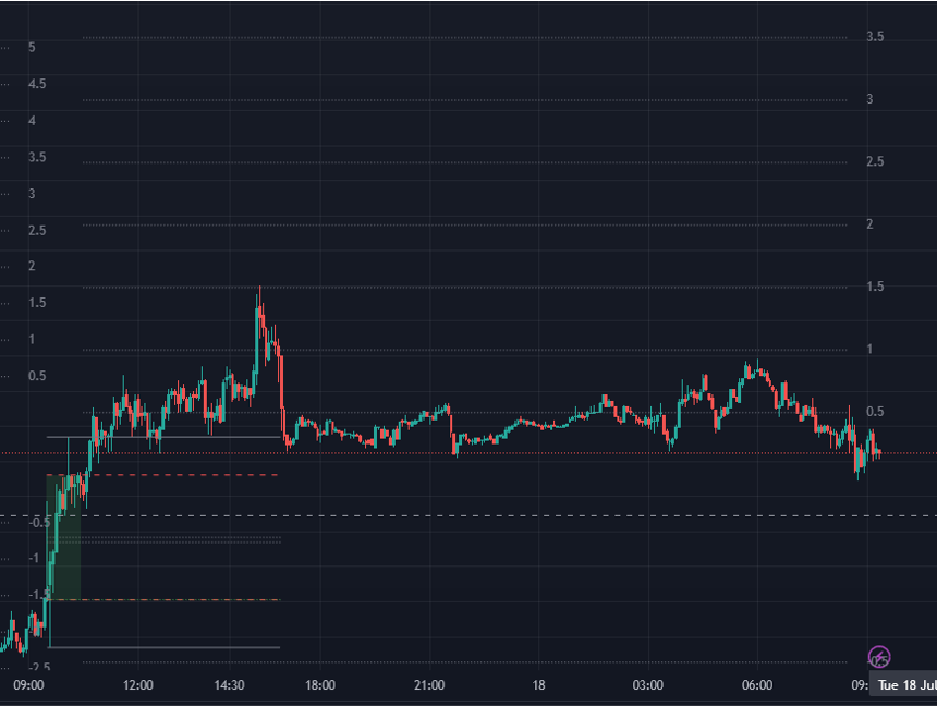

One thing I was struggling with was to create the DR IDR Extension Target Lines. Their calculation is based on the Standard Deviations of the Range b/w the IDR High & IDR Low (For the Regular NY session). 10 lines are plotted above that in 0.5 increments - starting at 0.5 till 5 Std deviations. Similarly, 10 lines are plotted on the negative side, starting at -0.5 till -5 std Dev.
While I'm able to use a Price Projection Tool temporarily - this is manual, and quite laborious. Backtesting with this is very cumbersome too.
I explored various Studies in SC like Std Deviation Bands, Pivot Points, etc., but was quite lost on how to achieve this.
Any pointers?
I've attached 2 screenshots from a Trading View Indicator which illustrates this. The output is similar to what Pivot Points lines look like, but they are based on the calculation described above.
Many thanks
imageDR IDR Std Deviation Target Lines - Positive.png / V - Attached On 2023-07-18 13:35:03 UTC - Size: 91.91 KB - 257 views
imageDR IDR Std Deviation Target Lines - Negative.png / V - Attached On 2023-07-18 13:35:12 UTC - Size: 84.25 KB - 276 views
[2023-07-19 05:16:17]
Sawtooth - Posts: 4361
Since you want to draw 20 lines, use the Spreadsheet Study study.
- Set the Number of Formula Columns to 20 (each column is a subgraph, starting in column K)
- You could use this spreadsheet function in the formulas:
https://www.sierrachart.com/index.php?page=doc/SpreadsheetFunctions.html#STDEV_Function
Working out all of the details is beyond what I can share in a forum post.
Date Time Of Last Edit: 2023-07-19 05:17:52

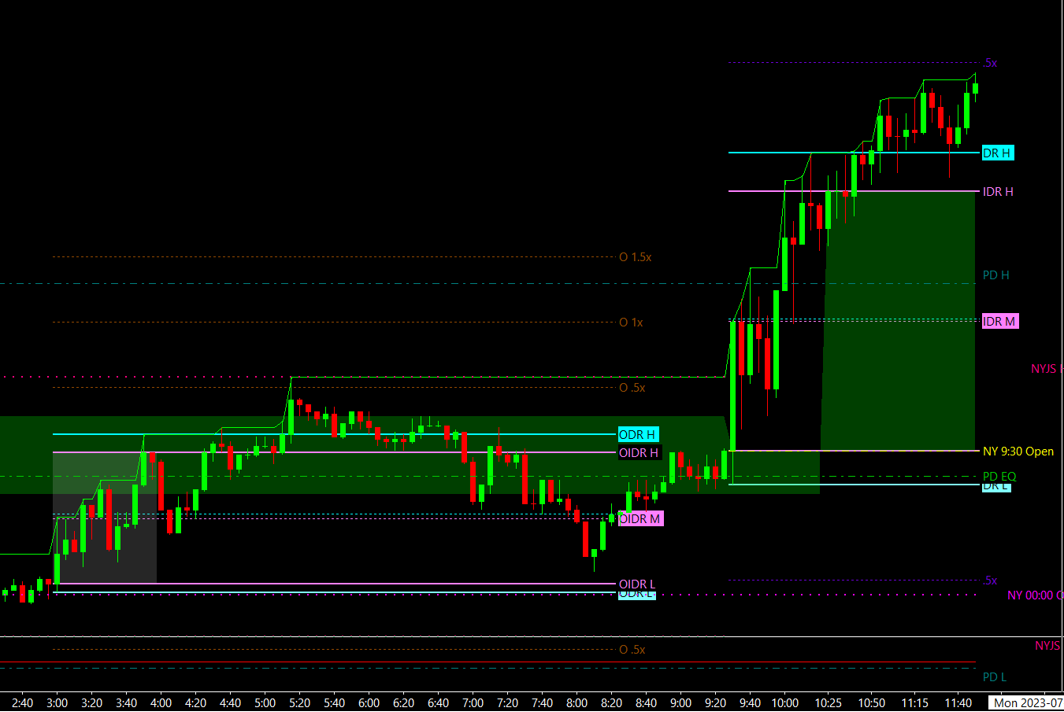

Performed all these steps. I think I'm very close, but something's off. I'm seeing the shading in the Area around and below, but not the intended space (between the IDR, from 930am till 1030am).
I've attached a Screenshot fyi.
I've implemented the following steps:
Step 1. Created 2 new Spreadsheet Formula Studies
ID.86 with this formula in the Formula Field: =IF(AND(BARTIME>=TIME(9,30,0),BARTIME<TIME(9,30,1)),O,ID86.SG1[-1])
ID.87 with this formula in the Formula field: =IF(AND(BARTIME>=TIME(10,25,0),BARTIME<TIME(10,25,1)),C,ID87.SG1[-1])
Step 2. I've then created a new Study Subgraphs Reference Study with:
Input Study 1: ID86.SG1
Input Study 2: ID87.SG1
In the Alerts Tab: I've inserted the following Alert Condition:
=AND((ID87.SG1>ID86.SG1), BARTIME >= TIME(9, 30, 0), BARTIME <= TIME(10, 29, 59))
Subgraphs Tab:
SG1 is set to Transparent Fill Top
SG2 is set to Transparent Fill Bottom
Still not working bizarrely. I guess I'm very close, just something small is off. Any suggestions?
Really appreciate all your help.
Thank you.
imageIDR shading Screenshot.png / V - Attached On 2023-07-24 15:55:30 UTC - Size: 92.29 KB - 256 views
[2023-07-24 17:06:15]
Try these formulas instead:
=IF(AND(BARTIME>=TIME(9,30,0),BARTIME<TIME(9,30,1)),O,IF(ID7.SG1=0,0,ID86.SG1[-1]))
=IF(AND(BARTIME>=TIME(10,25,0),BARTIME<TIME(10,25,1)),C,IF(ID7.SG1=0,0,ID87.SG1[-1]))
where ID7 is the 'IDR time range top' High/Low For Time Period study.
The second IF releases the persistent variable beyond the IDR times.
