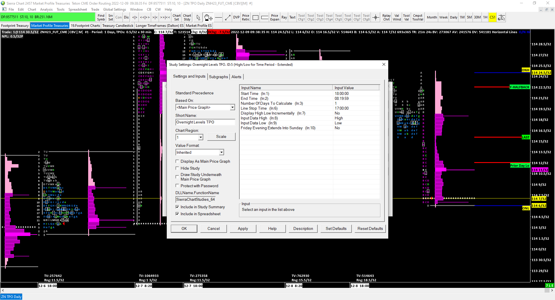

Steve Leon - Posts: 319
I am not sure why but I am having displaying the correct overnight low on this TPO chart. I am not having a problem on the same chart with other instruments. Itried relaoding chart and deleting downloading data
I have the correct open and close times for the sessions in the chart settings
I also believe the high and low study is set up correctly
I am trying to have the overnight low set at the start of the cash open (8:20:00 am est)
Thank you
imageOvernight Low ONL not as expected.PNG / V - Attached On 2022-12-09 14:52:41 UTC - Size: 166.9 KB - 263 views

You can not use the High/Low for Time Period - Extended study on a TPO chart directly. This is true for most studies, due to how the TPO is setup relative to the chart. Refer the following:
Time Price Opportunity (TPO) Profile Charts: Using Other Studies on a TPO Chart
Therefore, you would have to use a separate chart setup the same way, but without the TPO and put the High/Low for Time Period on that chart and then use the Study/Price Overlay to overlay that information to the TPO chart.
Refer to the following for the Study/Price Overlay study:
Study/Price Overlay Study
