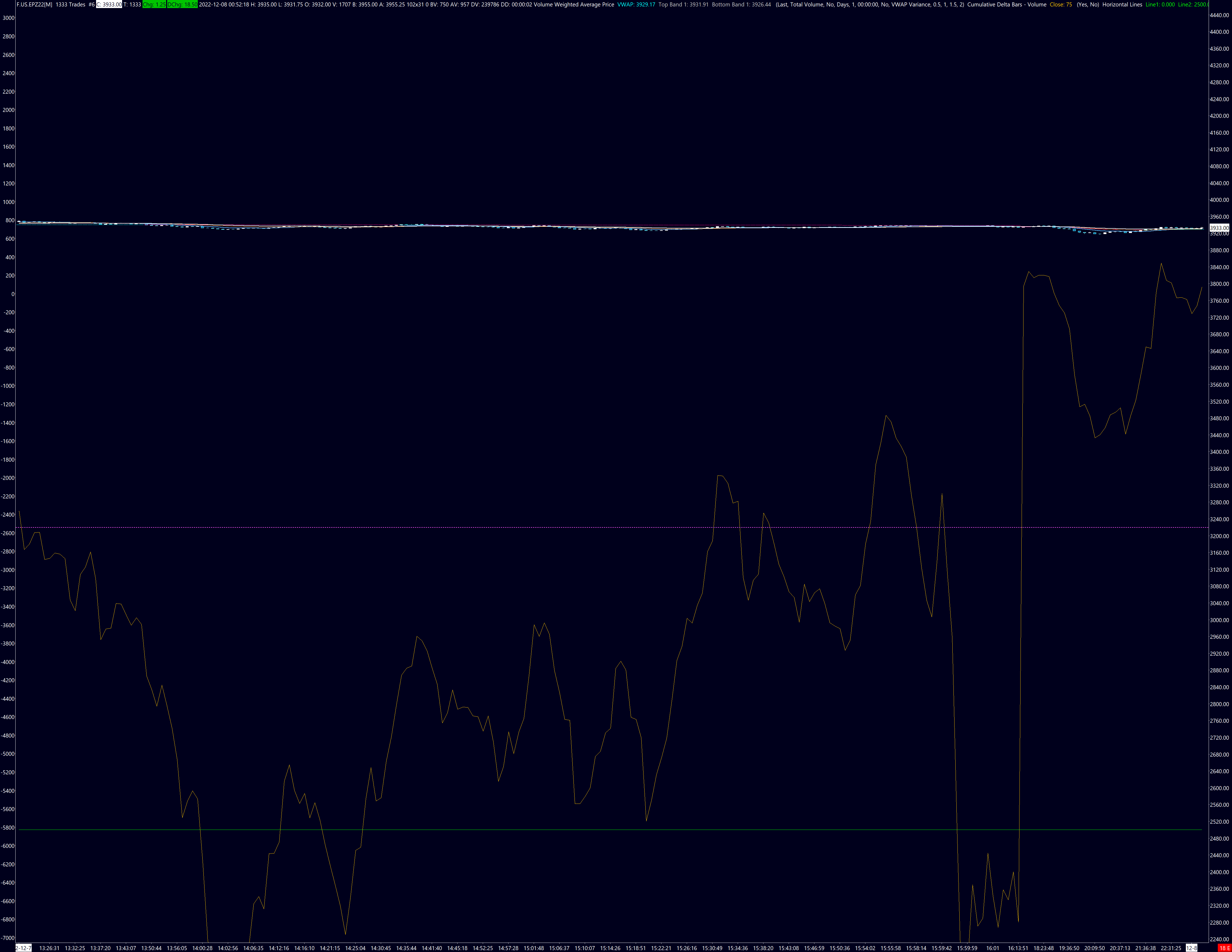

How do you set static horizontal lines to coincide with a study (cumulative delta bars) on left axis? I want lines at different intervals, eg 0, 2500, -2500.
-They are set to 'left axis'
-They are third in line in the studies, behind cumulative delta, which is overlaid in chart region 1
-However, they are still tied to the right axis (tick chart for ES). You can see the tick chart values are compressed
https://www.sierrachart.com/image.php?Image=1670509491482.png
[2022-12-08 14:40:36]
Keep in mind that you can only assign one item to the left-side scales. It looks like you have the Horizontal Lines assigned to the left side properly, based on the range of the scales themselves.
It looks like the yellow/gold line is what is causing the issue. Make sure that whatever is drawing that line is set to a scale of Independent, or "Same as Region", or better yet, put it into a separate region so it will not affect your main price bars.

OK then it sounds like it would be best to flip the multiple items onto the right scale, and the tick chart on the left.
The yellow gold line was cumulative delta which needs the horizontal lines for reference, so I'll put both of those on the right. Thank you.
[2022-12-08 15:34:23]
pete3m - Posts: 15
Not sure if I'm able to do that. It seems the tick chart is be default on the right side, and I cannot override to put cumulative delta on the right.
[2022-12-08 16:20:36]
Sorry, but you are running into a situation that we do not have a solution for. The best option would be to put the Cumulative Delta and Horizontal Lines in a separate Region, or put them in a separate chart (and then set the option for Display as Main Price Graph for the Cumulative Delta and hide the price bars).
