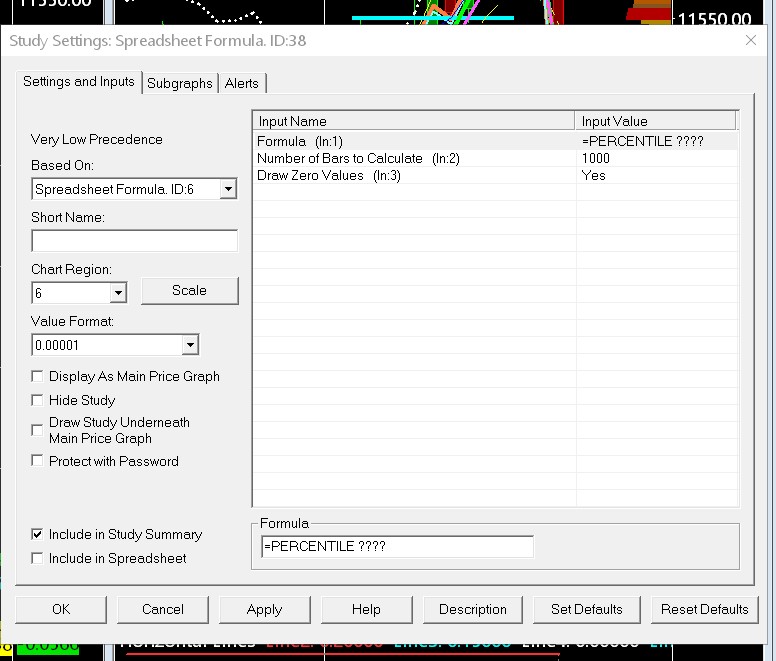

VolTrader73 - Posts: 139
As per my original post here, Im using the spreadsheet formula study please see attached screen
imagePERCENTILE.jpg / V - Attached On 2022-12-08 14:38:44 UTC - Size: 101.55 KB - 334 views
[2022-12-08 14:51:57]
We just tested the Spreadsheet Formula for the Percentile function and although it is not giving a syntax error, it is giving a different result from what the Spreadsheet Study gives. Therefore, we can only say that you should only use the function with the Spreadsheet Study, which is where it was developed for use.
