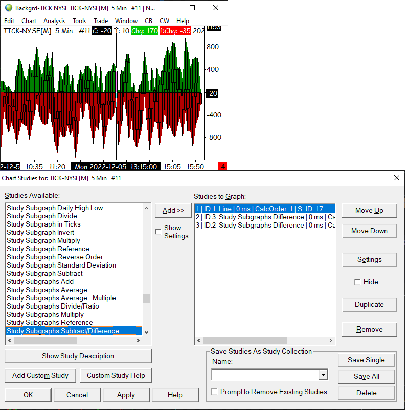

[2022-12-07 22:57:03]
DCSaba - Posts: 124
Thank you!
I have used your link to build the first scratch of what I meant I since a picture is worth a thousand words I attach it.
imageUntitled.png / V - Attached On 2022-12-07 22:56:50 UTC - Size: 60.65 KB - 195 views
[2022-12-07 23:28:32]

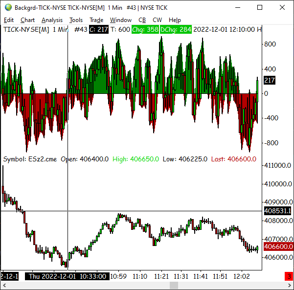

[2022-12-08 15:17:43]
DCSaba - Posts: 124
Well, I attach another picture to demonstrate form last Thu. (instead of a thousand words :)
It has to be on the 1m and as you see: when NYSE Ticks stubbornly stayed under zero, the ES went down, until Ticks recovered.
It's short term, but useful in that it highlights the otherwise "washed away"message from the candles.
You guys have build a power tool in Sierra.
Thank you again!
