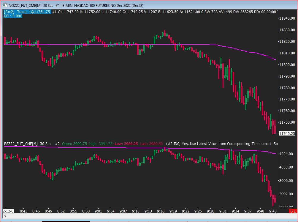

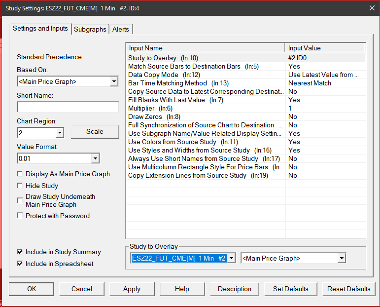

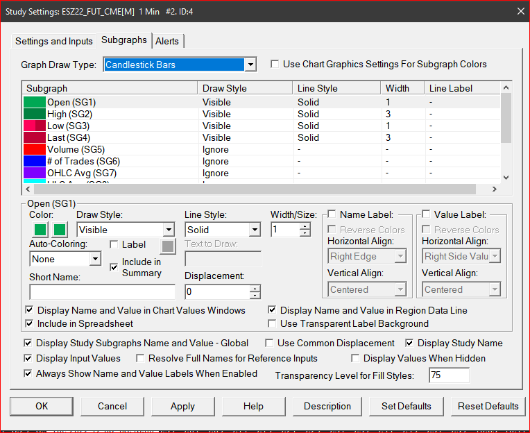

Sawtooth - Posts: 4361
when I try to make Open and Last visible it won't accept the changes and they go back to 'ignore'
You need to overlay the Main Price Graph so that all 4 (OHLC) values will produce a candlestick in region 2.
See attached for my settings.
Then add the VWAP and set its Based On to the overlay study, and chart region 2
Now you have Region 1 with NQ and its VWAP, and Region 2 with ES and its VWAP.
Now you can reference Region 1's Close and VWAP with C, ID#.SG1
and Region 2's Close and VWAP with ID#.SG4, ID#.SG1
BTW, there are no occurrences where both the NQ and ES cross their VWAPs in the same bar.
