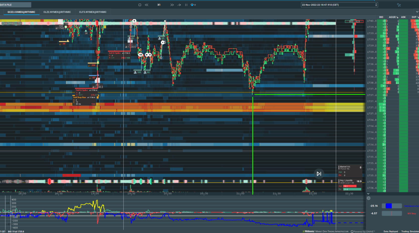

I just noticed in Sierra Chart Replay Mode with Denali feed, market data doesn't match with Bookmap connected with Rithmic feed. Candle at 20:45 indicates level is touched, low is 1737.6. Bookmap shows this scene roughly 25 minutes later.
What may cause this?

First thing to understand is this is a Continuous Futures Contract chart. So make sure you know what particular contract month you are looking at, at a particular bar in the chart:
Continuous Futures Contract Charts: Displaying Rollover Transition Times and Contract Months
And also make sure the time zone is correct:
Time Zone Setting
And refer the information here if there is any missing data:
