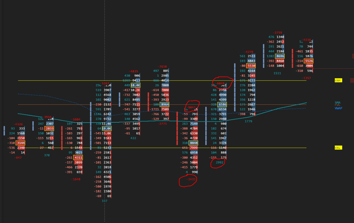

sorry if it's been asked before, but how do I enable pullback delta that is above and below a bar?
something like this
imageCapture.PNG / V - Attached On 2022-11-26 18:04:20 UTC - Size: 145.67 KB - 521 views
[2022-11-28 16:39:03]
The High and Low Pullback Delta is available in the Numbers Bars Calculated Values study. You can add the study to the chart and then hide it if you do not want to see this study. Refer to the information here:
Numbers Bars: Displaying Numeric Information Below Numbers Bars
Then use the Study Subgraph Above/Below Bar as Text study to display the information above/below the numbers bars. You will need two copies of this study to display both sets of data. Refer to the following:
Also be sure to enable the following setting:
Chart Settings: Historical Pullback Data (Chart >> Chart Settings >> Chart Data >> Chart Data menu)
