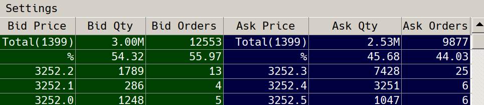

is the maximum support for market depth in sierrachart up to 1399 levels? When used as a DTC client, if specify a number greater than 1400 in 'Max Depth Levels (Global Settings >> Sierra Chart Server Settings >> General >> General)', although the log correctly displays the number I entered, the actual request sent out is 0, and i have tried ignoring this message and directly sent 2000 levels, but it still shows 1399, also for the 1399 level order book, do I need to first perform 'MARKET_DEPTH_INSERT_UPDATE_LEVEL' before 'MARKET_DEPTH_DELETE_LEVEL' when updating information?
imagescreenshot-20240424-172624.jpg / V - Attached On 2024-04-24 09:26:38 UTC - Size: 36.13 KB - 492 views
[2024-04-25 14:47:35]
Sierra_Chart Engineering - Posts: 25481
It is 1400 levels. Maybe though you can only get 1399. We would have to check on that.
We are not able to answer this. You need to do what makes sense:
Date Time Of Last Edit: 2024-04-25 14:48:07

d9e5c763 - Posts: 112
in the recent version, 2800 levels can be displayed correctly now.
previously, my comment was incorrect, what I meant was, if now have a 2800 levels order book and I first send a "MARKET_DEPTH_INSERT_UPDATE_LEVEL" message, and if this price level is beyond the existing 2800 levels, then the actual count of levels in the order book will be 2801, this may lead to issues, I might need to send some number of "MARKET_DEPTH_DELETE_LEVEL" messages to reduce the order book to within 1400 levels before executing "MARKET_DEPTH_INSERT_UPDATE_LEVEL", however, this approach is not optimal, instead, I should maintain a local order book with 2800 levels and generate corresponding update messages based on changes
btw, are there any plans to increase the limit from 2800 to higher in future versions?

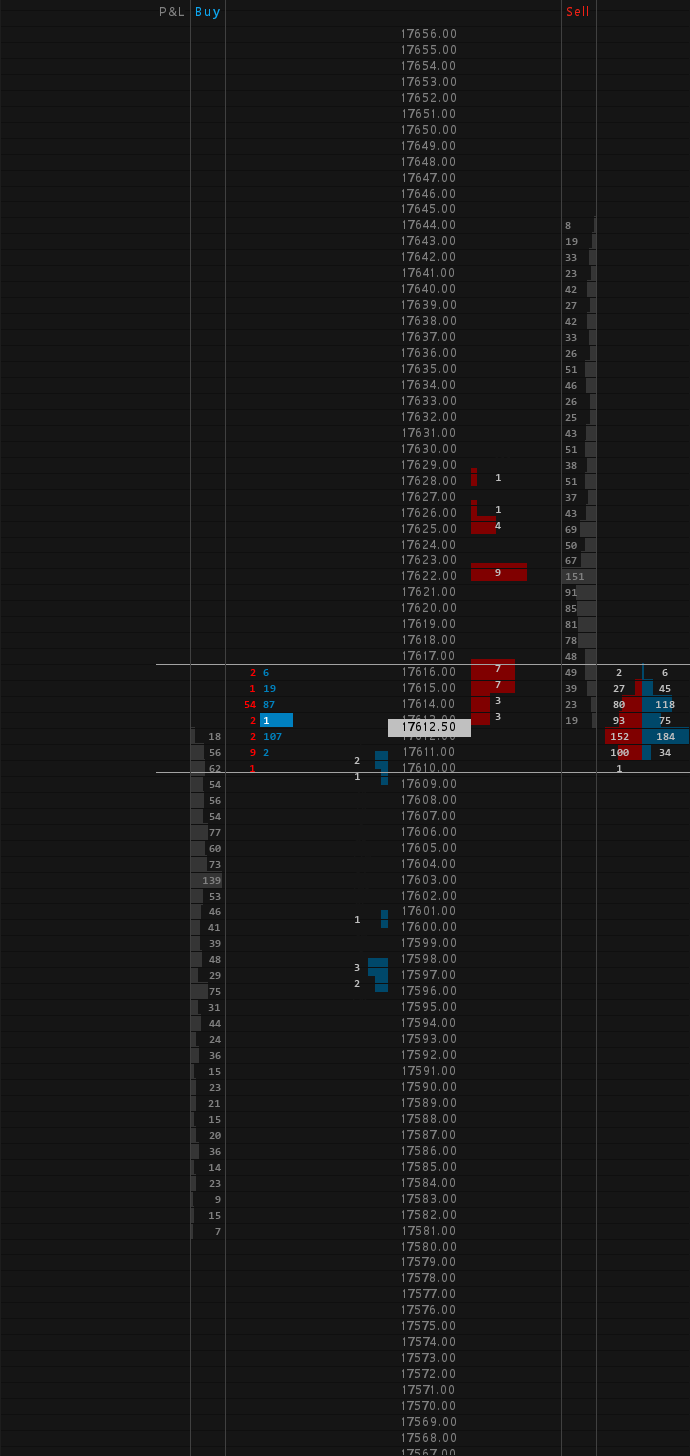

Hi, sorry to come back to this issue. In the DOM, with tickers NQ and ES, I am unable to display DOM with 0.25 tick size (although shown in the chart settings, see example please below). How can I change it to present the DOM as it should be in 0.25 increments instead of regular numbers which does not make sense? Many thanks
[2025-05-25 18:34:46]
User198125 - Posts: 40
@epinay197
Have you tried right clicking on the price scale, then 'Scale increment' = 0?
[2025-05-25 18:58:16]
epinay197 - Posts: 56
you're the man/woman/non binary (hopefully I am not offending anyone:))
Many thanks, it works

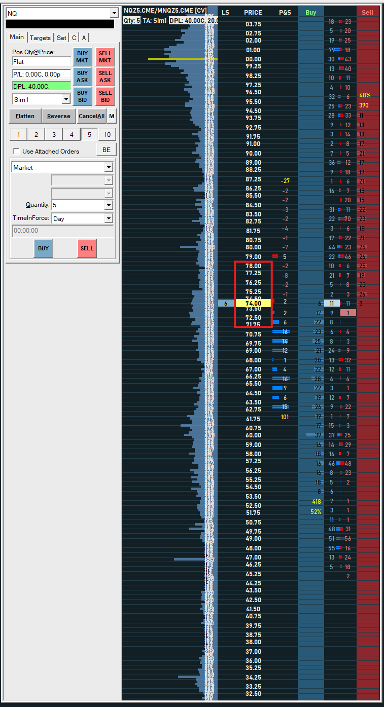

I tried to aggregate the DOM and the Nasdaq charts as suggested in the guide, but as you can see from the image and the provided chartbook, the price now shows only two digits before the decimal point instead of five. In other words, it displays 82.75 instead of 25082.75. How can I fix this error?
Please could you kindly help me?
Thank you
Claudio
imageDOM_NQ.png / V - Attached On 2025-10-22 16:13:11 UTC - Size: 180.69 KB - 191 views
attachmentDOM_NQ.Cht - Attached On 2025-10-22 16:13:15 UTC - Size: 4.6 KB - 169 views
[2025-10-22 16:27:18]
@User757816
Click On Chart-->Chart Setting --> [Display]-->"Limit price display to N Right characters" = Set this to 0 for default or whatever number of digits you wish to see.
