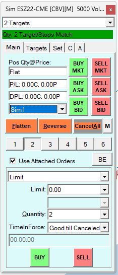

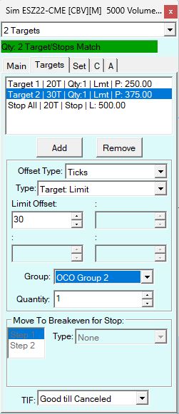

I'm still getting the same issue but now it seems that the Stop trigger is disappearing when the price is nowhere near it. I enclosed JPEGs of my Trade window under the Main and Target tabs. I used a config file named "2 Targets" with the settings shown in the "Target_tab" JPEG. When I enter a trade by hitting either the "BUY MKT" or "SELL MKT" button, 4 horizontal lines appear as expected (2 target lines, 1 stop line, 1 entry line). Next, I usually immediately manually move the 2 targets and 1 stop line. This obviously changes the initial tick sizes of 20 and 30 (as shown in the config window in the "Target_tab" JPEG). The JPEG name "stop_change" is an example of what happens when when I manually change the stop. It looks like Sierra acknowledges it. But, after a minute or so, the stop line disappears. I don't know what setting I need to fix this. Let me know if you need more information from me.

[2022-12-02 15:33:04]
All of this information is not helpful to us.
You need to look at the Trade Activity Log and see what has happened to that particular Stop order:
Trade Activity Log: Viewing Historical Trade Activity
