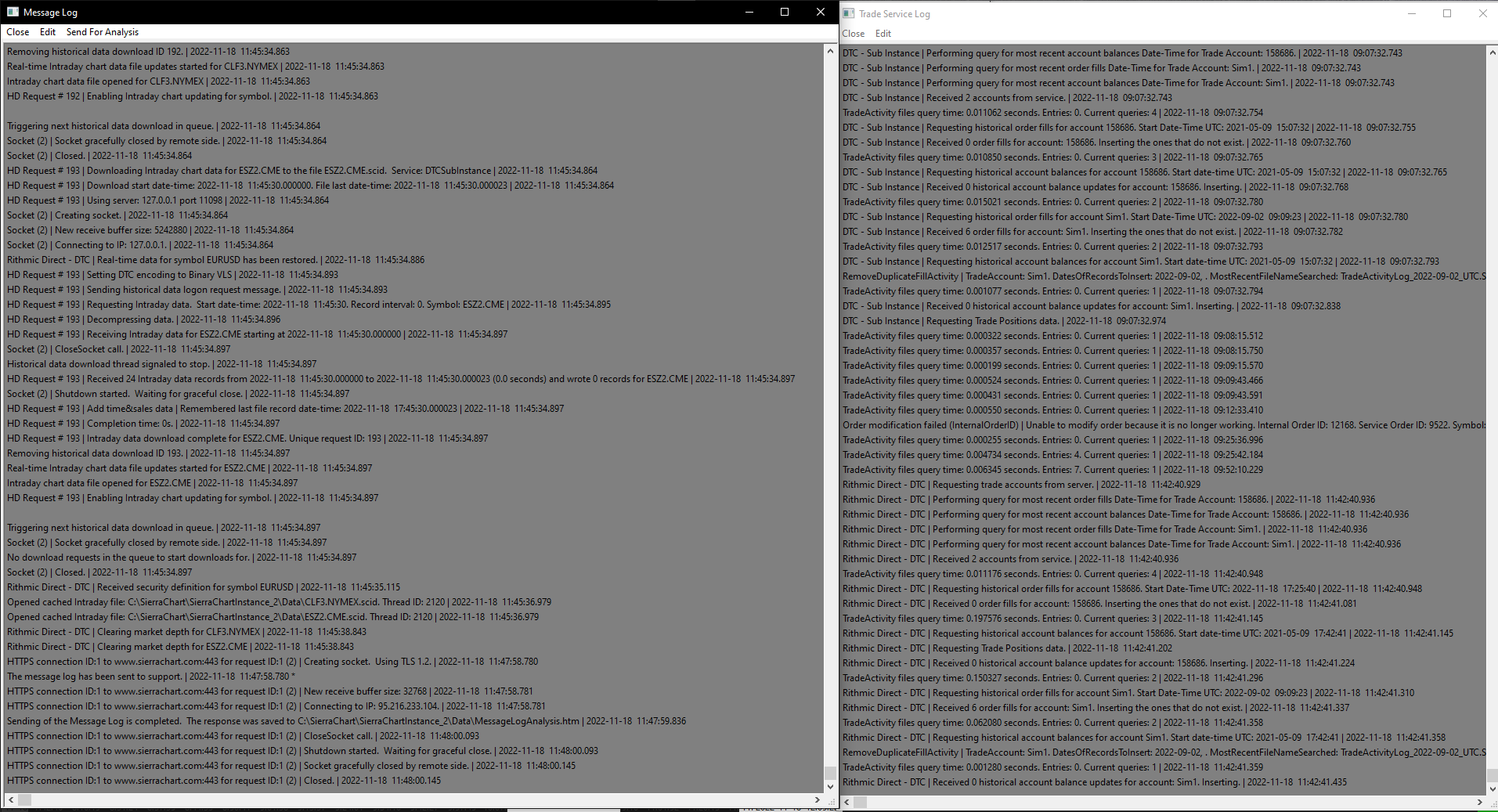

[2022-11-18 16:50:25]
We can not help with historical data from Rithmic. But is it correct that you are not getting any data from your connection?
If this is the case (you are not getting any data), then please get us your Message Log by following these instructions:
Open a chart for the symbol you have an issue with. Tell us that symbol of the chart.

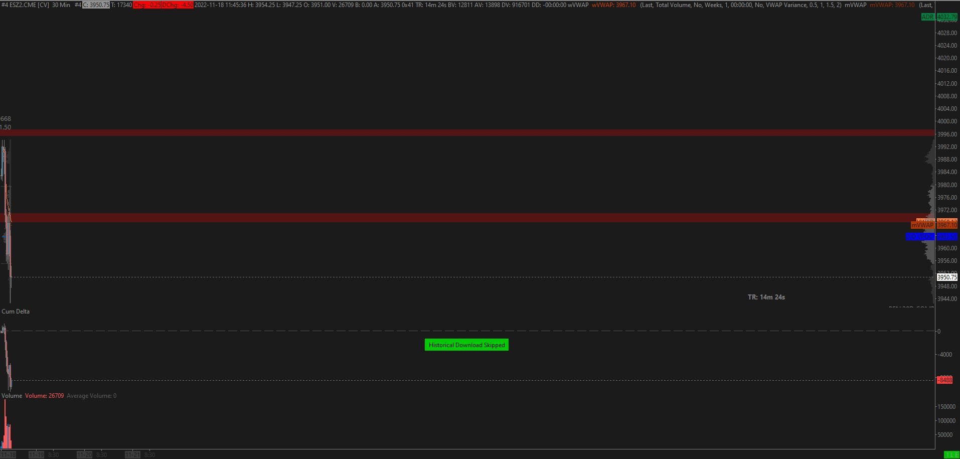

I send you the message log, also atached you have 2 screen captures, one from the chart (you can see it ony downloaded data since I opened the platform) and another one from the message log and the trade log.

[2022-11-18 18:03:52]
You are getting the data since you opened the platform, therefore the only issue you have is that you are using Rithmic data. Refer to the information at the following link regarding Rithmic data:

[2022-11-18 20:39:09]
Make sure you have set the Rithmic Username and Password for Historical Data in Global Settings >> Data/Trade Service Settings >> Service Settings.
Looks like they might not be set if you see that the download has been skipped.
