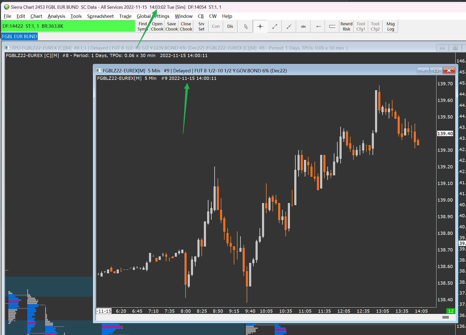

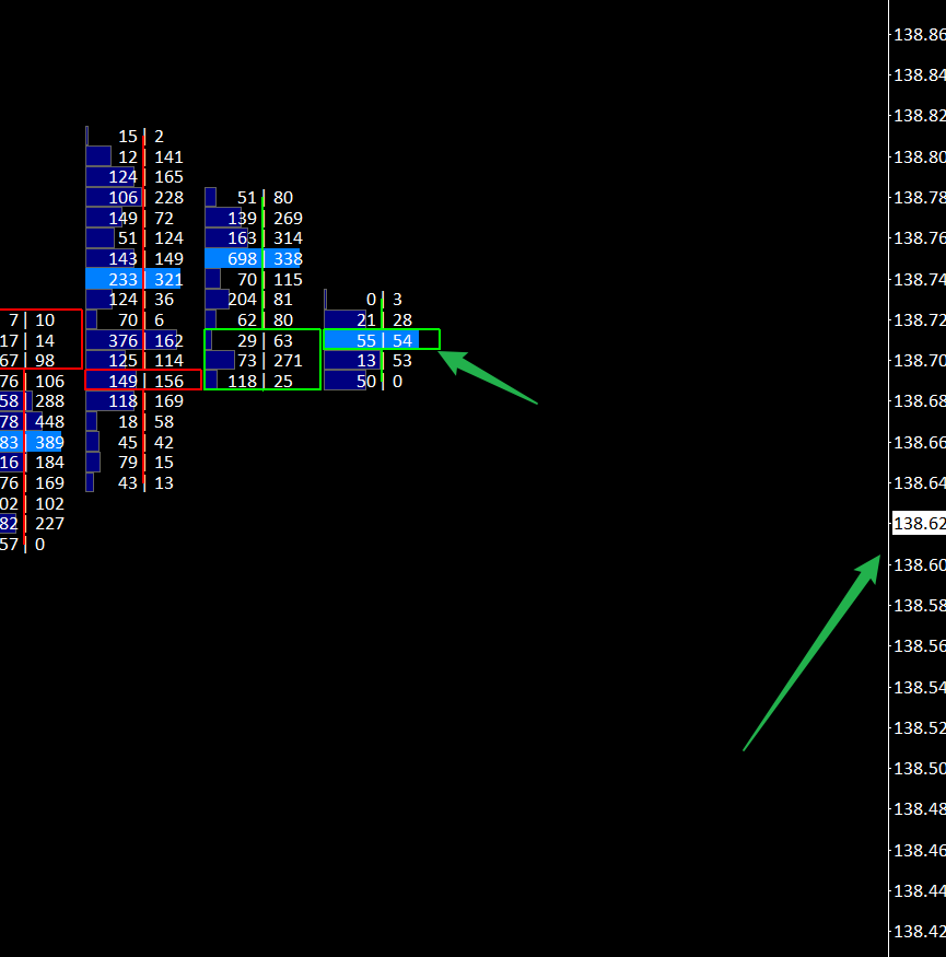

I am using the SC Data data feed, but the current price and candlestick are out of sync
View Count: 913
[2022-11-15 08:31:58]
zxmmmmmm - Posts: 10
I am using the SC Data data feed, but the current price and candlestick are out of sync and the candlestick is lagging behind.
When I reconnect to the data feed, it updates the candlestick that is behind and then there is a delay again.
imageSnipaste_2022-11-15_16-31-28.png / V - Attached On 2022-11-15 08:31:47 UTC - Size: 34.9 KB - 288 views

Current selected Data/Trading service: SC Data - All Services | 2022-11-17 08:45:41.899
Custom symbol settings values: disabled | 2022-11-17 08:45:41.899
Chart Update Interval: 300 | 2022-11-17 08:45:41.899
Intraday Data Storage Time Unit: 0 | 2022-11-17 08:45:41.899
Time Zone: +01:00:00 (CET+01CEST+01,M3.5.0/02:00,M10.5.0/03:00) | 2022-11-17 08:45:41.899
2022-11-17 07:45:41 Local computer time in UTC | 2022-11-17 08:45:41.899
2022-11-17 08:45:41 Local computer time in SC Time Zone | 2022-11-17 08:45:41.899
2022-11-16 08:45:42 Server time in UTC | 2022-11-17 08:45:41.899
Local computer UTC time and Server UTC time difference: 1 seconds. | 2022-11-17 08:45:41.899
Program path: D:\SierraChart\ | 2022-11-17 08:45:41.899
Data Files path: D:\SierraChart\Data\ | 2022-11-17 08:45:41.899
OS Version Number: 10.0 | 2022-11-17 08:45:41.899
Locale Setting: C | 2022-11-17 08:45:41.899
DLLs: UserContributedStudies_64.dll | 2022-11-17 08:45:41.899
Allowed protected custom studies: | 2022-11-17 08:45:41.899
Crash reporter started: true | 2022-11-17 08:45:41.899
Saved Chartbook: FGBL EUR BUND.Cht. Time: 0.0028 seconds. | 2022-11-17 08:45:45.645
File >> Disconnect selected. | 2022-11-17 08:46:37.468
SC DTC Delayed Exchange Data | Waiting for socket receive thread to end | 2022-11-17 08:46:37.470
DTC Client socket (1) | CloseSocket call. | 2022-11-17 08:46:37.471
SC DTC Delayed Exchange Data | Disconnected from the server. | 2022-11-17 08:46:37.471
SC Data - All Services | Disconnected. | 2022-11-17 08:46:37.471
DTC Client socket (1) | Shutdown started. Waiting for graceful close. | 2022-11-17 08:46:37.471
DTC Client socket (1) | Socket gracefully closed by remote side. | 2022-11-17 08:46:37.471
DTC Client socket (1) | Closed. | 2022-11-17 08:46:37.471
SC Data - All Services | Connected to server complete. | 2022-11-17 08:46:40.775
Triggering next historical data download in queue. | 2022-11-17 08:46:40.775
Triggering next historical data download in queue. | 2022-11-17 08:46:40.776
Notice: Not connected to Live trading account to receive CME realtime futures data at non-professional fees. | 2022-11-17 08:46:40.776
No download requests in the queue to start downloads for. | 2022-11-17 08:46:40.778
Mapping FGBLZ22-EUREX to FGBL202212_FUT_EUREX. Service code: eurex | 2022-11-17 08:46:40.923
Using symbol data fast lookup vector | 2022-11-17 08:46:40.923
SC DTC Delayed Exchange Data | Starting real-time market data updates for: FGBLZ22-EUREX (FGBL202212_FUT_EUREX). ID: 1 Service code: eurex | 2022-11-17 08:46:40.923
SC DTC Delayed Exchange Data | Connecting to the server ds24.sierracharts.com. Port 10043 | 2022-11-17 08:46:40.923
SC DTC Delayed Exchange Data | Requesting security definition data for: FGBLZ22-EUREX (FGBL202212_FUT_EUREX). ID: 1 | 2022-11-17 08:46:40.923
Added historical Intraday data request for FGBLZ22-EUREX to the queue. | 2022-11-17 08:46:40.923
Intraday data recording state for symbol FGBLZ22-EUREX is set to download 'Pending'. | 2022-11-17 08:46:40.923
Triggering next historical data download in queue. | 2022-11-17 08:46:40.923
Delaying start of download for FGBLZ22-EUREX. | 2022-11-17 08:46:40.926
DTC Client socket (1) | Creating socket. | 2022-11-17 08:46:52.003
DTC Client socket (1) | New receive buffer size: 5242880 | 2022-11-17 08:46:52.003
DTC Client socket (1) | Connecting to IP: 154.14.194.212. | 2022-11-17 08:46:52.003
SC DTC Delayed Exchange Data | Network connection to server complete. | 2022-11-17 08:46:52.004
SC DTC Delayed Exchange Data | Starting socket receive thread. | 2022-11-17 08:46:52.004
SC DTC Delayed Exchange Data | Sending encoding request to server: Binary VLS. Compression: standard | 2022-11-17 08:46:52.004
SC DTC Delayed Exchange Data | Setting DTC encoding to Binary VLS | 2022-11-17 08:46:52.613
SC DTC Delayed Exchange Data | Sending logon request message. | 2022-11-17 08:46:52.613
SC DTC Delayed Exchange Data | Received logon response. | 2022-11-17 08:46:53.083
SC DTC Delayed Exchange Data | Server Name: SC Realtime Server. | 2022-11-17 08:46:53.083
SC DTC Delayed Exchange Data | Server protocol version: 8. Client protocol version: 8 | 2022-11-17 08:46:53.083
SC DTC Delayed Exchange Data | Successfully connected. | 2022-11-17 08:46:53.083
SC DTC Delayed Exchange Data | Trading is not supported. | 2022-11-17 08:46:53.083
SC DTC Delayed Exchange Data | Restarting real-time data updates for symbol: FGBLZ22-EUREX -> FGBL202212_FUT_EUREX | 2022-11-17 08:46:53.083
SC DTC Delayed Exchange Data | Received security definition for symbol FGBLZ22-EUREX | 2022-11-17 08:46:53.461
HD Request # 14 | Downloading Intraday chart data for FGBLZ22-EUREX to the file FGBLZ22-EUREX.scid. Service: eurex | 2022-11-17 08:46:58.894
HD Request # 14 | Download start date-time: 2022-11-17 08:31:33.000000. File last date-time: 2022-11-17 08:31:33.295003 | 2022-11-17 08:46:58.894
HD Request # 14 | Using server: ds14.sierracharts.com port 10150 | 2022-11-17 08:46:58.894
Socket (2) | Creating socket. | 2022-11-17 08:47:09.979
Socket (2) | New receive buffer size: 5242880 | 2022-11-17 08:47:09.979
Socket (2) | Connecting to IP: 176.9.9.252. | 2022-11-17 08:47:09.979
HD Request # 14 | Setting DTC encoding to Binary VLS | 2022-11-17 08:47:10.613
HD Request # 14 | Sending historical data logon request message. | 2022-11-17 08:47:10.613
HD Request # 14 | Requesting Intraday data. Start date-time: 2022-11-17 08:31:33. Record interval: 0. Symbol: FGBL202212_FUT_EUREX | 2022-11-17 08:47:11.038
HD Request # 14 | Decompressing data. | 2022-11-17 08:47:11.314
HD Request # 14 | Receiving Intraday data for FGBLZ22-EUREX starting at 2022-11-17 08:31:33.223000 | 2022-11-17 08:47:11.324
Socket (2) | CloseSocket call. | 2022-11-17 08:47:11.525
Socket (2) | Shutdown started. Waiting for graceful close. | 2022-11-17 08:47:11.525
Historical data download thread signaled to stop. | 2022-11-17 08:47:11.525
HD Request # 14 | Timestamp of first Intraday data file record written: 2022-11-17 08:31:39.901000. | 2022-11-17 08:47:11.525
HD Request # 14 | Received 4992 Intraday data records from 2022-11-17 08:31:33.223000 to 2022-11-17 08:47:10.345000 (15.6 minutes) and wrote 4985 records for FGBLZ22-EUREX | 2022-11-17 08:47:11.525
HD Request # 14 | Add time&sales data | Remembered last file record date-time: 2022-11-17 07:47:10.345000 | 2022-11-17 08:47:11.525
HD Request # 14 | Completion time: 13s. | 2022-11-17 08:47:11.526
HD Request # 14 | Intraday data download complete for FGBLZ22-EUREX. Unique request ID: 14 | 2022-11-17 08:47:11.526
Removing historical data download ID 14. | 2022-11-17 08:47:11.526
Real-time Intraday chart data file updates started for FGBLZ22-EUREX | 2022-11-17 08:47:11.526
Intraday chart data file opened for FGBLZ22-EUREX | 2022-11-17 08:47:11.526
HD Request # 14 | Enabling Intraday chart updating for symbol. | 2022-11-17 08:47:11.526
Triggering next historical data download in queue. | 2022-11-17 08:47:11.526
No download requests in the queue to start downloads for. | 2022-11-17 08:47:11.526
Socket (2) | Socket gracefully closed by remote side. | 2022-11-17 08:47:11.526
Socket (2) | Closed. | 2022-11-17 08:47:11.526
Opened cached Intraday file: D:\SierraChart\Data\FGBLZ22-EUREX.scid. Thread ID: 14392 | 2022-11-17 08:47:13.581
