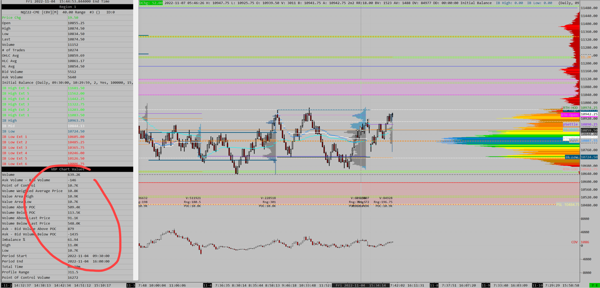

In my chart I cannot see the full number both on the value displayed on the chart and on the Tool Value Window, despite I set 'Use Large Number Display Formatting' to NO. The issue is only with the VbP study (see attachment). How can I fix it?

The numbers in the Tool Values Window are set the way they are. There is not a way to change how they are displayed.
But the numbers in the chart itself that are displayed below the profiles should obey the setting to display as Large Volume formatting or not. In fact, what is really strange is that you have some numbers showing with the large number formatting and some without.

The reason why you have both full numbers and shortened numbers (with the suffix) when the Input for Use Large Number Display Formatting is set to No is because you are displaying the Point of Control value, not the volume at the Point of Control. Therefore it is displaying the price of the Point of Control and in this particular case, you have the Value Format for the study set to Large Integer with Suffix.
If you set the Value Format for the study to Inherited then the POC will show as a full number and not shortened. Refer to the following for this particular setting:
