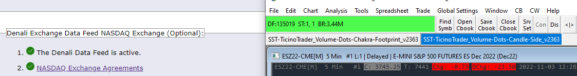

Am unsure why all things green yet delayed

You are not connected to an external service, so you are not getting data from them.
Also, you are not setup to get real-time data from our Denali data feed. You show an image showing the first two steps complete for the NASDAQ TotalView data, but the third item - activating the exchange - also needs to be completed.
In addition, you show a chart for the ES, which would require that you activate the CME Group data. But keep in mind that in order to get real-time data for the CME Group at the non-professional rate, you need to have a live, funded, futures trading account to which you can connect your Sierra Chart software. Refer to the information here:
Real-Time Exchange Data Feeds Available From Sierra Chart: Understanding and Accessing Data From the CME, CBOT, NYMEX, COMEX Exchanges
What are the exchanges for which you want real-time data?
Do you have a futures trading account and if so, through what broker?
