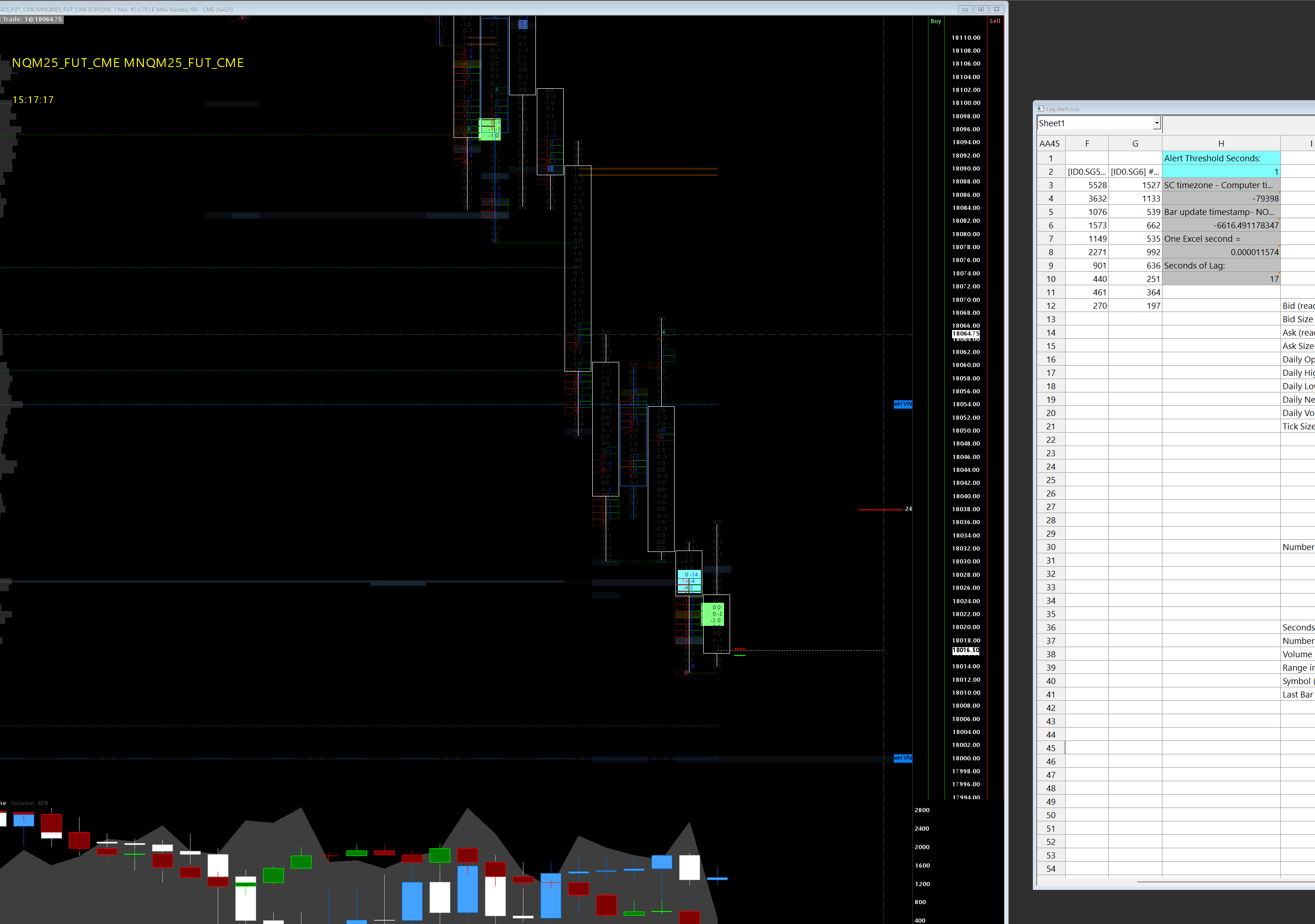

User01337 - Posts: 51
Should it work with number bars? The "Seconds of lag" value increases until candle close. So with 1min interval it goes all the way to 60sec until it restarts from 0. Also I don't get any alerts.
Date Time Of Last Edit: 2025-04-08 15:18:56

[2025-04-08 22:18:15]
Sawtooth - Posts: 4362
It should, because it compares NOW() to the 'Last Bar End DateTime' (J41), which has no correlation to bar period.
It works for me.
The Data Delay in the chart header shows the exact same lag as the spreadsheet study in post #12.
The advantage with the spreadsheet study is you can set an alert threshold, and you could display the lag in seconds larger, using the Text Display for Study study.
The spreadsheet study could also color the chart background when the lag exceeds the threshold, making the alert very visible.
[2025-04-09 13:56:03]
The comparison of NOW() and J41 now supports milliseconds, in v2, available here:
https://www.sawtoothtrade.com/free-stuff-2.html
You applied it to Chart #2, but you are using spreadsheet Sheet1.
When applying it to a chart other than Chart #1, follow the updated instructions on the website.
Date Time Of Last Edit: 2025-04-16 00:45:51
